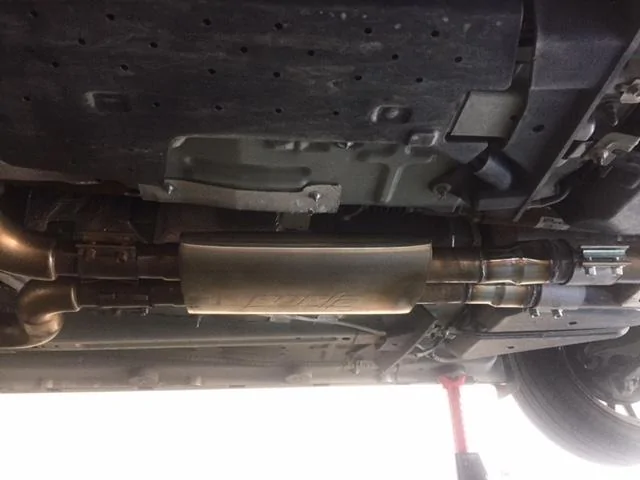

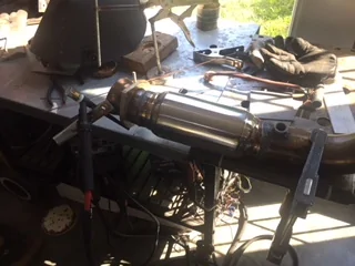

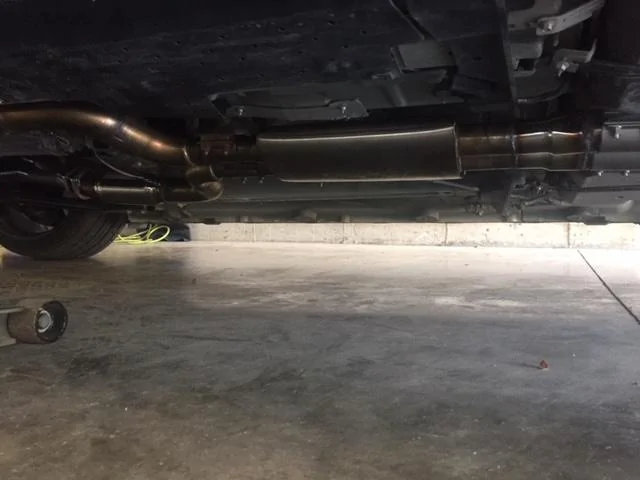

Here are a couple pics of how I cut out the Kooks green cats and welded in the 12” resonators and then the Borla tour resonator that made my catless Kooks setup perfect.

Very nice, thanks for sharing.
Do the headers step down to 2.5" or 2.25"? And on the rear did you step it back up to 3"?

Shawn
OW GTPP Whipple
Yeah it's something I don't like about my setup but it sounds soo good, not to loud at all. The Kooks mid pipe is 3" steps down to 2 1/4" to marry with stock exhaust setups, I do think they have a full 3" version though. On mine it steps down to 2 1/4 into the Borla inlet, but the Borla outlets is 2.5" then I had to use adapter that I welded in to expand back to my 3" exhaust pipes. Boral does not make a 3" resonator only 2 1/4 in to 2.5" out and a 2.5" in and out.
