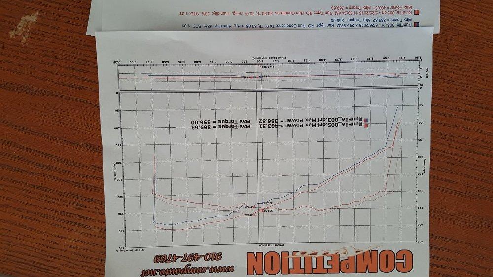

To the OP
Here's my graph on a bone stock GT with just a tune for 93

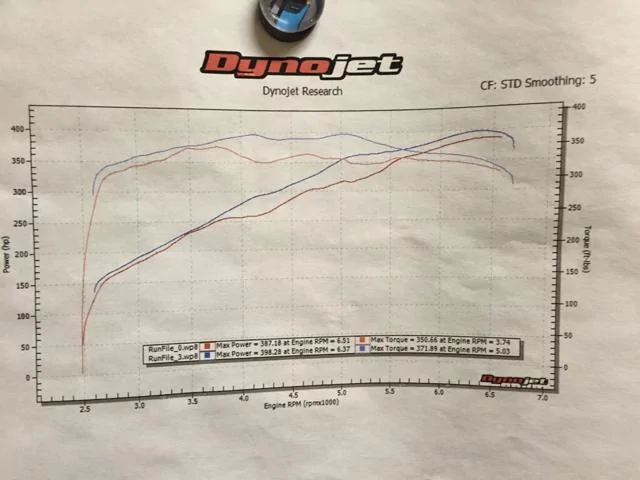

Here's mine.
LET 93 Performance dyno tune.

I should add:
GT PP
Catback only
4th gear pulls

What type of dyno are those graphs from, guys? The stock numbers seem a tad low? I know on a mustang dyno i made 372/370. Dynojet (obviously) will be higher.
pinero61
Dec 3, 2014
2,166
412
Houma, La
'15 Ruby Red Base GT PP
I ran on a Dyno jet.

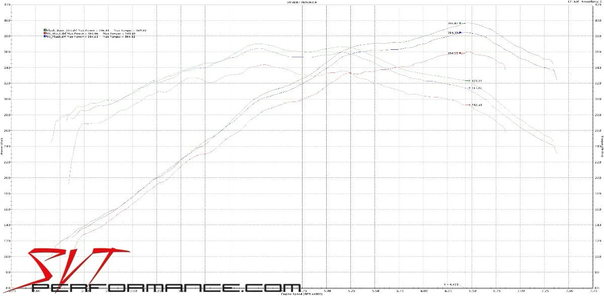

Figured I'd throw a reply in here will all of the dyno testing we have done along with other independent sources. Intakes DO make power, at least ours do!
Bama's test tune only and then adding JLT.
Thread:
http://mustang6g.com/forums/showthread.php?t=11053&highlight=jlt+dyno
Board member Anthony's results, which he had graphs but deleted them all when he got banned :(
http://www.mustang6g.com/forums/showpost.php?p=385153&postcount=171
Our very own 2015 GT, we base lined our car on a dyno dynamics and dyno jet, it made 381-384whp on both.
Another local customer's 2015 GT that allowed us to test on the dyno, this car had 250 miles on it at testing! Intake and tune
SVT Performance's testing, JLT picked up 11whp peak over tune only.
See attachement
So as you can see the lowest test shows 9whp, with typical results 12-15whp over the stock box. $29/hp @ 12whp. Hard to find a bigger bang for the buck with more independent testing

Thanks for the input Vinny, good to see some dyno charts.
Siggy550
May 23, 2014
476
119
Midwest
2020 GT PP2
Thanks for the charts Vinny! This resonates with what Bama said in their videos. Very little difference in CAI and stock airbox until higher RPMs. CAI starts to separate itself above 5K.
