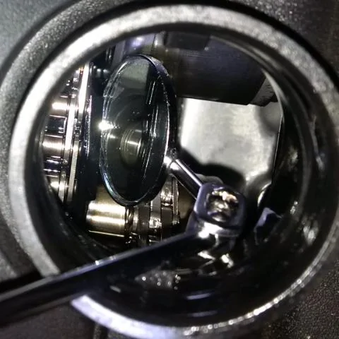

Does anyone see a grove?
Tough to see from your picture but it should look like two cylinders when activated with a groove for the second one. I would get someone to 100% verify. Can you get another picture with the mirror back a little so we can see the tensioner a little better?

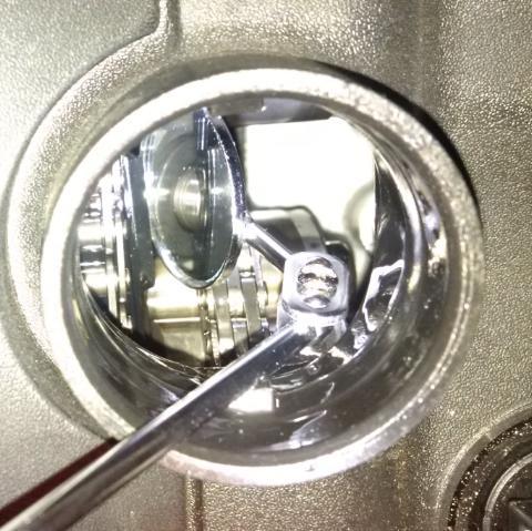

Well, mine for sure looks likes it's not activated but no recall or FSA listed on owner tools.....WTF.
Hello; The way it looks to me is there will be two metal cylinders when the part is activated. A smaller one inside the larger one, with the smaller one sticking out. I think the "grove" is not a machined notch or such, but where the smaller cylinder sticks out of the larger.

I just went and checked mine again, it does appear that there is an inner cylinder which when activated results in the "groove." Mine looked identical to the Ford picture, I would say if you do not see that second cylinder, have it checked out as it may not be activated.
If you look over the service bulletin on the first page (second document) you can see that the unactivated is only a base with a single cylinder, when activated, the second cylinder pushes the tensioner upwards and causes the groove. Unfortunately, I checked mine with the fill tube in place, so I am not able to get a picture.

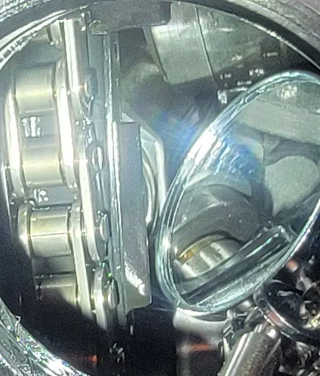

Maybe just barely activated? Hell if I can tell but there is ZERO give on the chain itself.

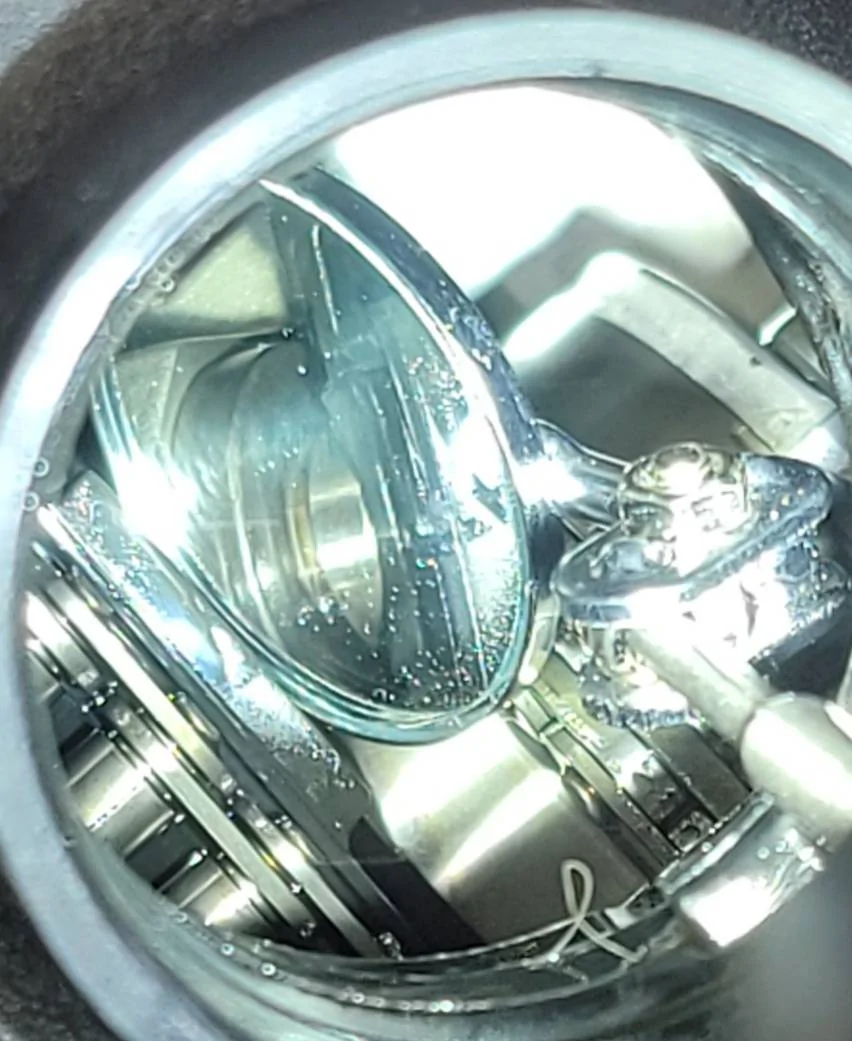

Mine is sort like this only the channel or grove is a lot lower.
No telling brother. I do keep mine above 4k once warm and have kept her above 5.5k for 30 -40 minutes at a time on some 'nice' places to do so. I wish they would have given a GO - NO GO measurement.
