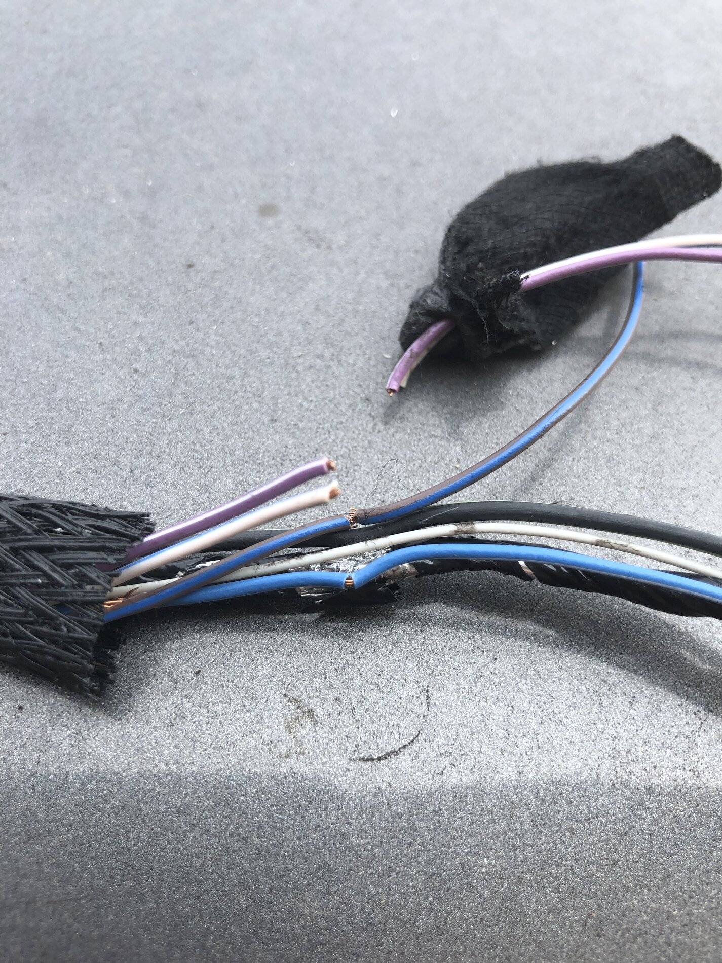

I was able to get it to flicker a bit by playing with the harness near that zip-tie rivet.
Seems like that bend is starting to give out. (bad design--concentrated stress point in the harness)
There is no chaffing or outward damage. I haven't undone the harness yet because I didn't have the supplies (heat shrink) to rebuild it.

Changed the harness out. Found a couple of the wires were completely severed, and others were hanging on by a strand. Of course, now my reverse camera isn't working... Hopefully it's just because I didn't connect the shielding. I'm going to try a jumper connection around the Deutsch connector I added.
