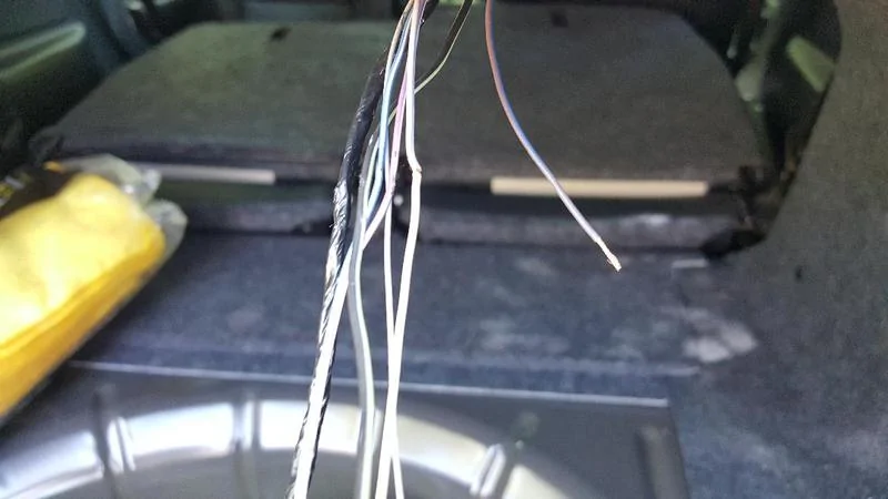

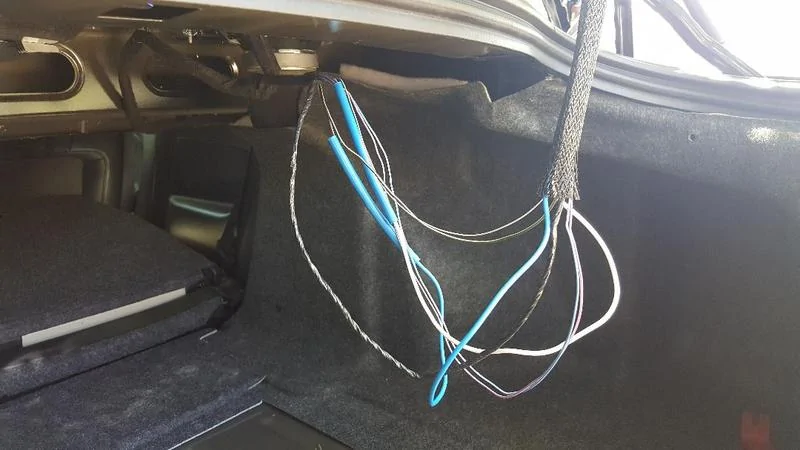

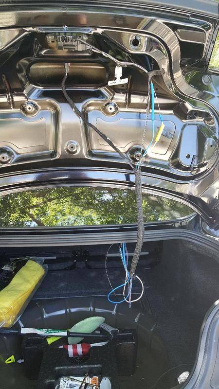

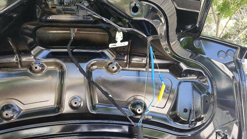

Hey bro.. was able to locate the problem and fix it. Like NightmareMoon stated it is in the wire harness. I did not find any fried wires. Mine where severed and cut. My problem was located about 3 to 8 inches as the wire harness loops up the truck. If you are working your way down the wire harness from the latch on the trunk. It will be right after the part that has that protective plastic mesh. I spliced in thicker wires and now it works like new. Give this a try. Should take care of the problem and you wont need any more fishing line lol :) Good luck bro.

Glad you were able to fix it AND your pics will give a visual reference to future owners who WILL have the same issue. It’s a problem in all 2015-2017’s and usually will reveal itself to those who use their trunk lids more often than those who don’t...
