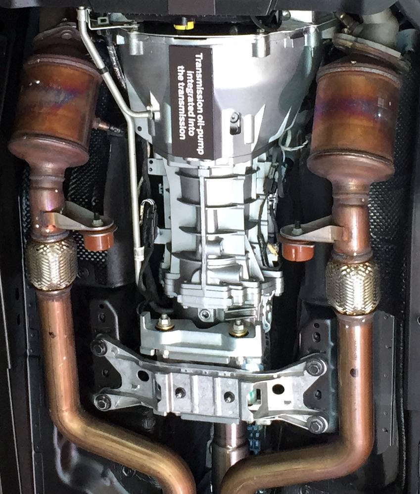

Are you referring to the pair of dampers that are mounted to the X-pipe assembly, just aft of the converters?
And are you talking about the headers that Ford was using during development?
Come on...you know those answers. ;)

I have ARH long tubes made from 304 .064 tube, purge welded and I don't have the vibration dampers or flex pipe. It doesn't vibrate.

Just because you can't feel it doesn't mean it isn't taking place.

Yeah well. Some people worry about to much. Does a stone in your tires tread cause a off balanced tire? Sure does. Does it ruin the wheel bearing? Nope.
Those dampers are there along with most of the other dampers because people in today's time want smooth and soft ride vehicles. Those exhaust dampers are not going to stop crank shaft vibrations, they only help with the exhaust pulse. They are also not going to stop the car from coming apart. If your worried about vibrations throw away for stock harmonic balancer and buy a ati or Romac balancer, that stock balancer isn't the best one out there. Don't believe me? Take your engine apart and see for yourself how crappy stock balancers are when you see your bearings. The late model mustang has no mid exhaust pipe hangers. All the weight of the exhaust is supported by the header bolts, and the axle back/mufflers. Your theory is also saying a 2 piece driveshaft is better then a 1 piece. It's not. If the long tube header was made of thin gauge tube with a flex pipe joint I believe it will crack the weld over time due to the movement and bouncing of the weight of the exhaust. ARH long tube gt350 headers are made of .065 304 stainless steel tube that's purge welded. A thicker tube will help absorb vibrations and can support the heat cycle better. The only 2 reasons why ford didn't install long tube headers is.
1) EPA
2) Cost

Holy excessive assumption Batman!
Staying on topic, all I can say is that I was passed on a warning from those involved in the program, to not toss the exhaust dampers. A well engineered header for this application should entail similar design consideration.
