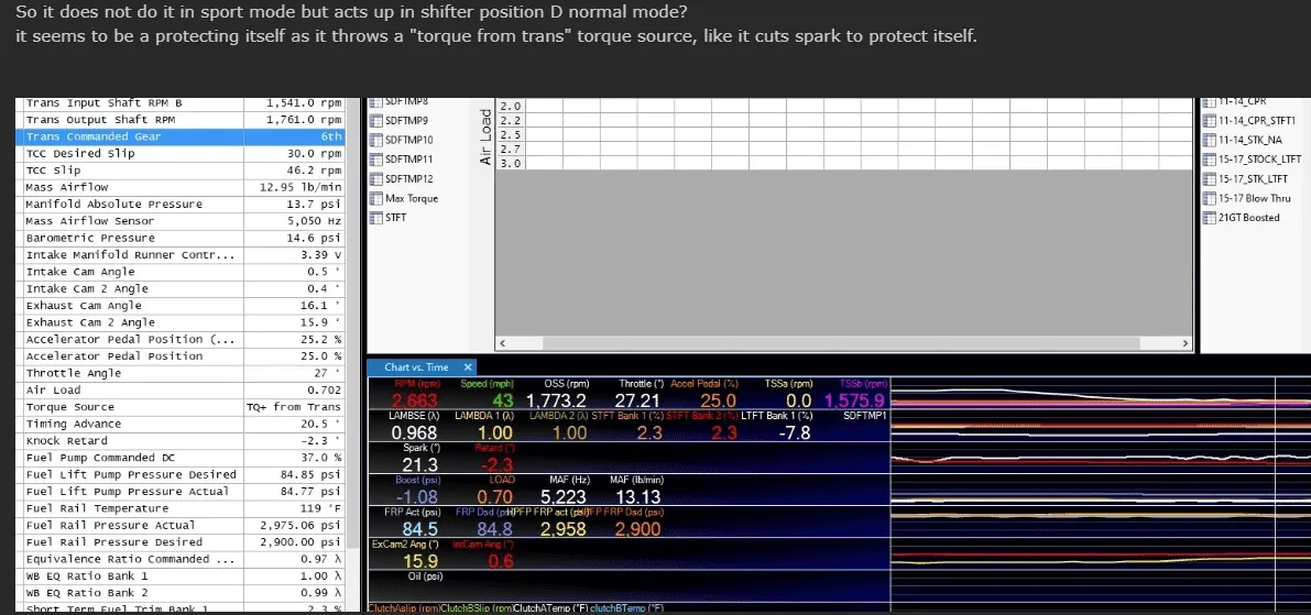

In normal mode (not S or S+), shifting into 7th gear between the RPM ranges 2K-3K causes a slight vibration. This vibration feels like its at the back of the car, more specifically the passengers rear tire? Keep in mind, this does NOT occur in the RPM ranges of 1-2K, nor does it occur in S+ mode or manual mode. I logged this and sent it to my tuner (Lund) to see if they had any ideas. Here is what they saw, along with their response (on top of picture).

Lund, they should figure out which protection is tripping and tune it out.
Did they send you a log file to log trans PID's?

Lund wasnt very helpful tbh. I will ask for them to log the trans PID's.

This is normal for them
Good luck.
The log posted shows TQ+ from transmission
It's most likely a trans torque limit that needs adjusting
Alright, so i drove around, wasted all the E85 and retuned it with Lunds tune for 93. Issue still persists. I have an appointment with Ford on Monday morning. Do you think i should go this route or wait and see if Lund can do anything on their end?
