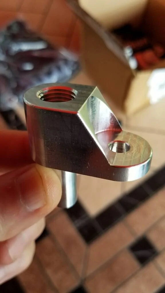

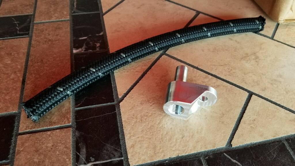

The LMT hardware has nothing to do with the seal at the rear of the transmission. Rather, it is for addressing leakage where the lines enter the case. I have the kit and it is very high quality.
I agree, the kit I got is very high quality. If I ever need it, I will join you in what we talked about though, and flare the line.
What is this piece of which you speak? I can’t find anything on their website like that.
Does it brace those tube fittings where they enter the trans? I’m about to change the side filter again and that would be the time to install such a part. Thanks.
From Late Model Throttle

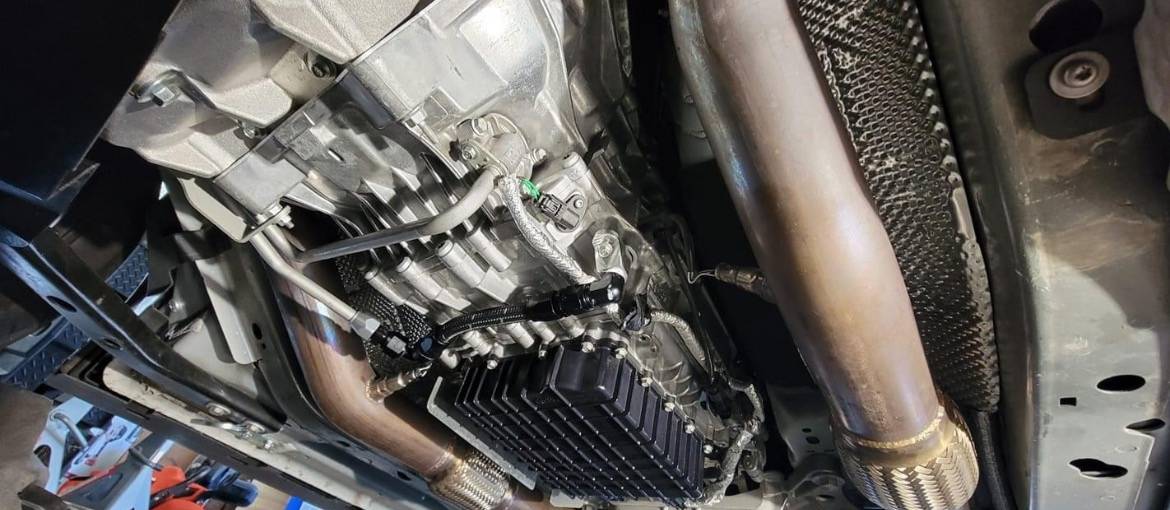

Note that your leak is on a different line than the one in the previous photo with Jeff's kit in place. Jeff had asked me if I wanted a kit for each line and I said no, that I'd start with one and see what happens. A bit disconcerting seeing it happen with both lines.
Good luck with the repair Skwibbs.

If you're willing, I'll gladly pay the postage and a few bucks for the section you cut off. I'd like to see if the OEM tubing used can be flared to fit an appropriately sized AN fitting. Jeff's kit, while excellent, uses a compression fitting. I'd prefer to flare the line instead.
