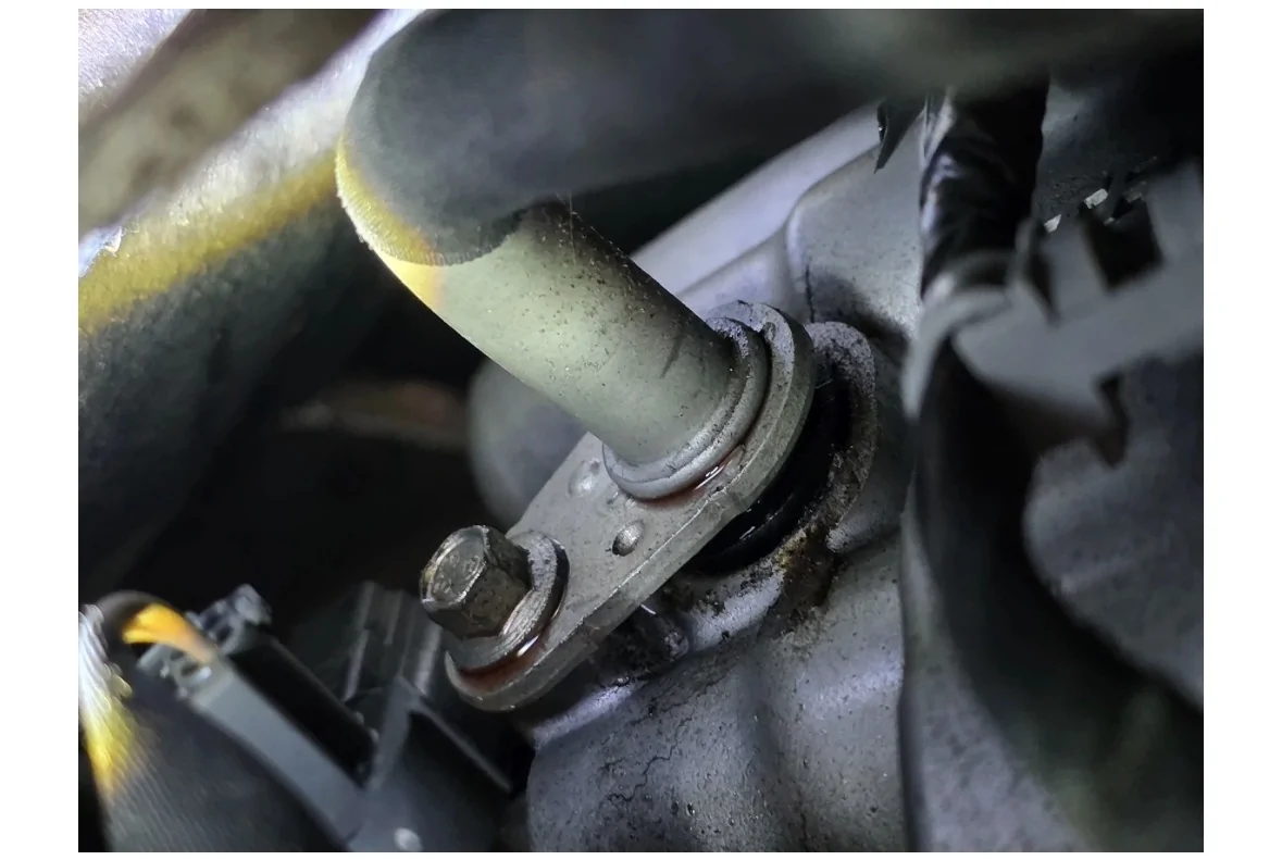

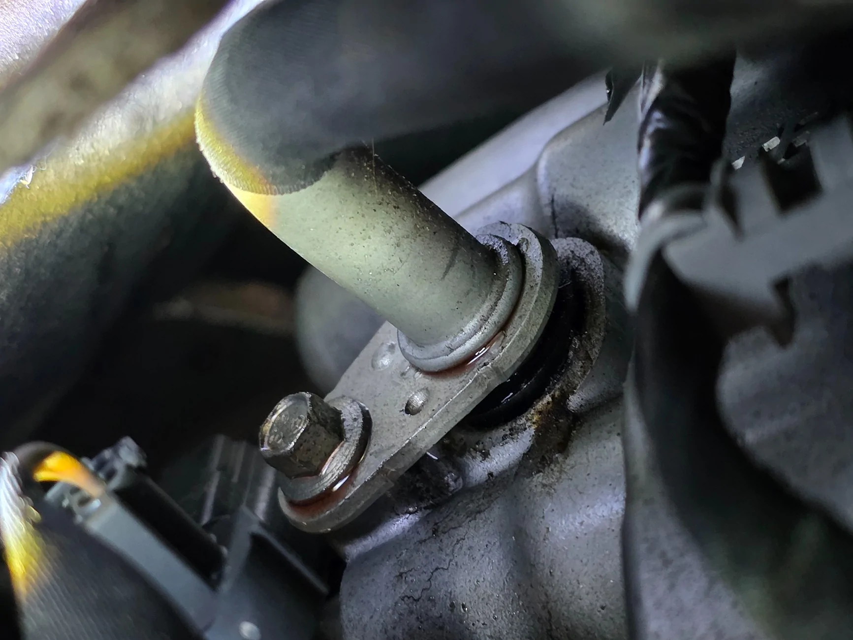

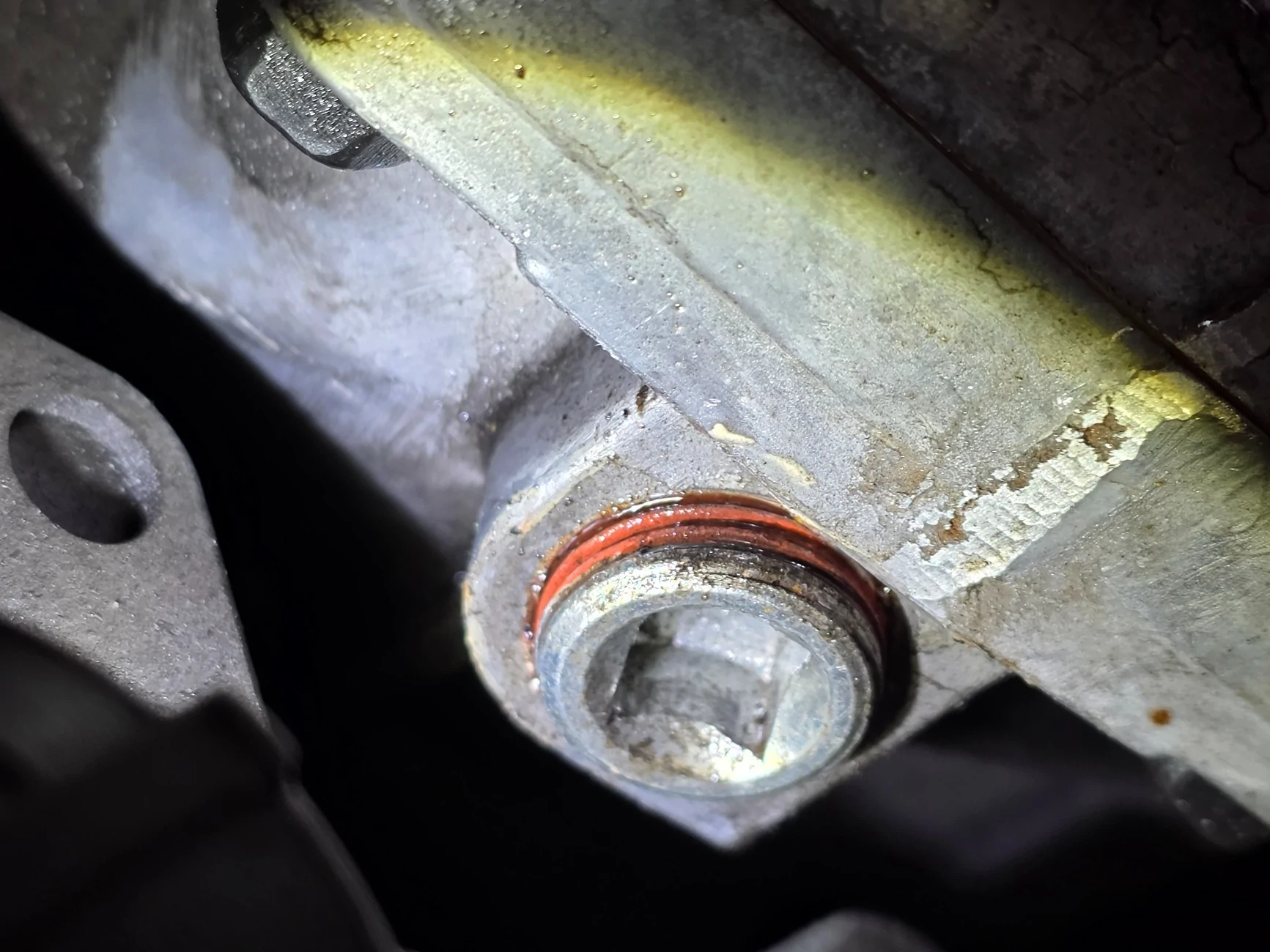

I noticed some drips on my garage floor. Had a quick peek and it looks like I have transmission fluid leaking from somewhere (based on the red fluid on the bolts). Anyone have a similar issue before?

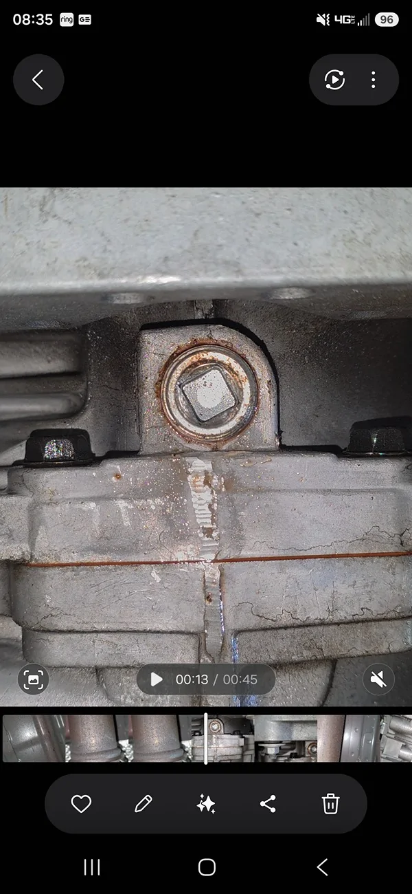

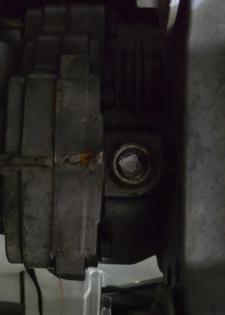

Another picture. Maybe it's leaking from that plug?

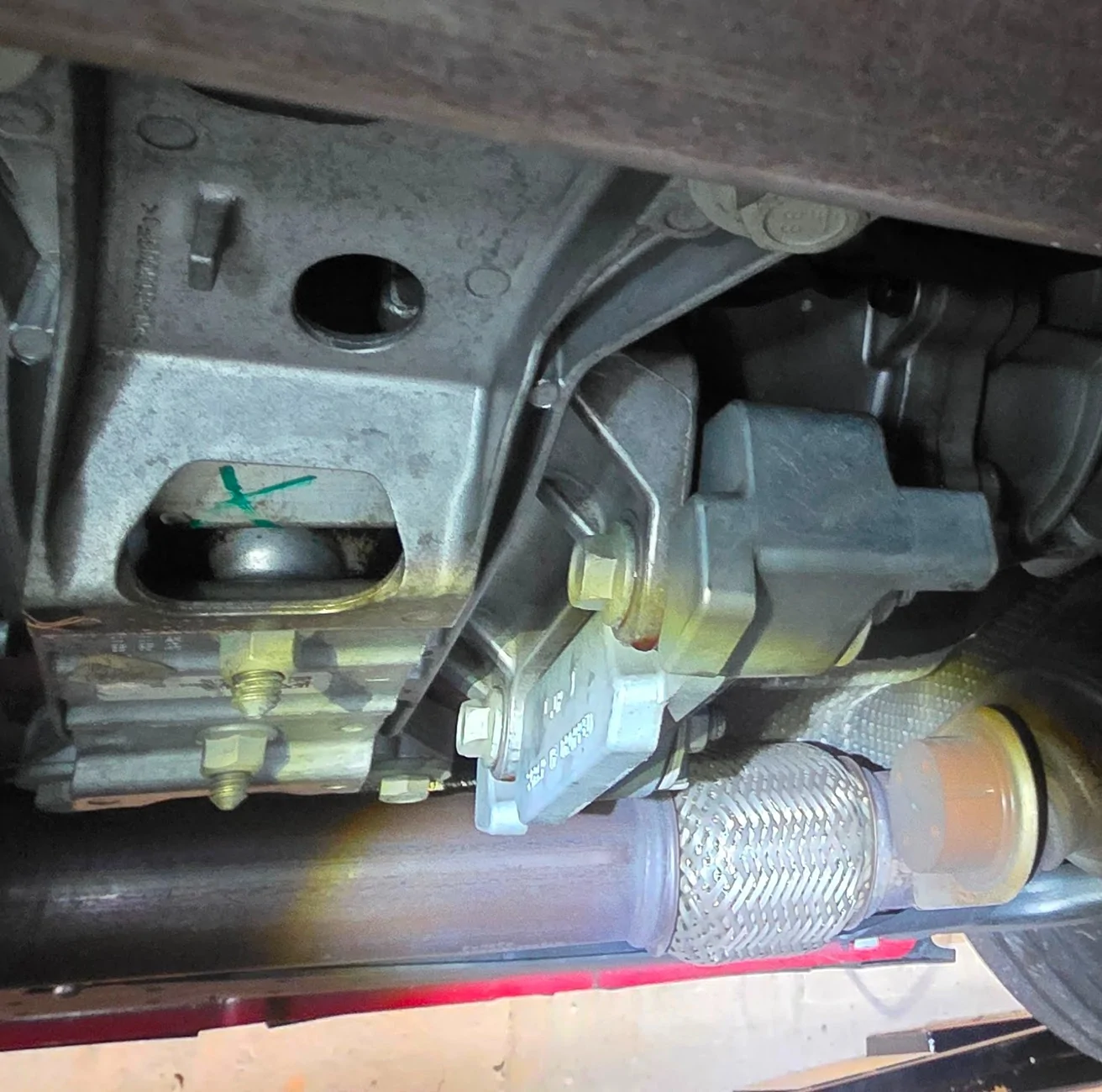

Here is a better image

Okay so it's either the drain plug or the cooler line fitting

That's definitely annoying to find on your garage floor. Definitely get it up on that lift and check the cooler lines and the shifter seal—those are pretty notorious for weeping on these cars even when they aren't being pushed hard. If it's not coming from the breather vent like some guys mentioned, it's worth cleaning everything off with some brake cleaner first so you can actually trace where the fresh fluid is tracking from after a quick drive. Good luck, hope it’s just a loose fitting or something simple.

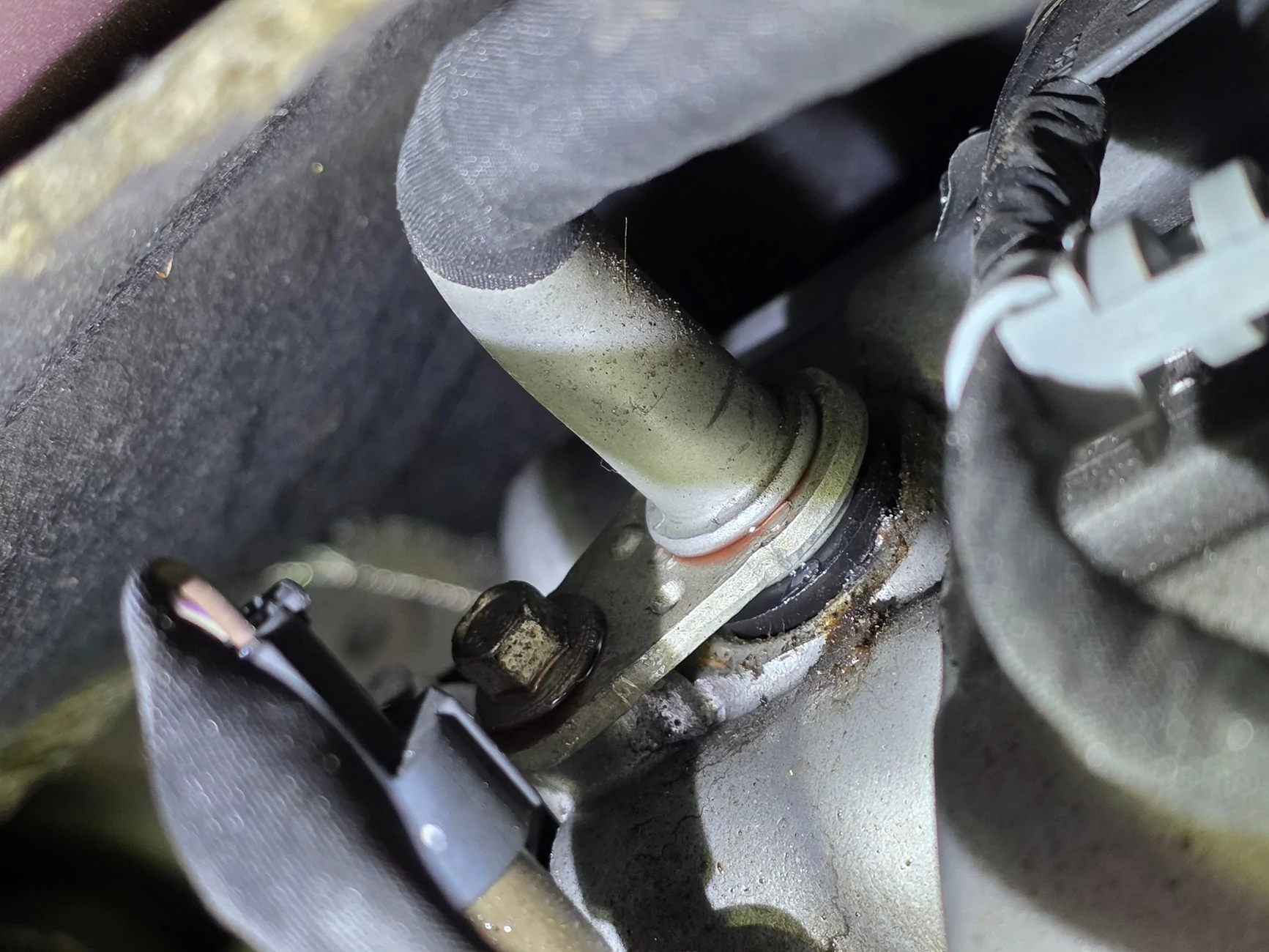

Thanks! I went underneath the car earlier and it looks like the rear-most transmission cooler line fitting is leaking. See the pictures above. My AC has been dead for a year now so I think I am finally going to have to take this thing to the dealership and make use of my PremiumCare ESP.
yes, this… have you done anything to the tranny in regards to draining/filling/servicing?
The Ford tech manual references; the seal and the keeper inside the tranny cooler lines is the only reason I’m asking šŸ˜‰

I did change the tranny fluid about 10k miles ago. And it hasn't been leaking for that whole time. So I'm leaning toward the transmission cooler fitting. Plus that sits higher anyway and the area up top has tranny fluid residue.

Interesting development so far. The cracked high pressure AC hose was covered by PremiumCare without issue. The tech is going to replace it, fill the system, and then run the AC to evaluate my compressor whine. That will probably need to be replaced too. But, PremiumCare is pushing back on covering the transmission leak. My ESP contract states that transmission seals are covered. But it also says that transmission coolers are not covered. The tech specifically ordered the seal that plugs the hole in the transmission where the cooler line attaches. So I guess this is a bit of a grey area. My service advisor is going to try to get them to cover it. Let's see what happens.

It appears the black o-ring on the trans cooler line is not fully seated. That fastener needs to be loosen and the o-ring reseated. It may have a bent cooler line bracket and that is why the o-ring is exposed. That is what I see in your photos.
Edit: never mind I immediately went to a reply instead of reading the entire thread. Sounds like it’s already being looked at. Good luck.
