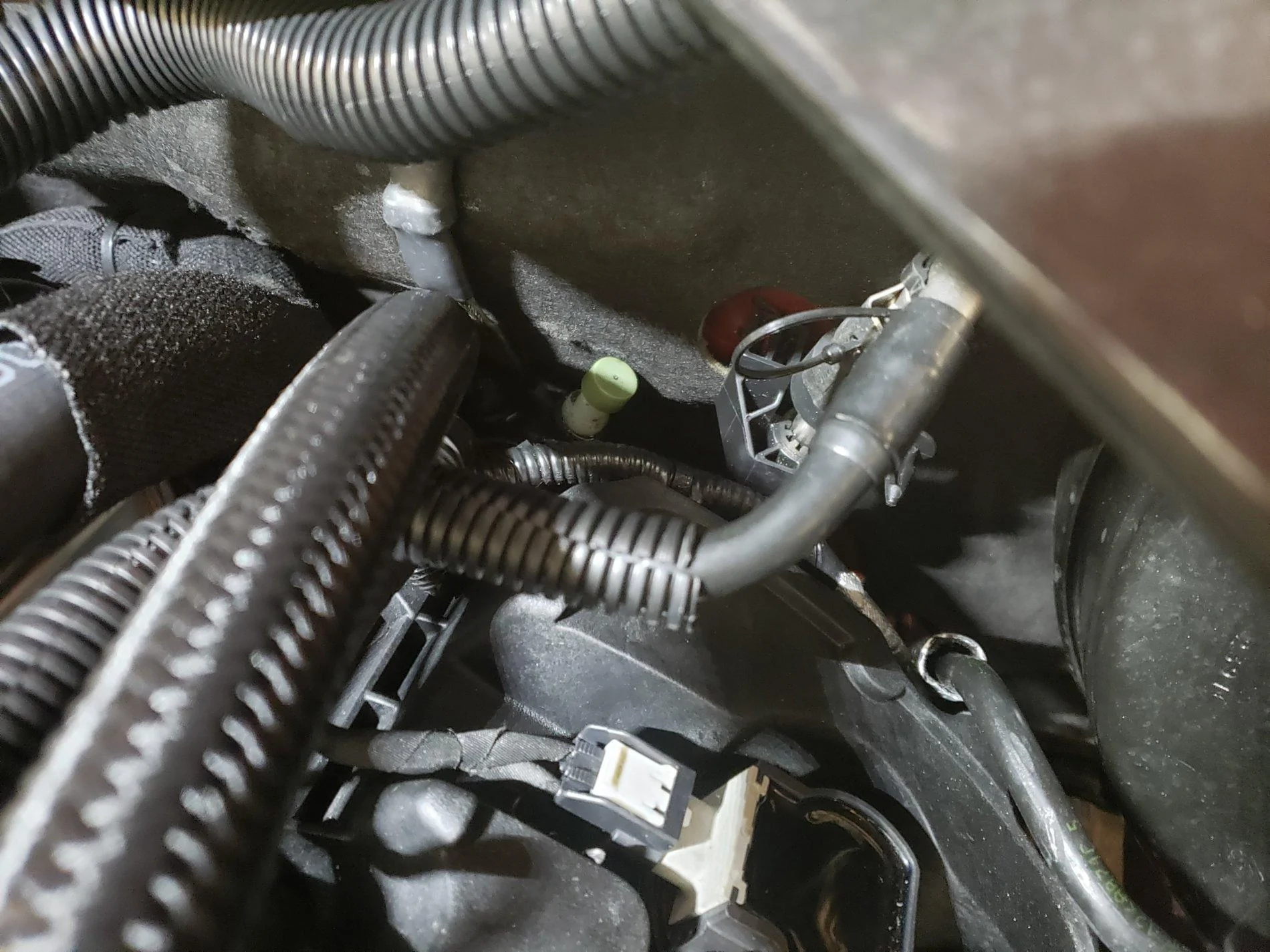

Where is the transmission vent on the GT350?

Hmm that is almost the exact place I see fluid....... Thanks I was about to PM you.
Can it be overfilled?
Could be, but I'd be surprised. I fill mine all the way till it leaks out and I haven't noticed anything successive coming from it.

My issue started with a transmission swap. I saw another post of a guys whose car (GT) leaked from the vent after autocross I am going to see if the cap is missing.

Ok mine breather valve isn't connected to anything there is no hose on the bottom
It's also in a different location than yours.
Hmm assuming the hose is sitting on top of the tranny is there room to reach it?

Ok so I confirmed that was the source of the leak. Unfortunately it cost me like 2K in wasted track days -.-
