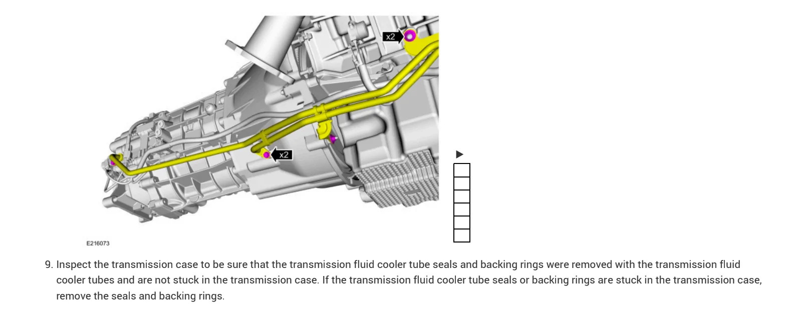

It appears the black o-ring on the trans cooler line is not fully seated. That fastener needs to be loosen and the o-ring reseated. It may have a bent cooler line bracket and that is why the o-ring is exposed. That is what I see in your photos.
well, not really…you are more than likely seeing the backing rings and not the seal 😉
