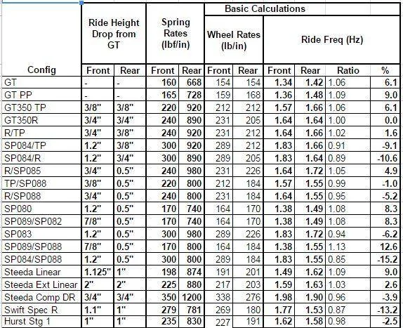

I was doing some thinking last night (dangerous/expensive). I have some vacation days to burn so we're going to drive to another city, go to the track, and take classes. I need a tuned package and was thinking about those GT350 springs. Why not just do GT350 sway bars, springs, and ford performance track strut/shocks? So I cancelled the BMR sway bar order. Also would be cheaper to send used springs and sway bars through customs here. My forward shipper can put a much lower price and it will cruise through customs without red flag. GT350 springs look like 3/8" drop and I don't imagine that being a problem. Even if it is, there's spacers available to get it back up.
Now to find those part numbers..
Spring rates courtesy of someone else on the forum.

So I ordered a bunch of stuff because I want to do my first track day in Bogota, Colombia.. The final build is:
GT350 front springs 194lbs with FRPP Struts
PP Rear Springs 728lbs with Bilstein B6 Shocks
GT350 36mm Front Sway Bar
BMR Adjustable Rear Sway Bar
BMR CB005 Lockout
BMR Rear LCA Bearing
FP Tow Link Bearings
FP Tow Link
FP Front Control Arms
FP Strut Tower Brace
Falken FK520L 255/40r19 Tires
I'm shooting for a budget 200/800 spring set up for street/track without lowering. I read the FRPP struts have GT350 valving so I will pair them with 194lb GT350 springs. I couldn't find any rear spring that was 800lb that didn't lower the car significantly. So I compromised with PP springs. I think the FRPP shocks are overdamped for a 728lb spring so I went with the BIlstein B6 in the rear.
