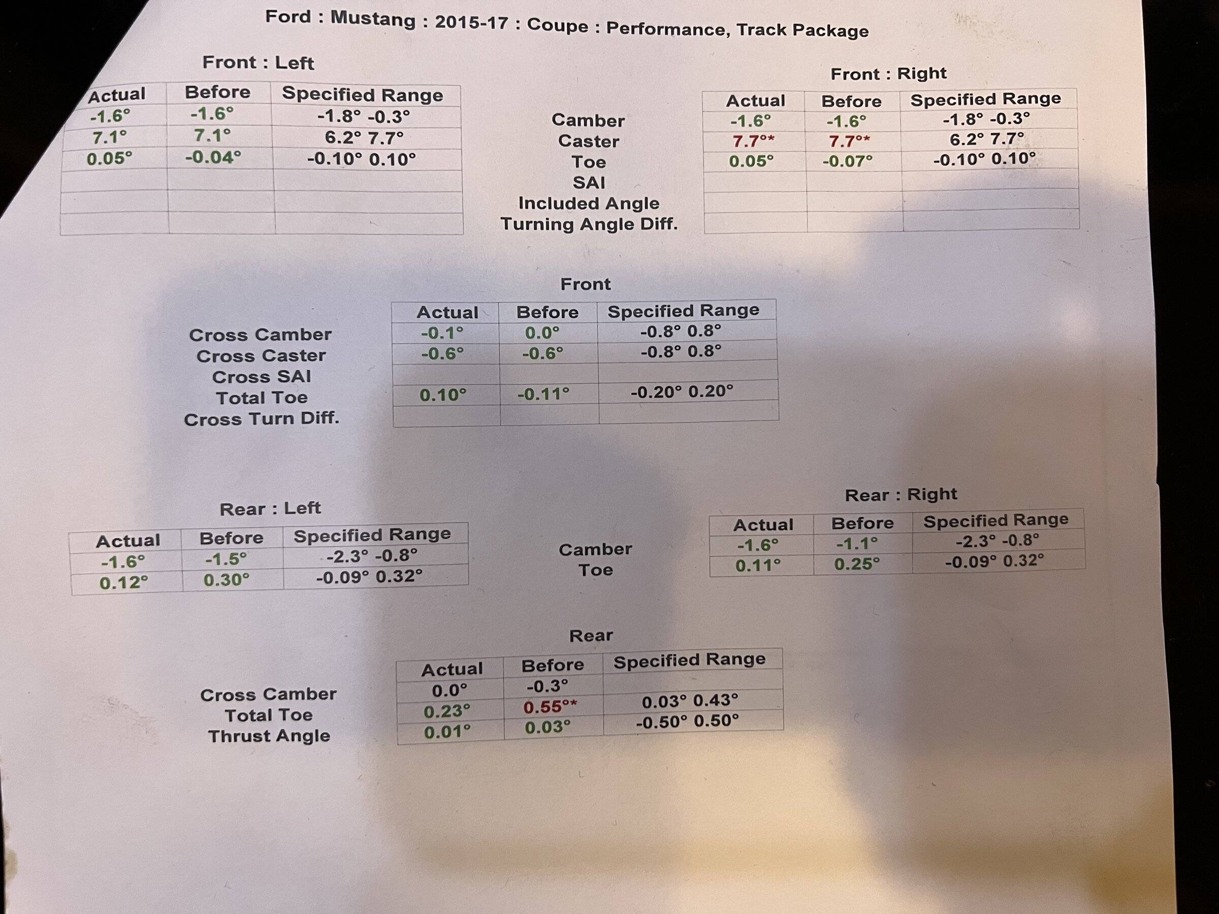

*** Resolved, updated with alignment print off below***
I searched around on here for a bit and couldn't find anything that matched my situation. Just got my 2016 PP a couple weeks ago and it seems this car tramlines pretty bad. This is my third Mustang, first in four years and I can't remember either of my others driving like this. This car has 52k miles and has stock suspension and wheels. Tires are Michelin Pilot Sport A/S 3+ set at 32psi cold. Tire tread remaining is about 4/32-5/32 rear and about 6/32-7/32 front. The tires seem to be wearing normally as well, so I was wondering if this is normal for a PP car or if I need to go get the alignment checked.

Bald tires make it worse, but yeah get the alignment checked, thats the first step. Toe out will do that.

Finally got her in to a local shop today. Toe was way off. The car drives substantially better now.
