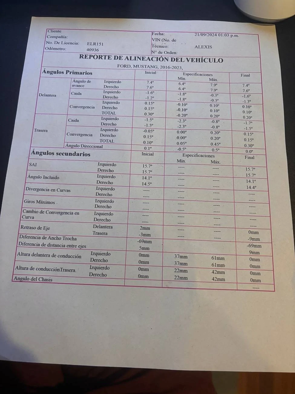

I have attached the alignment specs, they had only changed the tow ("convergencia" in the report)

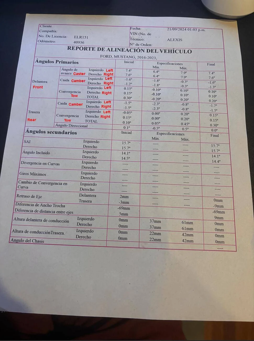

Translation to english

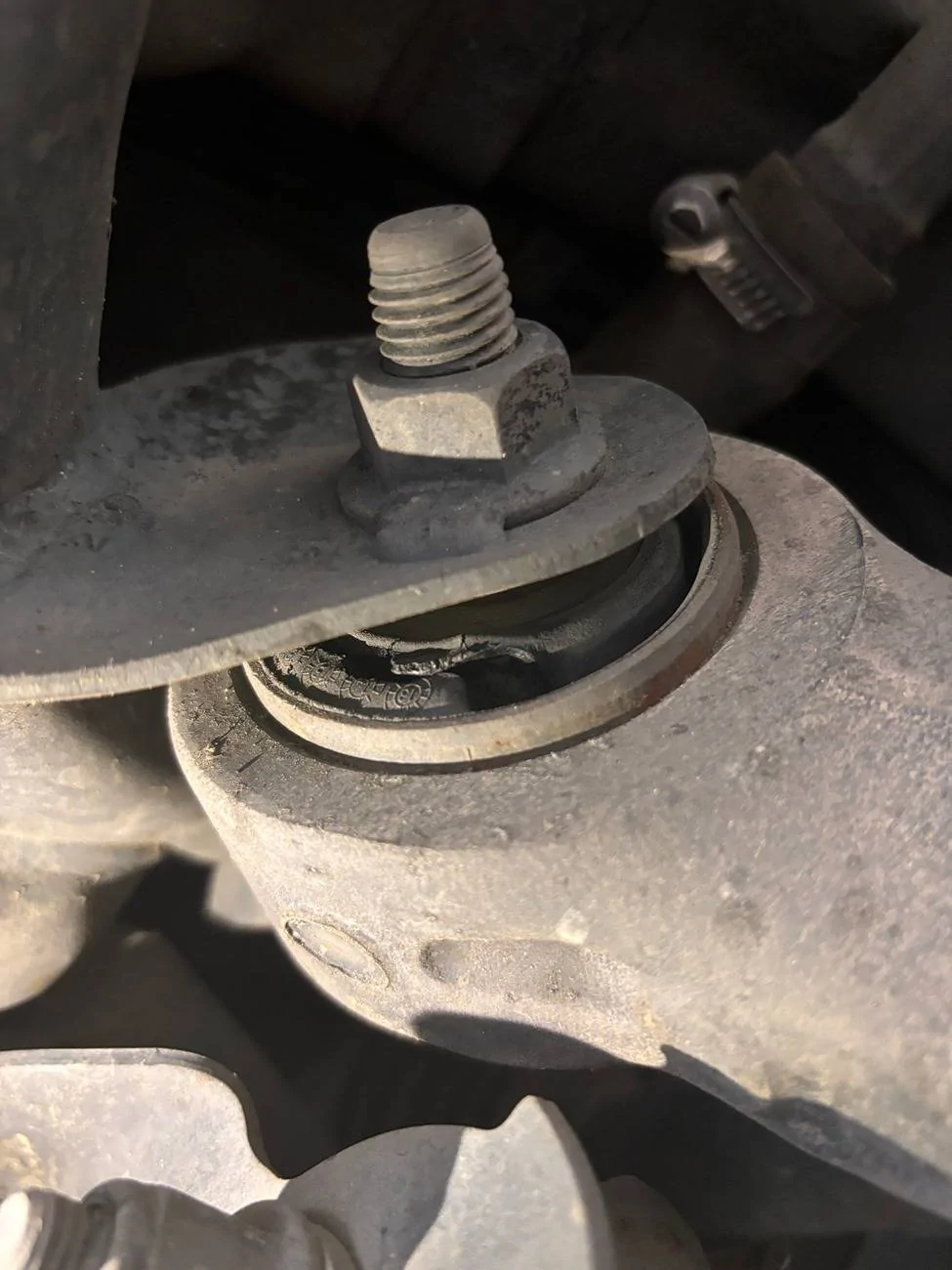

Yeah the bushing is torn up in the control arms. I took another look and saw the bushing in the knuckle for the tow link was torn too. Luckily I had already ordered them. Hopefully I'll have them installed in the next few weeks and I'll do an alignment. See how that changes. Then I'll put matching tires up front.
Picture of the control arm bushing. Both look like this.

Good you found that. At the least your car will handle better and more tight with those bearings. I've got them on my car. Let me know how you get on. That's a good call on matching tires imo. For a car like this, you want it to handle right. Having matching tires on all 4 will help that a lot. And it's a lot safer too because you will have the same grip levels and handling behavior on all 4 corners.

For alignment, try 2.2-2.8 front camber, 1.8 rear camber
Front toe 0 or +0.5 toe in. No more than that. Your 0.1 front toe will chew tires up a little too fast.
Rear toe, 0.1-0.15 toe in per side.
More front camber helps the front grip in corners, less is a little more mild for street use. If you dont like a car which can oversteer sometimes, then go 2.25. If you want a car that really carves corners, go with up to 3.0 front. You can go higher than 3 but probably overkill for a street car.
