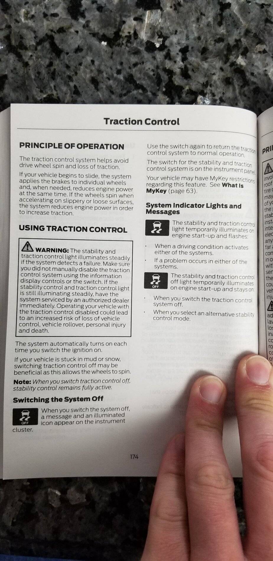

In fairness to monte87, the 2021 Owner Manual makes absolutely minimal mention as to where the TC/ESC switch is located. Just an easy-to-overlook one-sentence mention on page 174 (top of the right column), with no picture. Took me more than one read to spot it.
"The switch for the stability and traction control system is on the instrument panel."

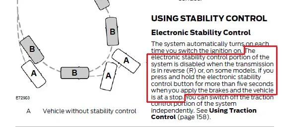

When did they change that? On my 15 I can fully turn it off with a long hold of the switch whenever I want. Stopped / moving / foot on brake / foot off brake. It doesn't matter I can do it whenever.
I don't know when then changed it, but this is what the 2020 manual says:
My 2018 manual says the same thing. I definitely get the message even with the car moving but now I wonder if the message is accurate. I typically only use it at the drag strip when I am stopped in the staging lanes with the brake on, anyway.

There manual sucks, it's all circle jerk w vague directions and still doesnt tell you how to shut full traction control off.. it only shuts partial traction control off, not fully.
