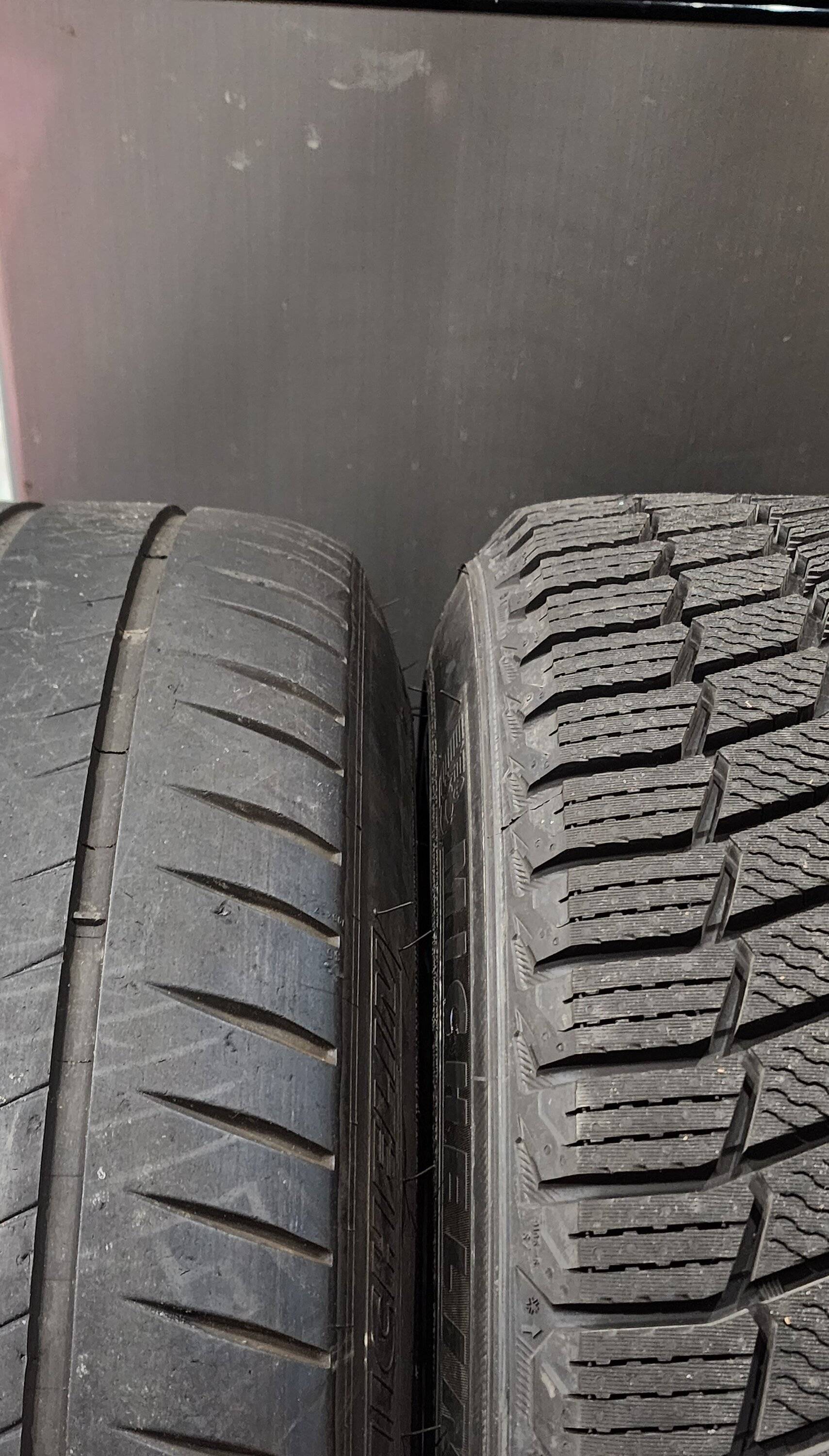

Experienced this very thing today. First time ride after installing winter tires and SVE 350r wheels. Could it be the different tire/wheel dynamics?

I'm going to put the original set of wheels and tires back on my car and see if that cures it. Something tells me the snow tires I put on aren't balanced properly. I'll repost the results here in a couple days.

I just put a different set of wheels on my car and no more traction control flashing under throttle. The winter tires with their soft and deep treads must reverberate and cause the traction control light to flash, the system to engage, or both. Also of note is the height/diameter of the winter wheels are a bit taller than the SC2s... and it's all mushy tread.
Either way, issue identified. I guess it's just go easy on the revs with the winter set up. Maybe if it gets cold enough, they'll stiffen up and act appropriately.

Do you have different outer diameter tires on the front compared to the back?
