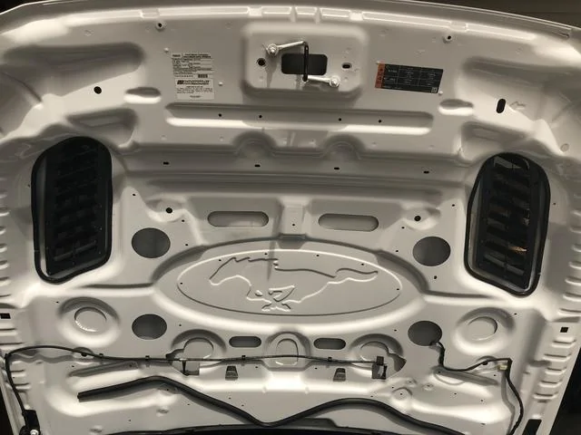

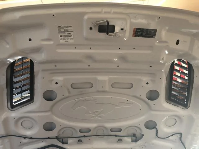

Received mine yesterday, made much better than I expected!:thumbsup:
Has anyone used these on an aftermarket hood yet? While waiting on these to arrive, I ended up working a deal and buying a 3" Trufiber cowl hood locally. It has hood like our OEM hood, and I've been told my stock vents work with this hood. Just wondering if these WILL work, and how they would look with the cowl hood..
Bob
Yeah the quality is really noticeable when you see them in hand.
Do you have a pic of the hood? If you are being told the stock vents fit than these will fit to. I would suspect that some moding will still need to be done but you should be able to dry lay it together. The only problem I can think of is that new hood you bought being most likely fiberglass is a single form that has contours that won’t allow the vent and sub-bracket to sandwich flat together. Let us know what you find out.

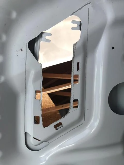

What did you use to put down your cut line? There is no template so my only thought is using the backing to draw your minimum cut line (anything more and you will start to block the vent) and slow cut back from there.
I like to measure twice and cut once. Not sure I want to eyeball this one.
db252
Equinsu Ocha
Jan 1, 2016
44
1,473
890
Bay Area, CA
16 GT Premium/PP/Nav

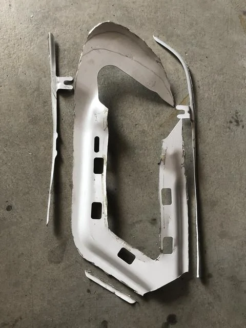

If you look at the 8th pic in the first post I drew up some lines that followed the original factory open cuts. There is no specific size on the bottom section cut other than you need enough clearance for the bottom plate to be able to fit flush against the bottom of the upper hood section. The cut forward was much further than I thought I would have to do but it’s no big dea and not drawn out on that pic but you can see the size of the full bottom cut. The three smaller trip pieces are the upper hood section.

Can anybody who has installed these post some pics of the under hood cutting? I just picked these up and am a little nervous to hack my hood up. OP pictures aren't showing up for me

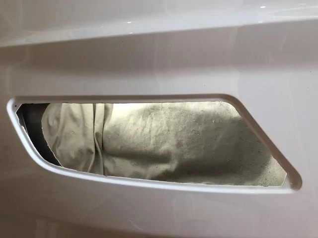

Well hell, I am the OP and I can’t see them. Give me some time and I’ll try to get those reposted. Here are some pics of what you’re asking for in the meantime.
All material removed from left side; right will be no different.
Top view after all cutting.
Before adding trim
After adding trim
PM me if you have any questions.

Hey that definitely helps me out I appreciate it!

No problem. Just go slow and start smaller. You can always remove more.
Here is one of my guideline shots. These follow the natural line and are completely adequate. You will cut further forward (not drawn) than you think because of the rib on the vent. You’ll see.
