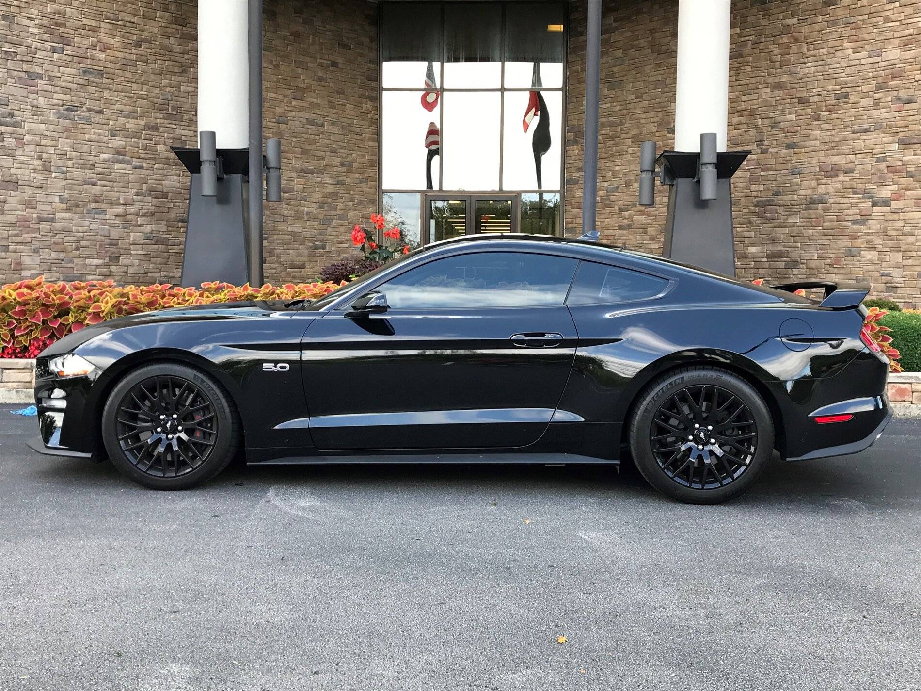

Hey All,
I recently installed the FP Track Handling Pack on my 2020 GT PP1 Manual. I did the install myself, but did take it to a professional shop to have all of the bushings "clocked" and the car aligned. The results were a mixed bag. The front of the car was lowered by 1.5". I was surprised by the drop but I love the results. Unfortunately, the rear was only lowered by 1/2". The car drives great, is quiet, no creaks or sounds from the suspension, but I would really like to see the rear of the vehicle lowered by another 1/2-3/4".
Couple questions:
1. Can I replace just the rear springs? I have lowered many cars but never mixed/matched springs.
2. I believe the FRPP track springs are progressive. Does this mean I can only replace the rear springs with a progressive spring? Is it bad to mix linear and progressive springs?
3. Can anyone recommend a rear progressive spring that will lower the car in the rear a bit more?
Any recommendations are much appreciated. I will try to post some pics later.

Yeah. I took quite a few measurements before and after. The front turned out awesome. I'm now considering a set of Sportlines for the rear. Looks like they might have a slightly more aggressive drop.

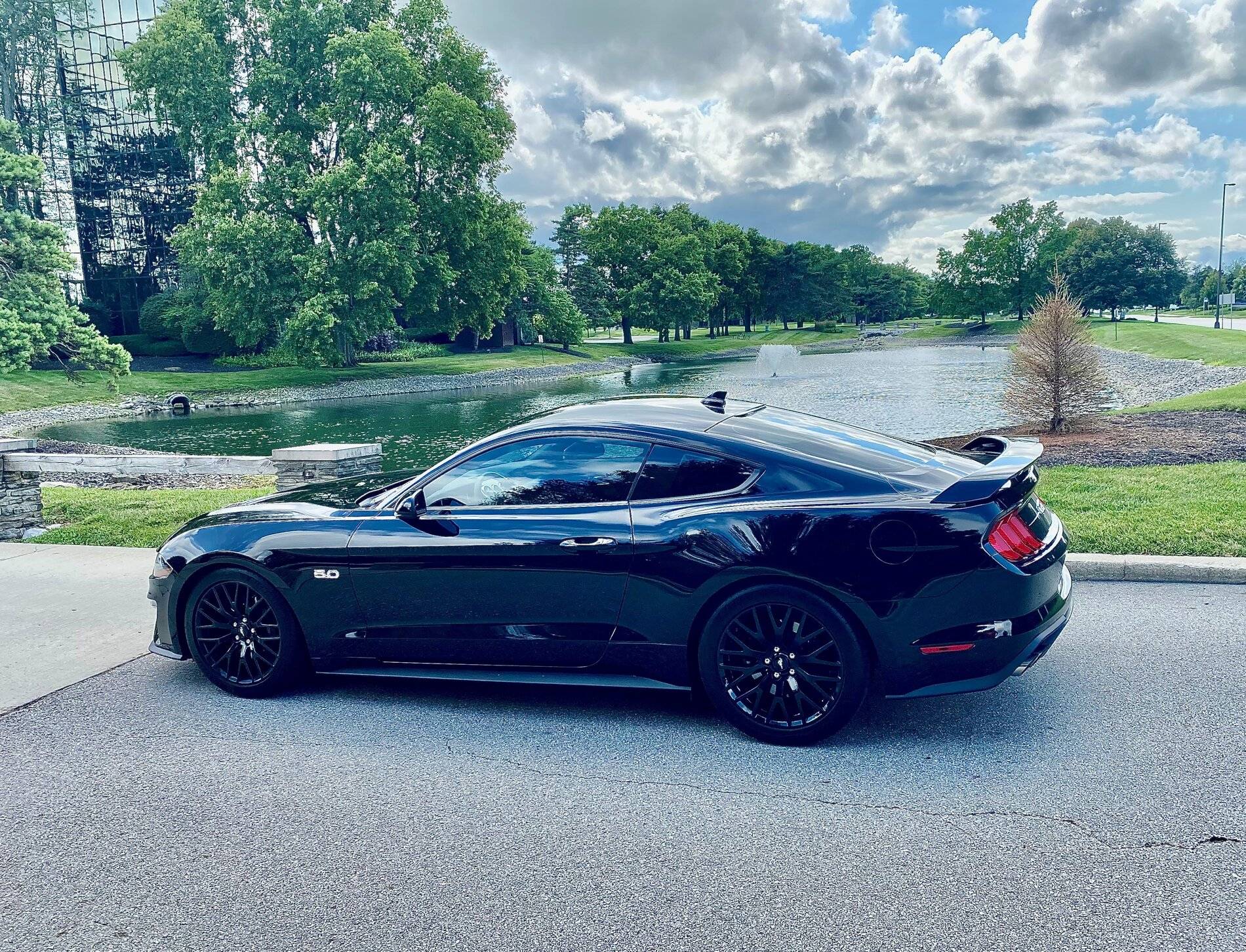

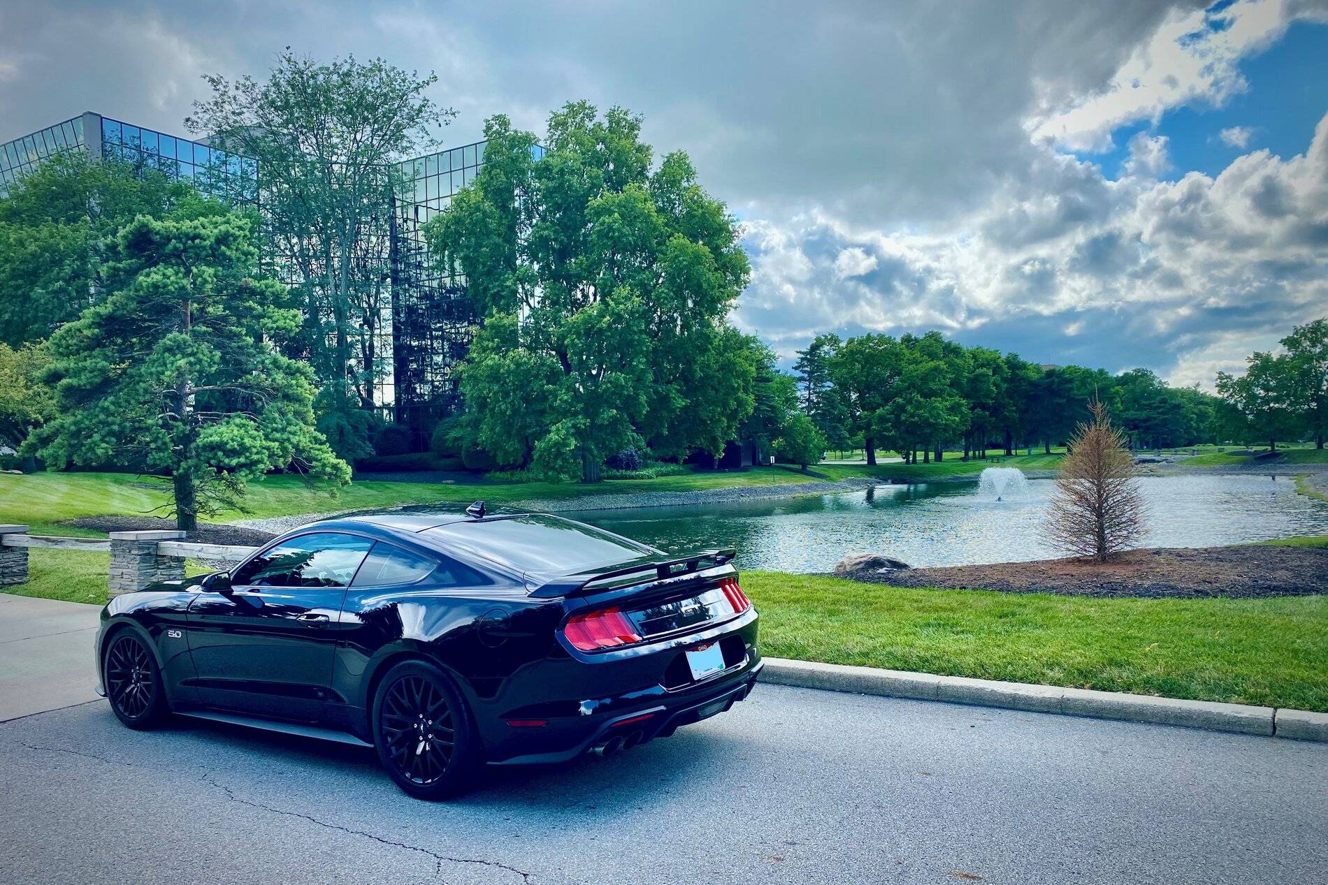

This is about 1 month and 500 miles. Looks like the car is fully settled.
