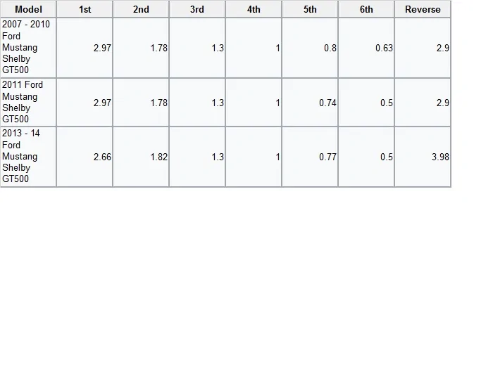

Just got confirmation from Ben Calimer regarding the gear ratio. The 5th and 6th gear ratios are in fact 0.74 and 0.50 which I'm happier with (MORE MPG...lol). I'll be going with 4.09 gear set from Ford Performance along with the recommended installation kit and bearing & seal kit.

For those interested in seeing gear ratio options for your TR6060 assuming a 28" tire, I attached a PDF copy of my spreadsheet. There is two sheets to view depending on the finals gears that your tr6060 may have. Overall I used the tremec calculator as I liked how it spits out the info.
Hope this is useful to others.
