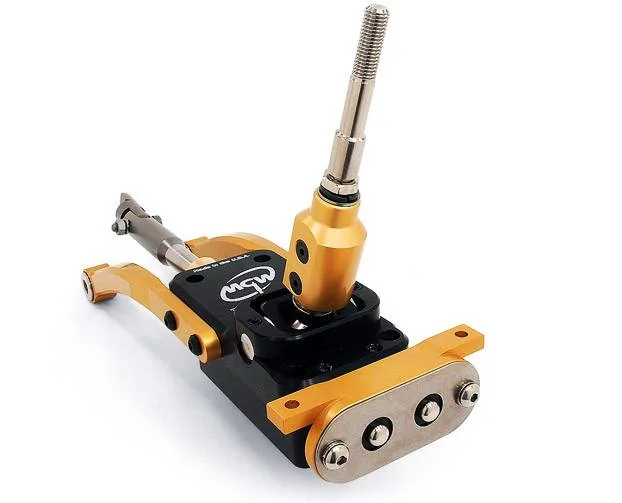

Shifter (unsure if I am going with MGW or the S1 sequential)
Does the boot from the MGW shifter attach correctly to the s550 center console?

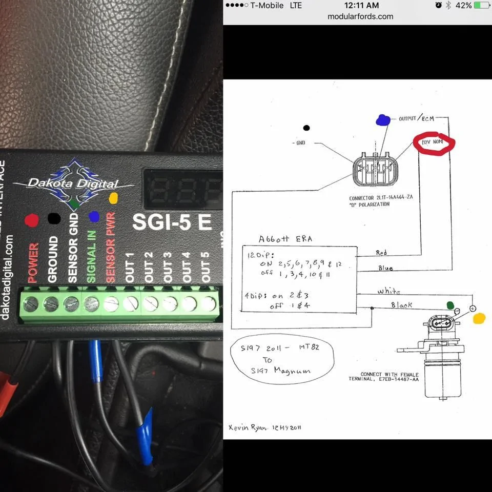

Here is what i have on the Dakota,
In the schematic i had to change from the picture above. *Colors are based on the color dots on the schematic not dots on Dakota box.
Yellow dot wire from 6060 speed sensor, goes to signal in @ Dakota. Blue dot wire from pcm, goes to output 1 @ Dakota box.

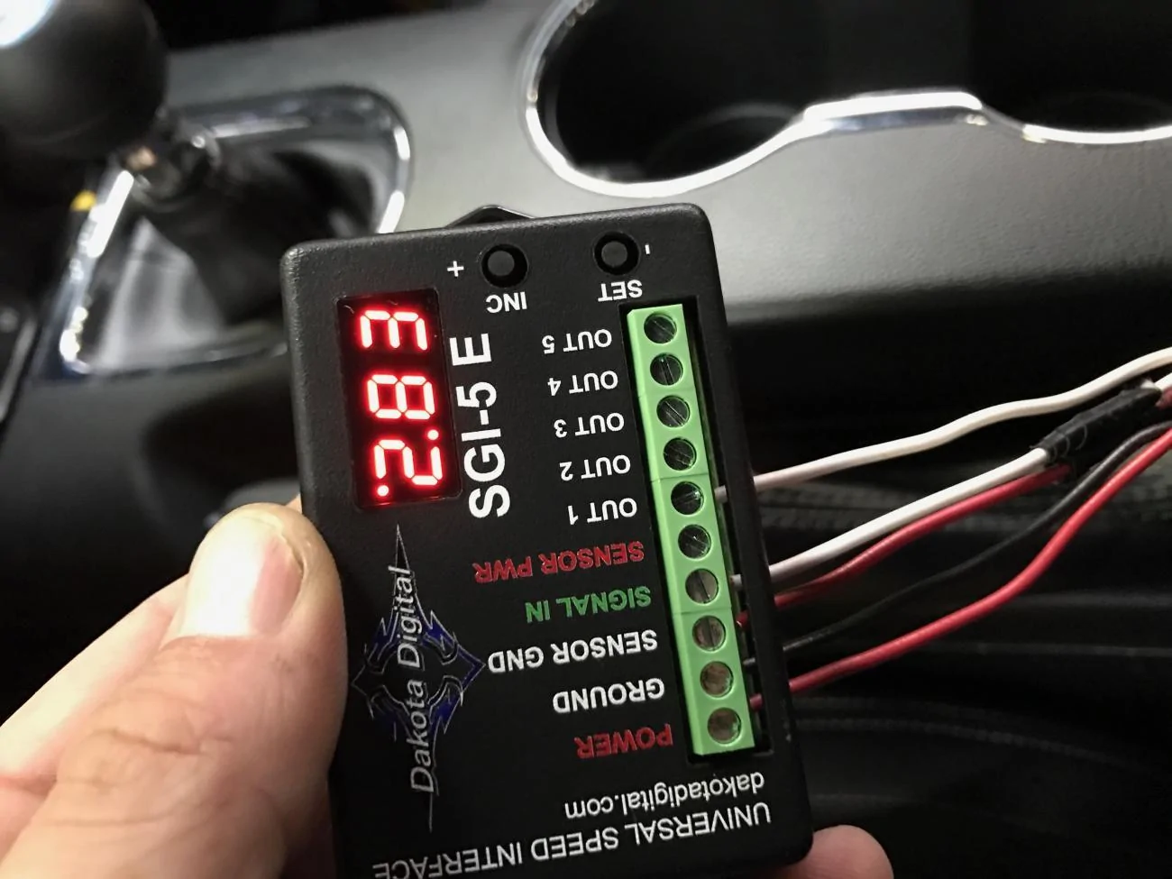

Set the Dakota box to high input high output. Then manually adjust the the readout with the + button while driving until you get to 2.83.
I used the OSS reading on my ngauge to match rpm in 4th. Which comes to a gain setting of 2.83 on the box.
This is what worked for me and should work for you as well. + cruise works in all gears.

So are the connectors actually necessary? Or do you splice the connectors into the factory harness then connect them to the trans and run extra wire to the dokota box?

Yes. Use connectors otherwise you will have to undo any spices when you need to remove the trans.
I did this a few years ago and many beers lol. I would have to refresh on it. If I remember correctly
I had pigtails for all connectors on the 6060. I cut the leads of connectors from car and wired to the pigtails where applicable. OSS from car will need to be sent to dakoda and use the OSS pig from tr6060 and run to dakoda. This will allow you to be able to pull the trans when needed. Pretty sure reverse light is same on both. I didn’t run lockout.
