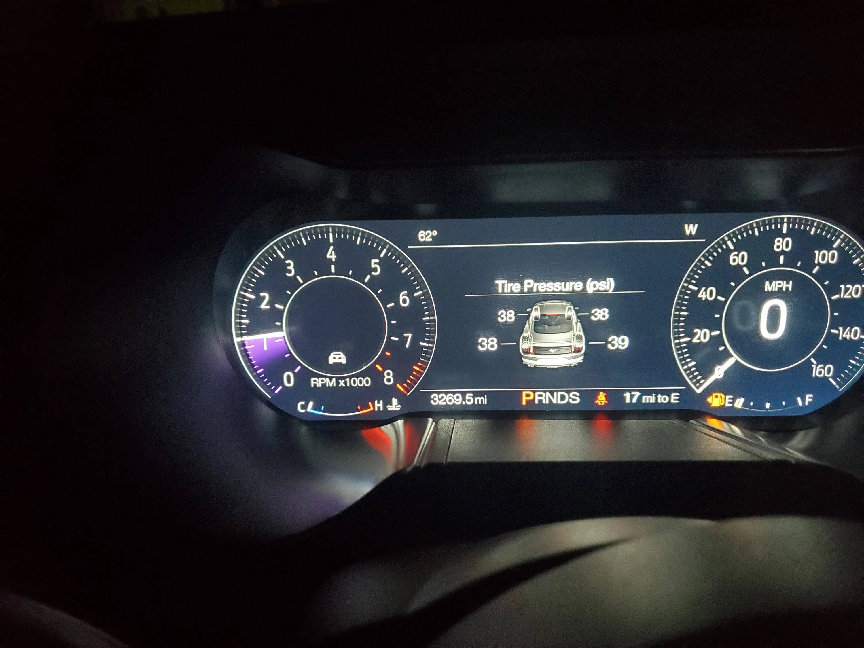

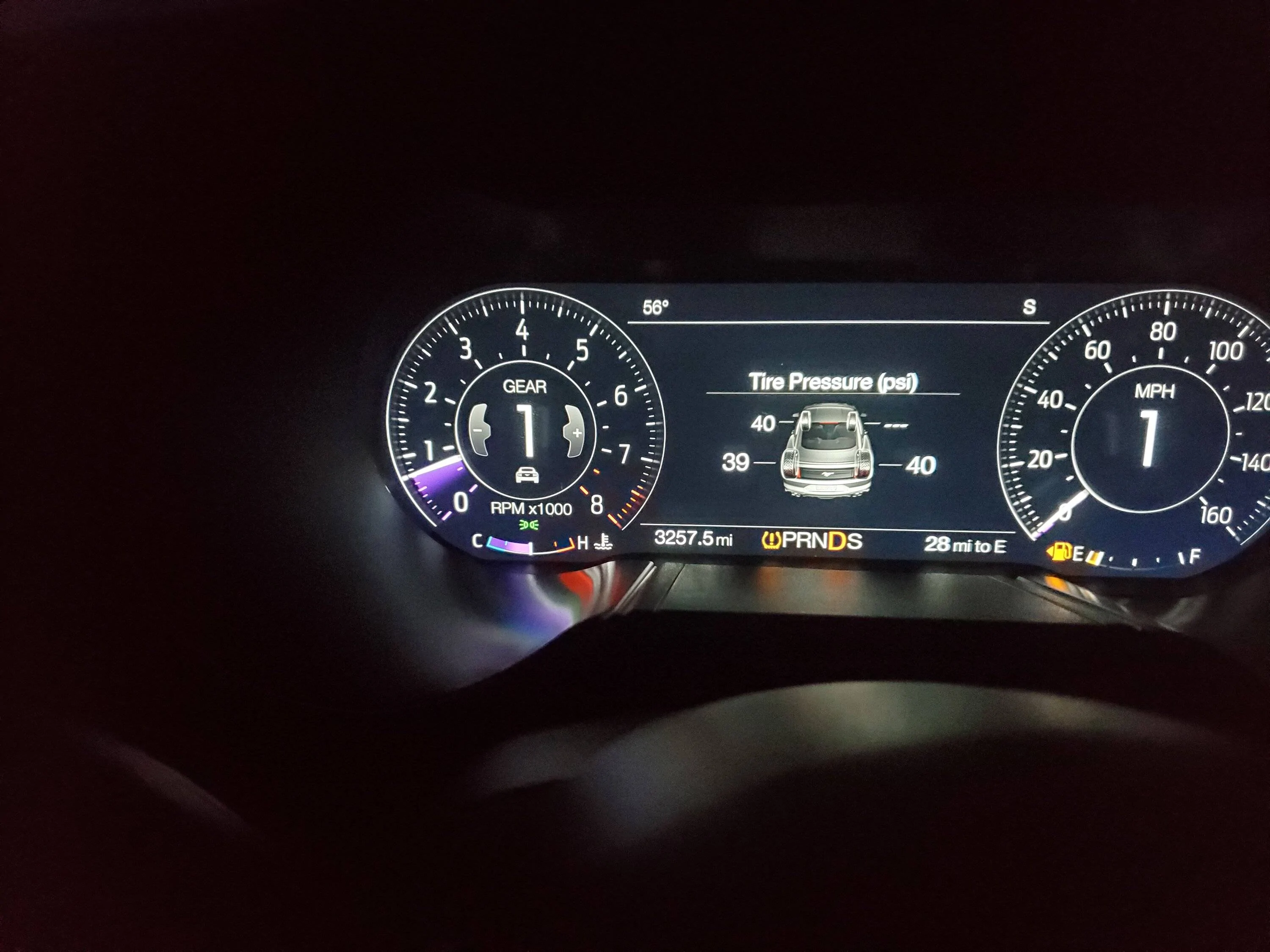

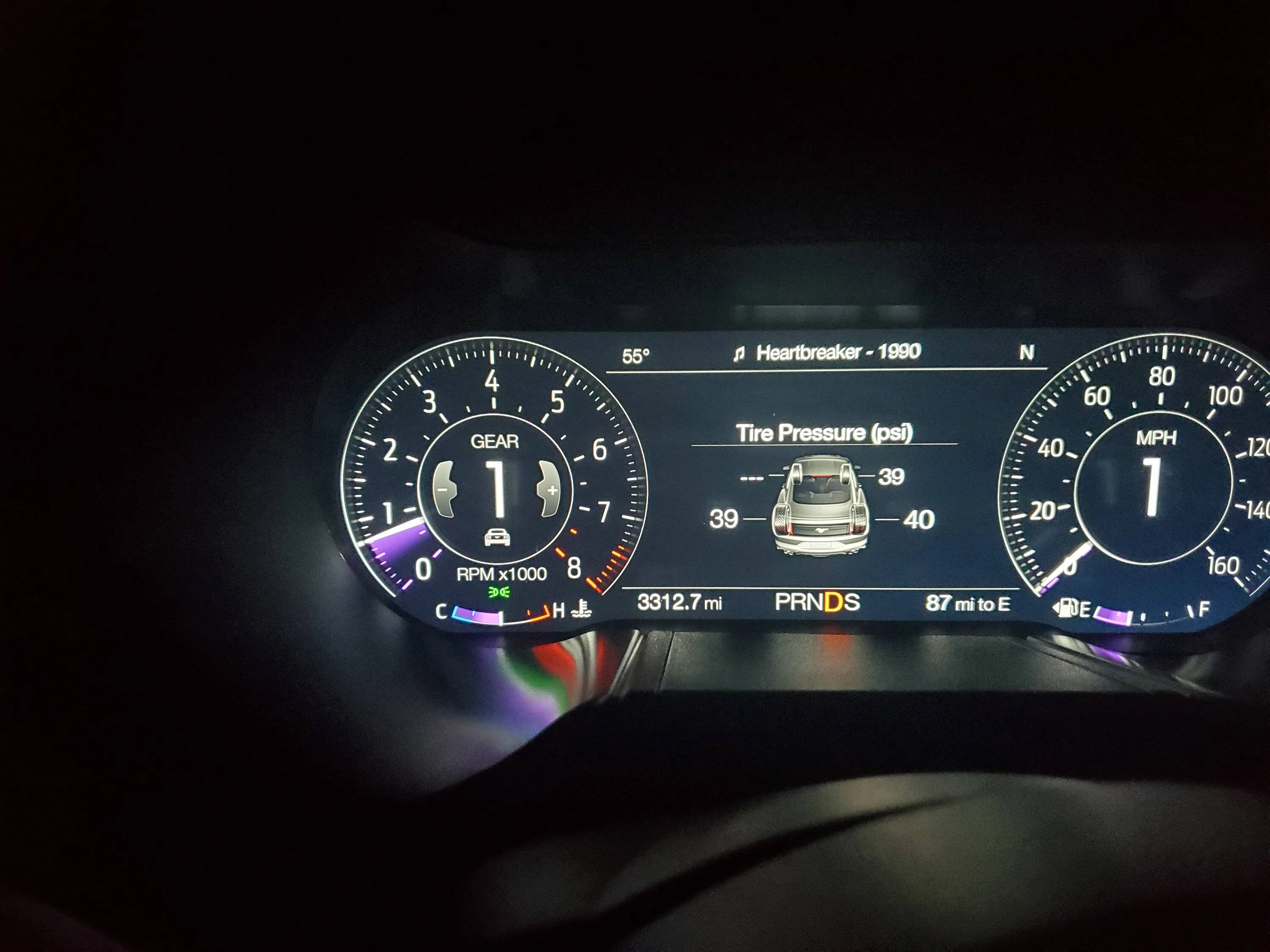

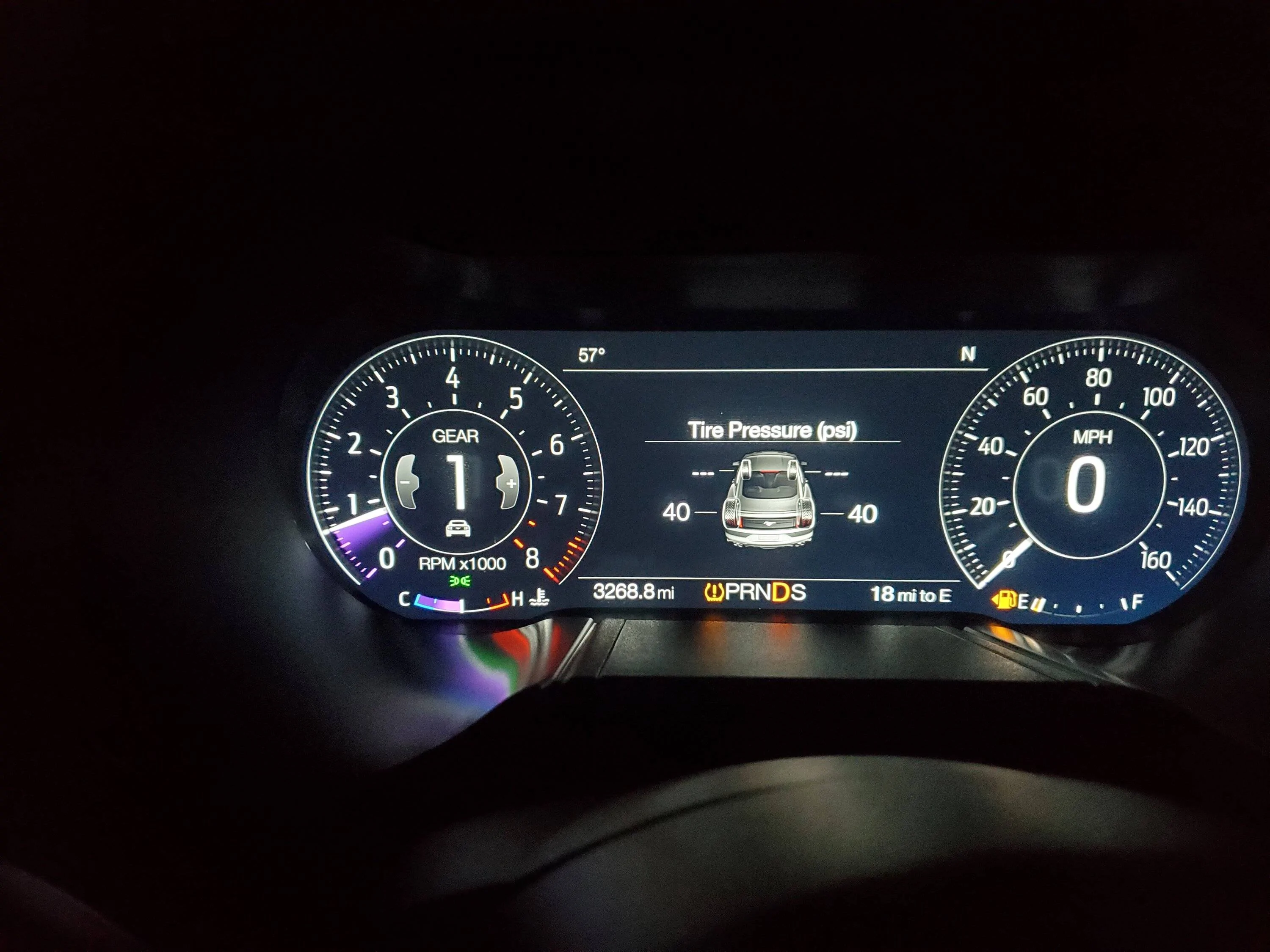

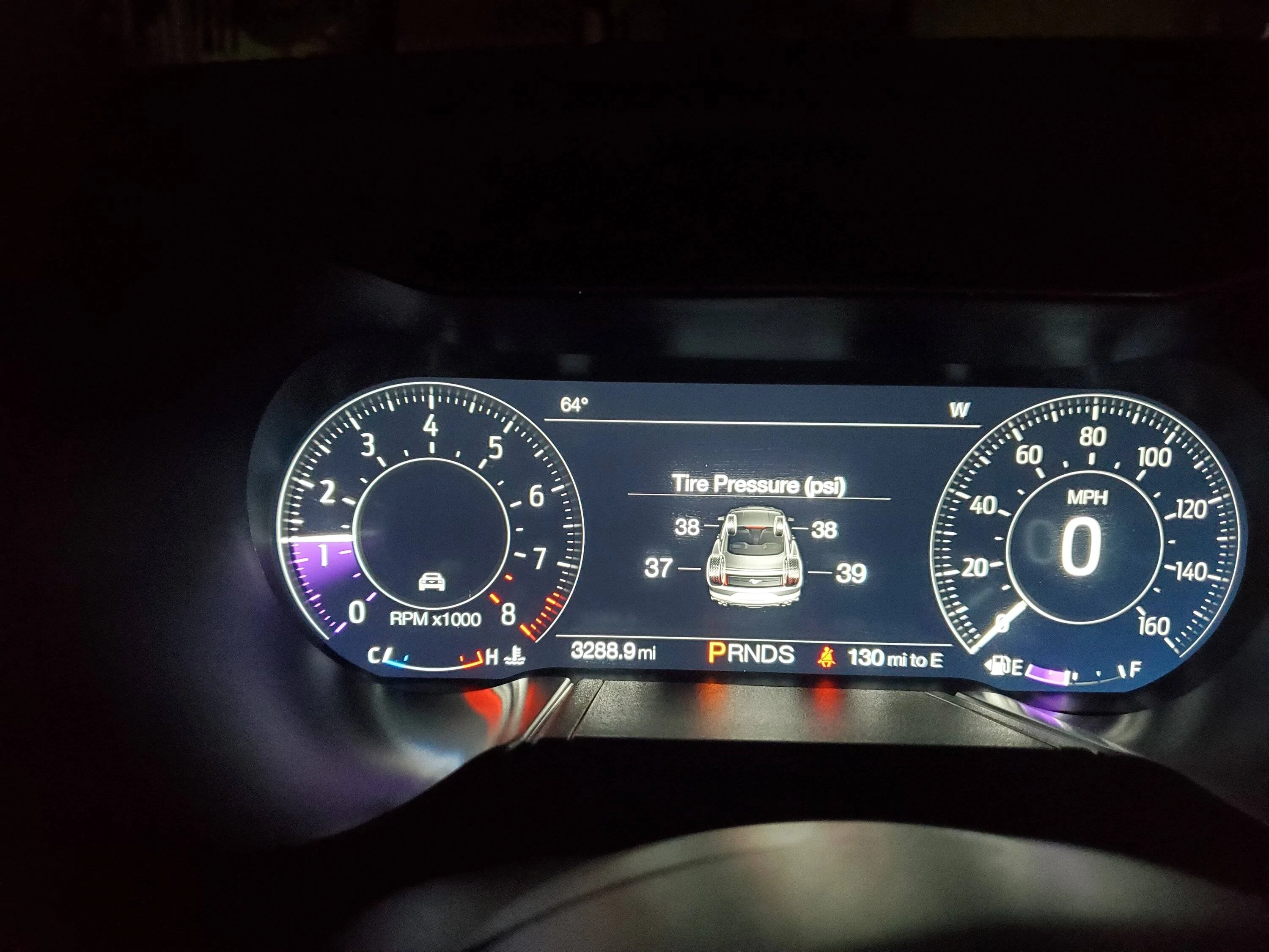

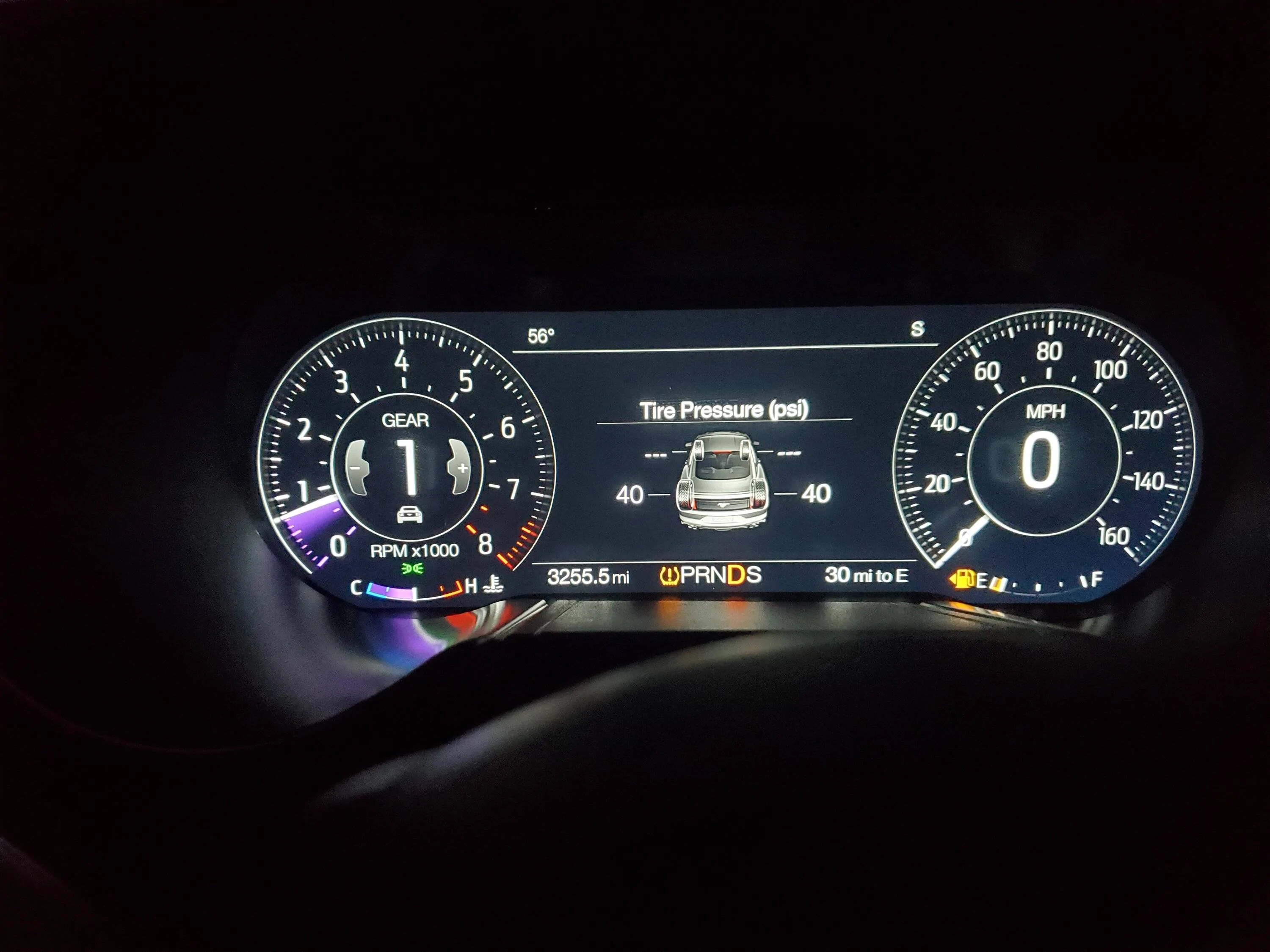

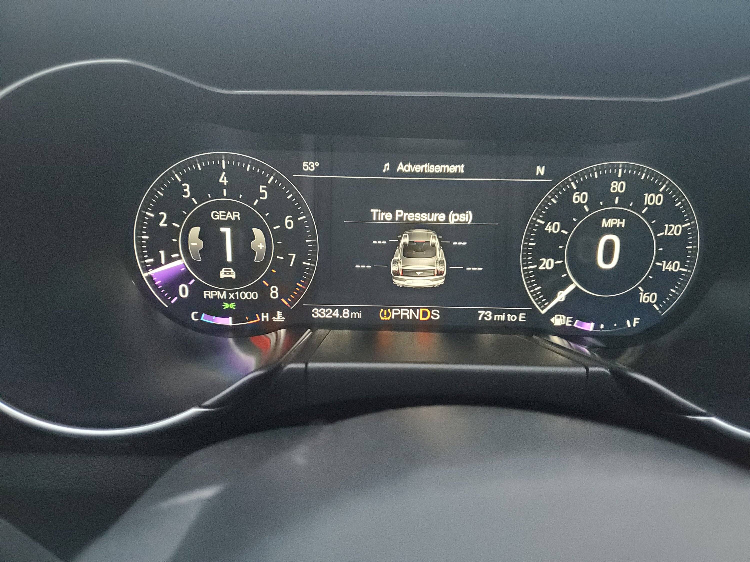

Hello everyone & good morning. Looking to see if anyone could help me solve this issue before having to get a headache from my local Ford dealership.

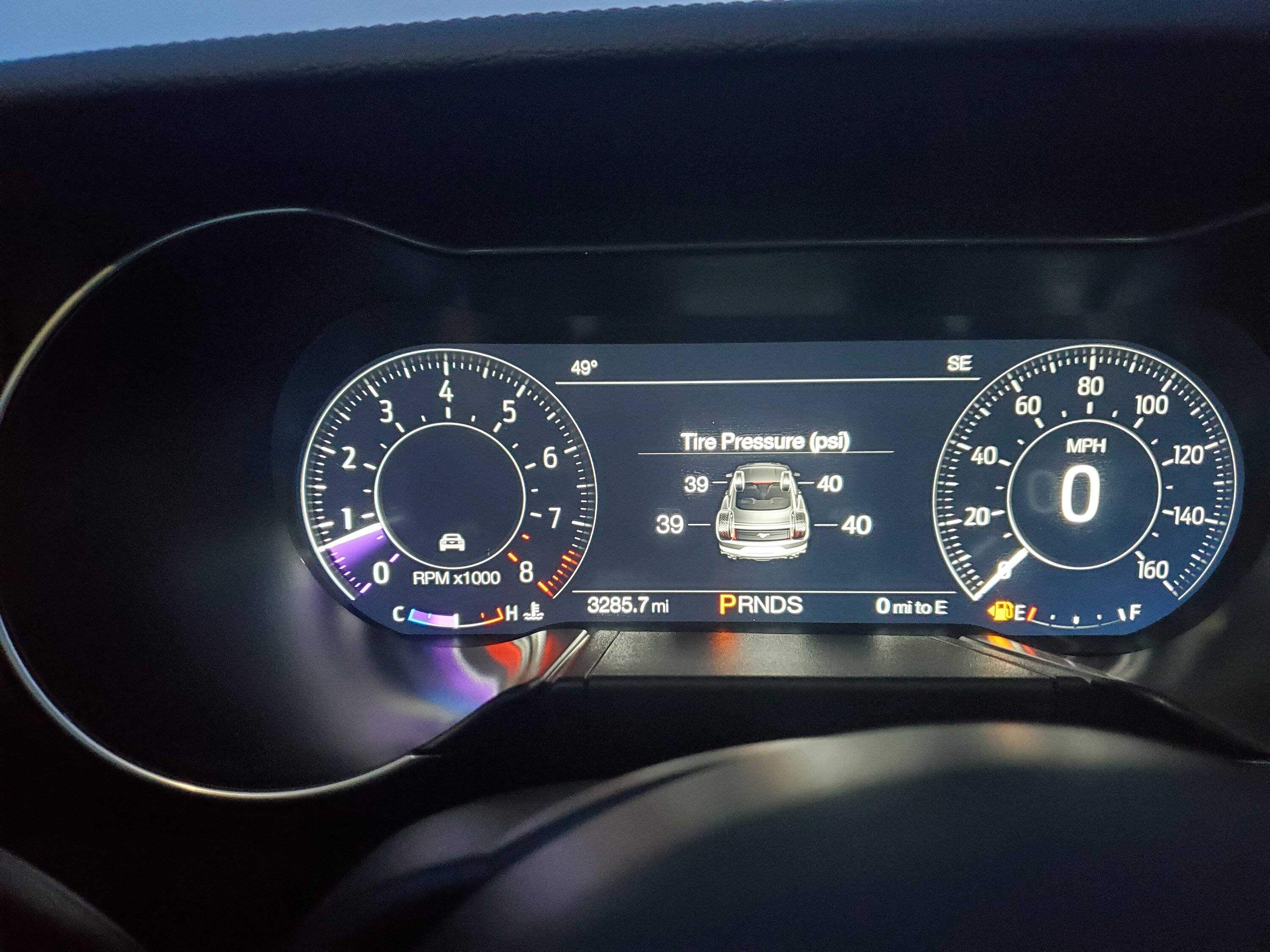

Bought some wheels a while back when I purchased my mustang. I ordered the tires & had a local tire shop install them along with some TPMsensors. The wheel sat in the garage until winter passed & this last summer I threw them on. Drove just fine without issues. One day on a long cruise my TPMS light came on. I remembered the guy telling me to stop by to sync the sensors soI did. Tried it the next day, turned car on. All sensors read, so off I went. About the :45 mark once again I got the light. Went in the next day & the guy tried programming them again. He said he might of used the wrong year model. So once again off I went. Tried the next day & once again around the :45 mark got a light. We did this all week long. Told him they had to be Ford oem sensors & he claims to never have had this issue. So after a few more tries he gave up. He ordered some oem sensors & put them on this past Friday.
Driving around Friday trying to run out my fuel I had forgotten all about it. Well sure enough at the :45 mark of driving the light comes on again. He claims he ordered OEM sensors this time. Took a few pics. Every day they all read just fine. Then one or two of them go out. What could be my problem? Gonna throw on my oem wheels on today see if that sets them off as well. My last car wouldn't even have to sync the sensors. He said if it didn't work this time, that it's most likely an issue with my car. The pics are from 2 different days. All in order from when I took them. Any help is appreciated. Would like to avoid my local Ford shop if possible. They are a nightmare to deal with. Thank you!

Well, threw my stock wheels back on. Either the TPMSensors don't automatically sync, or there is something else wrong with my car that it's not reading the sensors. This was worse than the ones with the aftermarket wheels I've been having issues with. Drove around for :30 & got the TPMS light & not one sensor t reading.

I hear you. I wish there was an easy solution. TPMS systems are a wonderful tool to keep us safe, but having been in the trenches as a store manager, I will admit that it can be frustrating tool to work with at times.
Looking back over the thread, I might recommend a few things.
If you still have your stocks on, take your car to a local tire shop and have them do a simple relearn. That will tell you if your OE sensors are dead or dying. They may just need to be "woken up". That will be a base line test to see if it's a sensor problem or a system problem.
Have that shop scan the aftermarket sensors to ensure they are programmed properly for the vehicle. it might be just that simple.
Sorry for the long winded response, but I think we need to regroup and start from scratch.
