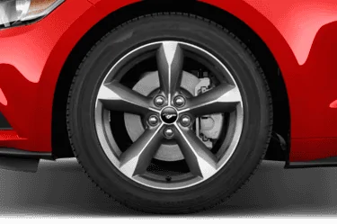

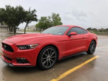

I have a '15 V6 Mustang and had the stock 18" wheels on it. After searching for used wheels and tires on craigslist, I found a good deal for me. They were the 19" wheels from EcoBoost I believe. Anyways, after putting them on and driving the car for a day or so, the TPMS gave an error on dashboard "Tire Pressure Sensor Fault". After doing some research, I found out that tires are needed to be reprogrammed. So, I bought the TPSM Transmitter on Amazon https://www.amazon.com/gp/product/B001FKSNUI/ref=oh_aui_detailpage_o00_s00?ie=UTF8&psc=1 and followed the steps on this video . However, after holding the button on the transmitter to the sensor while in the correct mode, nothing happened.
So, could it be that I bought the tires/wheels without having sensors on them or they're not working? If so, would I be able to remove the working sensors from my original wheels and put them to the new ones I have?
The previous wheels I had, 235/50/18
The new ones I got, 255/40/19
View attachment 309497 View attachment 309498
