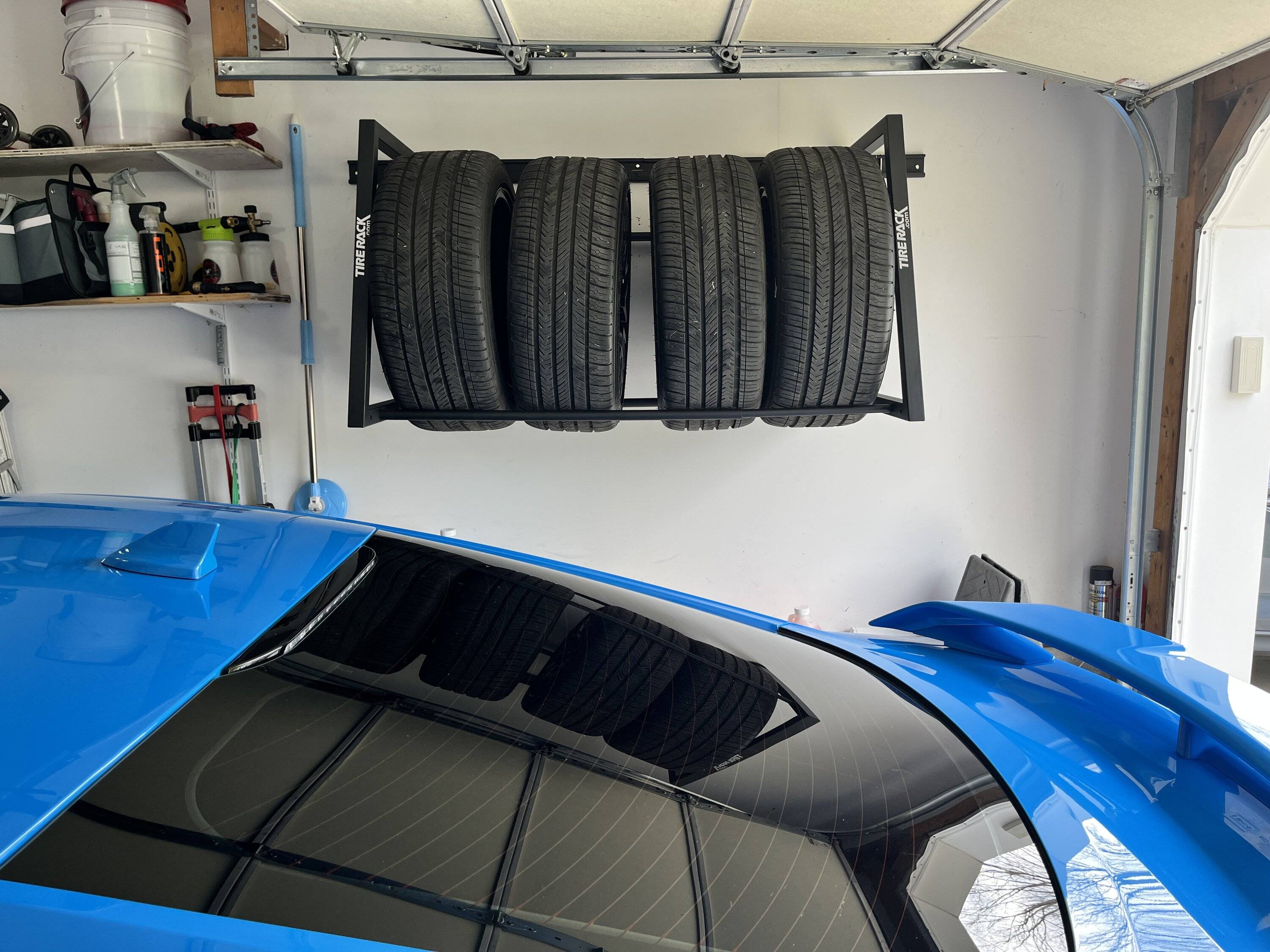

I know when I swapped to another set of wheels, it took over an hour of driving to get them to relearn. And I had issues for a while as well due to the fact I had my factory wheels in the garage and when the car was parked it would confuse the car's computer. I moved them out to my building which is probably 100 feet away and the issues stopped. I agree, TPMS is a pain in the @$$ but it is a wonderful feature, I wouldn't want to do without it especially with the 30 series tires I have.
I had not thought about this. I have my set sitting in front of the car on a rack. But yesterday I found our that the stock wheel sensors were dead/asleep. After going through the process of syncing them. I posted about how when I turned the car on they went blank. Well I had to go do a data log so when I started to drive around, about 3 blocks over, 1 of them woke up, then 2, then all 4. Drove around for :45 & all stayed synced up. So now I'm gonna remove them, maybe take them out to my shed or farther away, reinstall aftermarket wheels & try to do the relearn process again. Maybe as the gentleman above stated, my tire guys programmer is not up to date & that's why they don't sync. I still believe it might be that he keeps buying the 3rd party vendor ones as Skye stated & not the ones made by Ford. We will see. Ill post my results. Thank you all for your input, help & time.

Yeah I put mine in my building away from the car for a few days, made sure the new sensors learned and were working. Once the new ones were functional, I brought my stock PP wheels back to the garage and put in my rack for storage. They indeed do go to sleep after a while so I have no problems now. I will do the same process when I swap back for the cooler months. I have Michelin Pilot all season 4 tires on my PP wheels so I can drive the car in the cooler months comfortably and not worry about driving on hockey pucks for tires :) These summer tires are hard as bricks when it's down to 40 degrees or so and feel like they are square til warmed up. Can't wait for it to warm up a bit more. :)

Yeah that's what I think my issue is. Guy must of installed his vendors units, not the made by Ford ones. But my oe Ford wheels were asleep yesterday. But had been on the rack for over a year & a half
