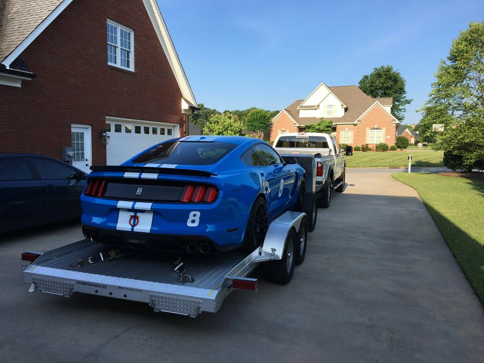

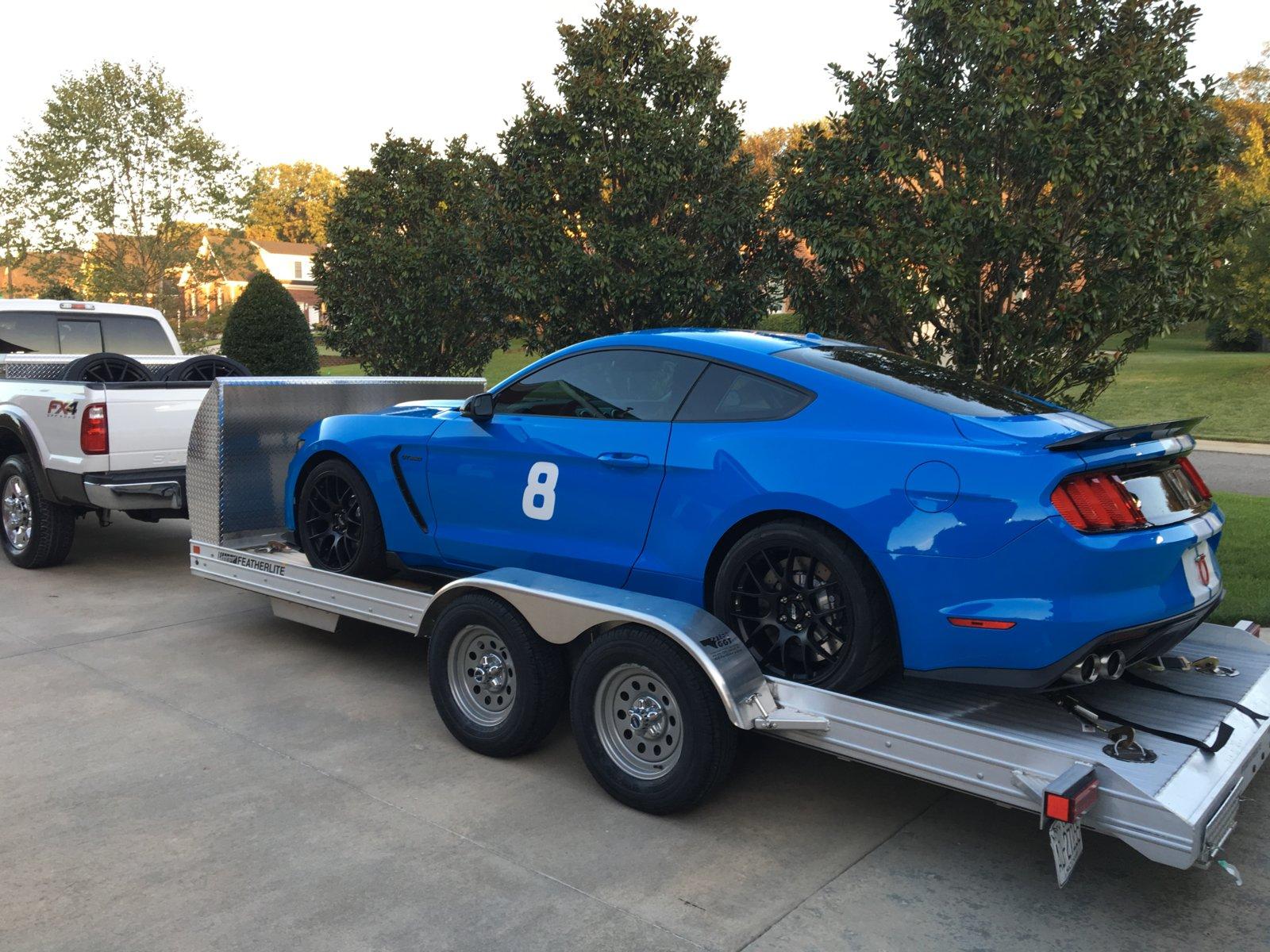

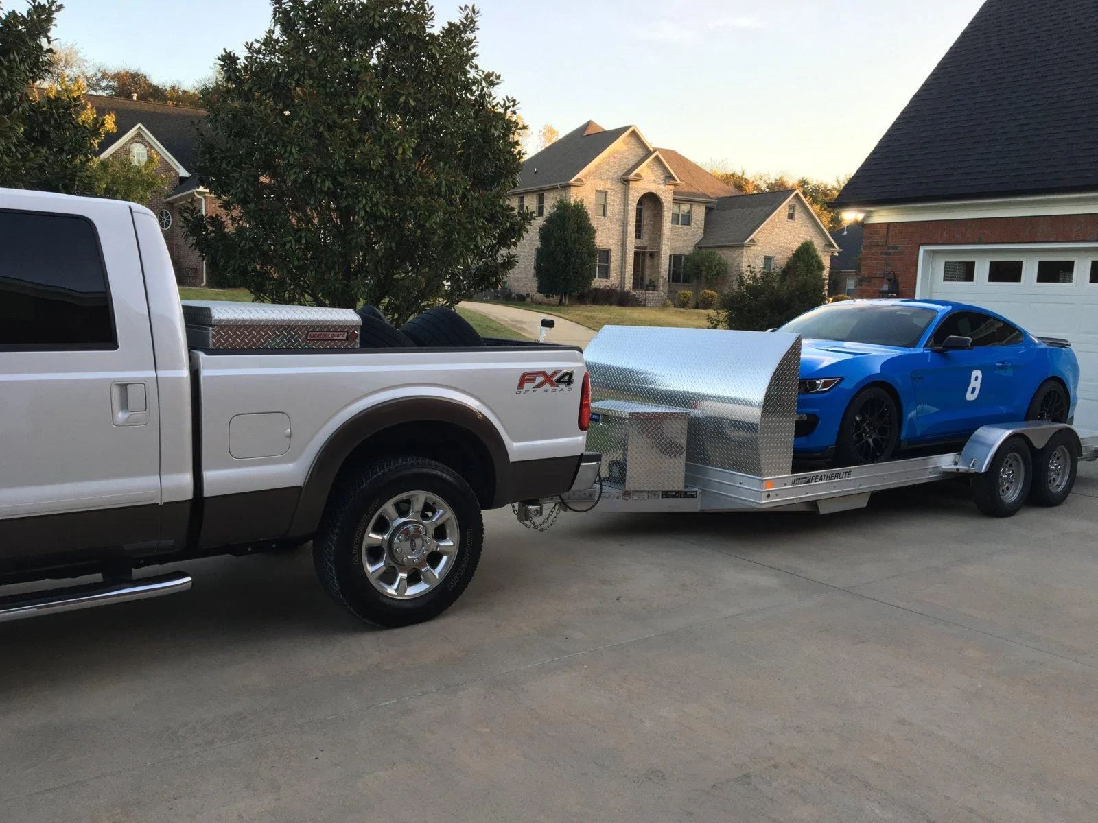

I’ll be damned. Is that your custom design? I have never seen one.
Nope - started with my trailer and added their cover retro-fit kit.
They also sell complete trailers using aluminum units as the basis.
Gotta say, though, that they nailed the sizing of mine just from my measurements and pictures.

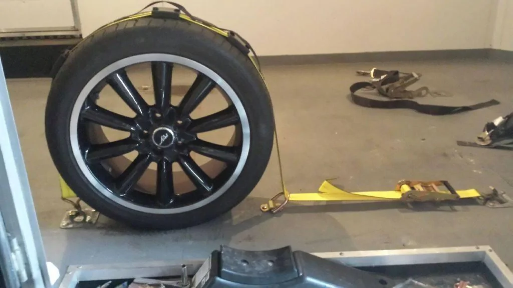

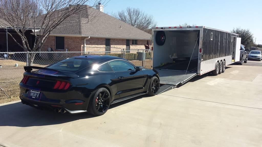

I'm interested in how you anchor your 350R to your trailer floor eyelets...what do you use, and what do you connect to on the car?
Thanks,
Steve
I usually pull 2 at a time. I use the long Race Ramps designed for the trailer door flip-out. Keep in mind that these cars are very wide. They are also low to the ground and difficult to tie down.
Thanks,
Steve
In the front I use an over the tire type strap that then ratchets towards the front (anchors at the rear of the front tire, has a pivot point at the front of the tire and then the ratchet is about 6" in front of the car pulling it tight). I have recessed E Track running the entire length of the trailer that these clip into. I've attached the Cobra Jet tie down brackets to the R. They are a simple bolt on. In the rear I use those by attaching a ratchet straps that has an open hook on them. I use a self made "broomstick" to attach the hook on the strap to the tie down hook from the rear of the car. A skinnier person could go from the side but it's really tight. This picture is in a different trailer of mine but the theory is the same for how I strap the front.

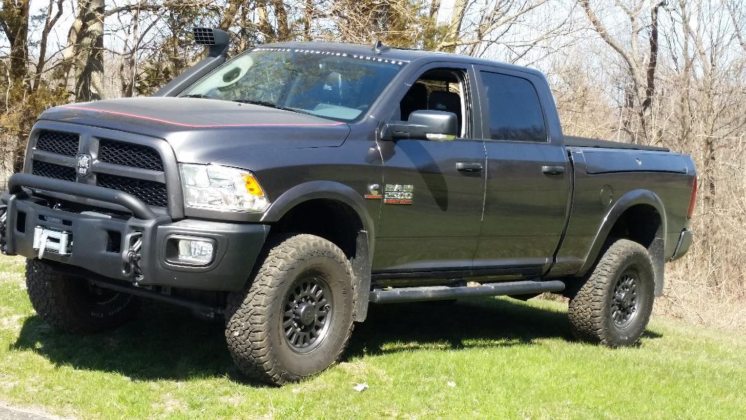

Ram diesel 3/4 ton
