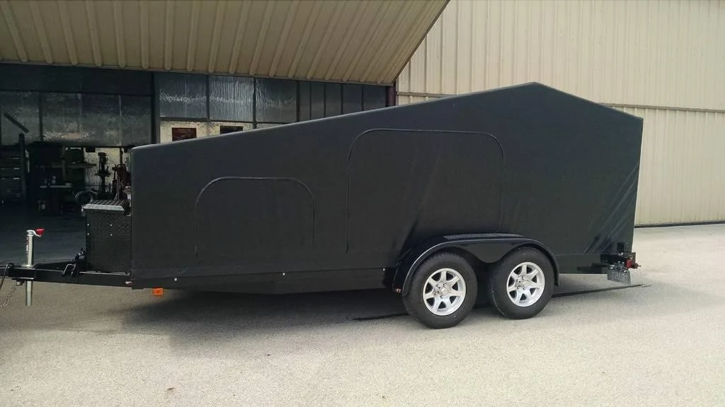

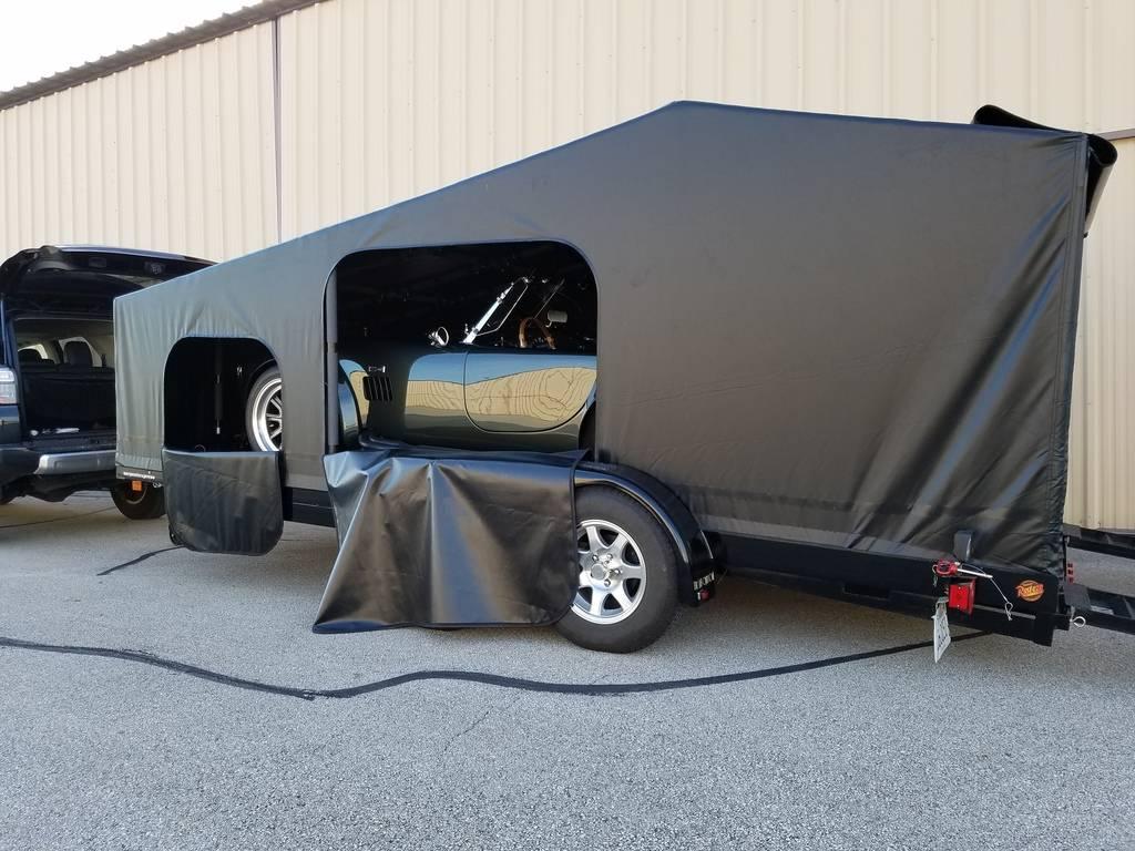

My rig is sized for my FFR cobra replica, so it's a 2015 Toyota 4Runner and a Serpent Express add-on cover system for my 16' steel trailer. I did all the work myself to update my trailer and install the Serpent Express cover - not secure, i.e., no locks, but it does a great job of keeping the cobra out off the weather and aids in aerodynamics and mileage. It's sized just right to fit my wife's '67 Camaro and my '65 Mustang vintage race car project, too.
Unfortunately, the GT350 doesn't fit inside - so it has to get places under its own power.

You're telling me that that add-on cover doesn't fly off at highway speeds!?

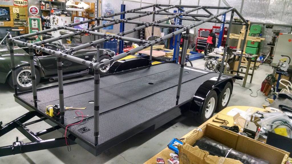

Not at all - it's rubberized canvas fitted tightly over a frame made of 1" tubing (conduit). The frame is held together with corner-connectors using set-screws and fits into tubes welded to the trailer perimeter which also use set-screws to secure the frame. The cover is then held in place via metal clips that grab onto 1/2" conduit that is in a sleeve around the lower perimeter of the trailer.
Very secure and unflappable (sorry for the bad pun) at highway speeds - I've cruised at 80 mph with it and have had no issues at all.
Here's a pic of the structure when I was in the process of installation.....

I’ll be damned. Is that your custom design? I have never seen one.
