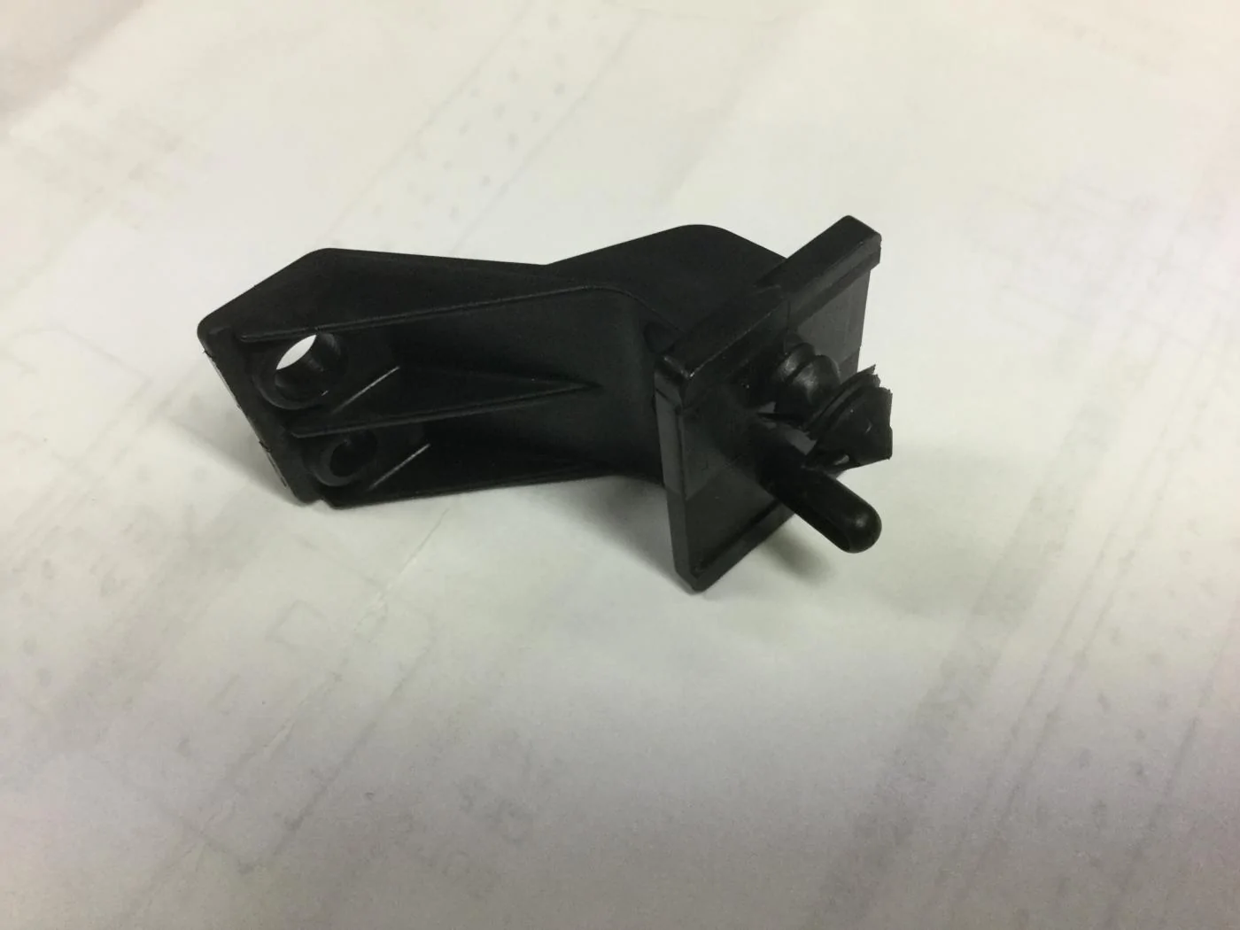

I popped the temperature sensor off but really can't see it. Hopefully I can figure out how to reinsert it. The probe points to the passenger side, correct?

I was able to position the coupler such that no trimming of the grill was required. The only downside to that is the temperature sensor would no longer fit above the coupler. I ended up moving the temperature sensor to another location and securing it with heavy duty outdoor 3M double sided tape. I'll see how it holds up with the heat of the engine and Texas summers.

Glad to see you finished OK, that amount of projection is exactly where I have mine mounted. I mounted my temperature sensor to the plastic cover above where it was originally mounted. Just drilled 2 new holes in the plastic about 1 inch offset from the hook body. It all works great.

If the double-sided tape doesn't work for the temperature sensor, the best option is to mount it on top of the crossbar, in the same holes, without the angled spacer, instead of hanging below it like it does in the stock position. No additional holes needed.

For those that do this mod in the future, just remove the temperature sensor from the mounting bracket, remove the mounting bracket entirely, and install the temp sensor right where the mounting bracket was. Put this little bracket in the box with other items you have removed.
