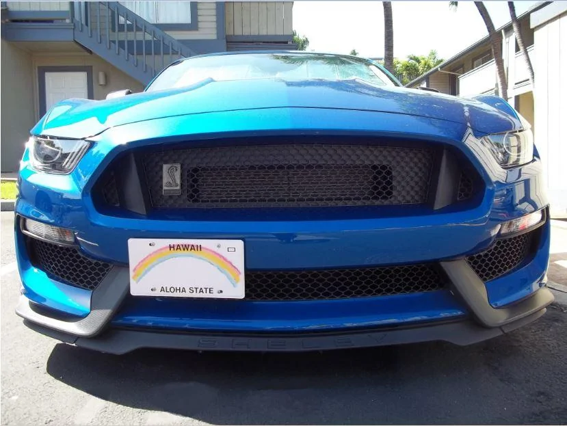

Had the dealer install the tow hook receiver before they installed the front splitter. Yes, they had to drop the belly pan. Since we need to run a front plate, ordered the front plate adapter - it just screws in place of the tow hook. No pics with the tow hook on the car yet. Also had the ZL1 splitter washers installed at the same time that the splitter was installed.

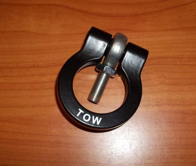

I can't help you with the front fascia removal (I installed my tow hook yesterday from underneath, which I DO NOT recommend), but I do have one tip for you once you get the tow hook receiver installed... Before you screw in the actual tow hook, cut a 3/8" to 1/2" long section off a small bolt and insert it into the hole in the receiver. This will act as a positive stop for the tow hook so that you can fully tighten it without the edge pushing in the honeycomb grille or putting pressure directly against the grille.
