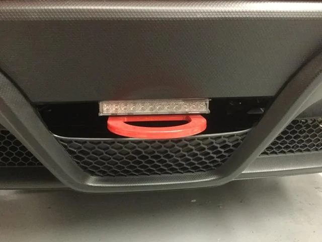

Looks like this when complete. Only challenge was drilling the 3 holes in that hard steel bumper beam. I didn't weigh it, but that is some heavy, tough material.

Loss of the backup light is a concern of mine, so your work-around looks reasonable. Is the amount of light produced by this light comparable to the stock backup light? How about posting a night shot!?

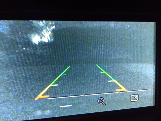

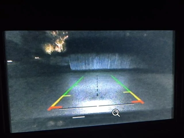

Sorry for the delay in posting these pictures.
First is daylight, second is night without the backup light on, third pix is night with the new backup light on. Works fine.

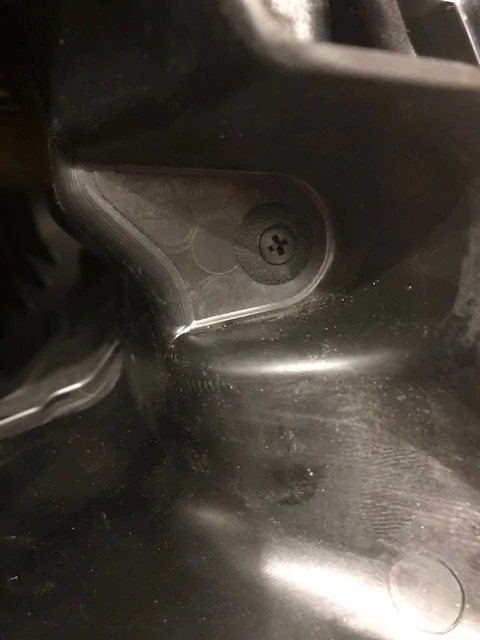

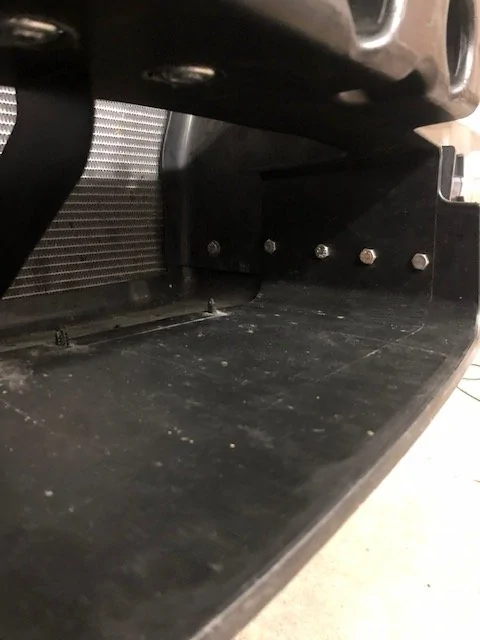

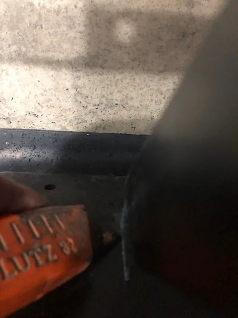

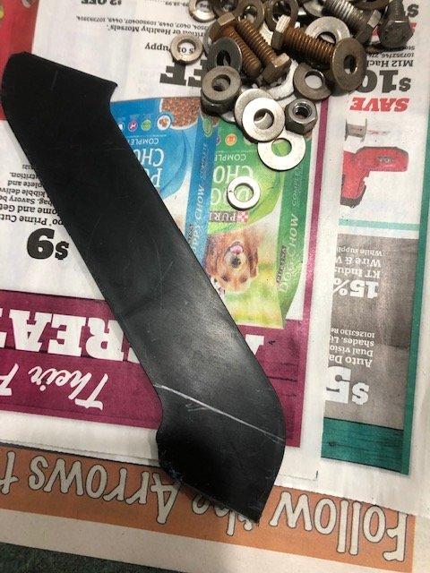

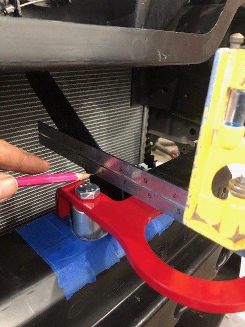

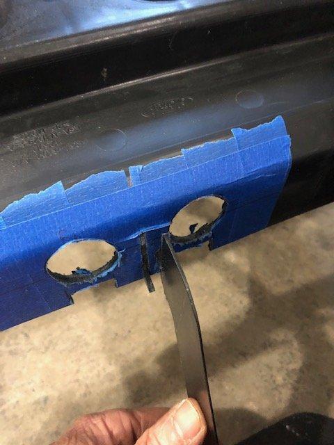

Wanted to share my experience with the front tow hook. The front facia came off easy & was thinking this will go pretty well. Then as they say the wheels fell off!LOL Of course following the instructions next was the air deflector, needed modified. So removed, once out let's say it resembled a wet noodle. Prepping it for drilling & moving it around the top thin plastic brace snapped on the bottom side. Was frustrated at this point to say the least.

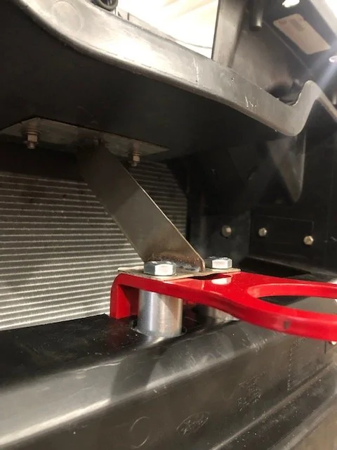

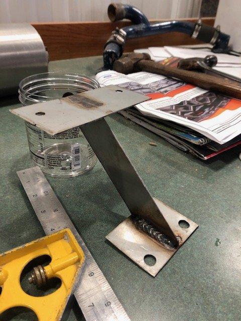

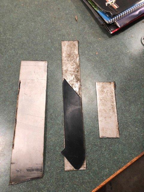

Came up with the idea of trying to salvage the deflector. Sure didn't want to find out how much $$$ a replacement would be. Proceeded to cut out the brace with utility knife.
Took some measurements & found some left over stainless steel pieces from a ss hog feeder repair here on the farm. Most likely the only GT350 in existence repaired with a hog feeder!LOL
Made a trip over to the farm shop & set up the welder for stainless. Didn't turn out to bad. Started the process of getting it back together. Decided to use ss 1/4" bolts instead of the push pin fasteners for the air deflector & it was a 100% improvement. Rock solid!

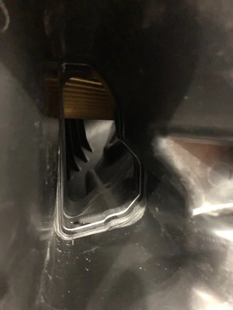

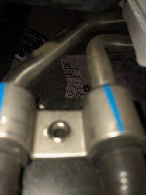

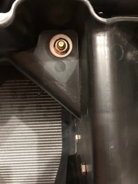

During the tear down found that the cold air inlet was not seated correctly from the factory. Easy fix just make sure when they go back together all edges are seated. Also found there was not a fastener for the oil lines on the frame next to the cooler. Took car of that too.

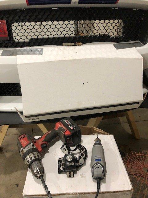

Another bolt used for the air deflector, NAPA (Belkamp) fastener & tools needed for the cut out on the grill. Make sure you cover the front facia with cardboard to protect paint & stripes!
That's it for now.

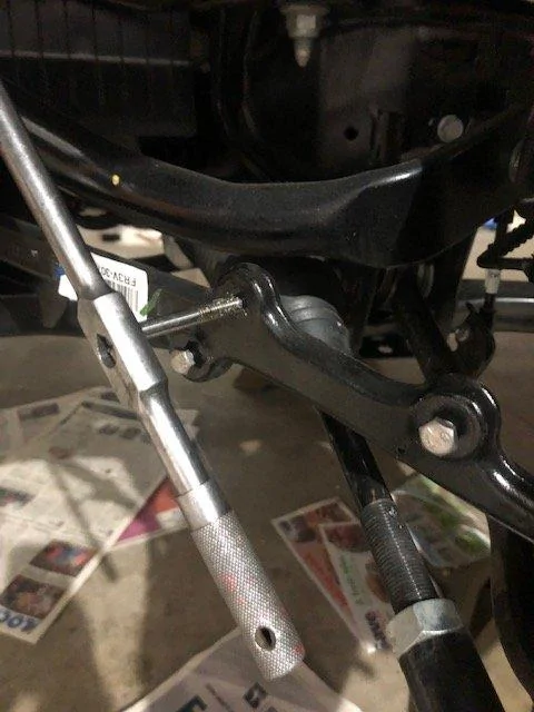

Also while at it I tapped the forward control arm. Wheels off & plenty of room.
