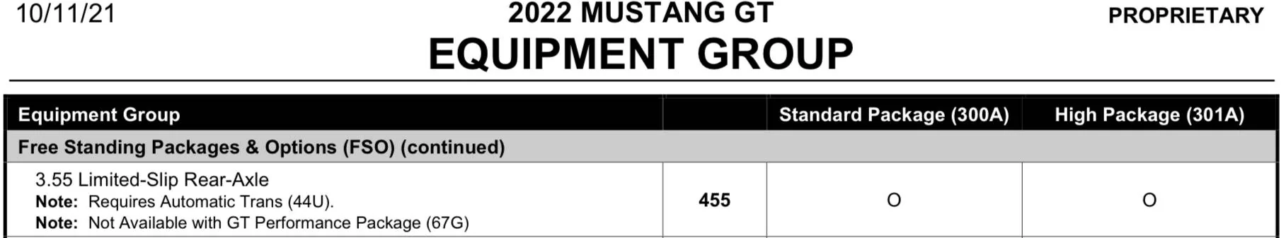

Not sure about '22, but 3.55 has historically been a paid option on both manual and auto cars.

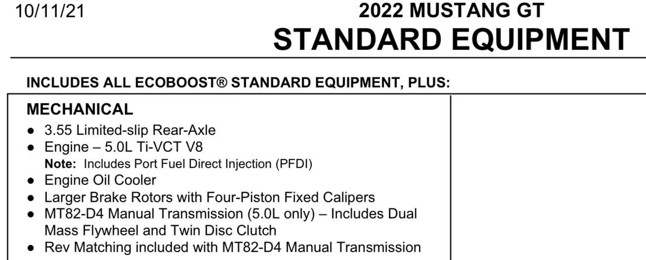

The manual '22 GT parked next to mine at the dealership was built 8 days earlier and the 3.55 option was listed as no-cost on the window sticker.
