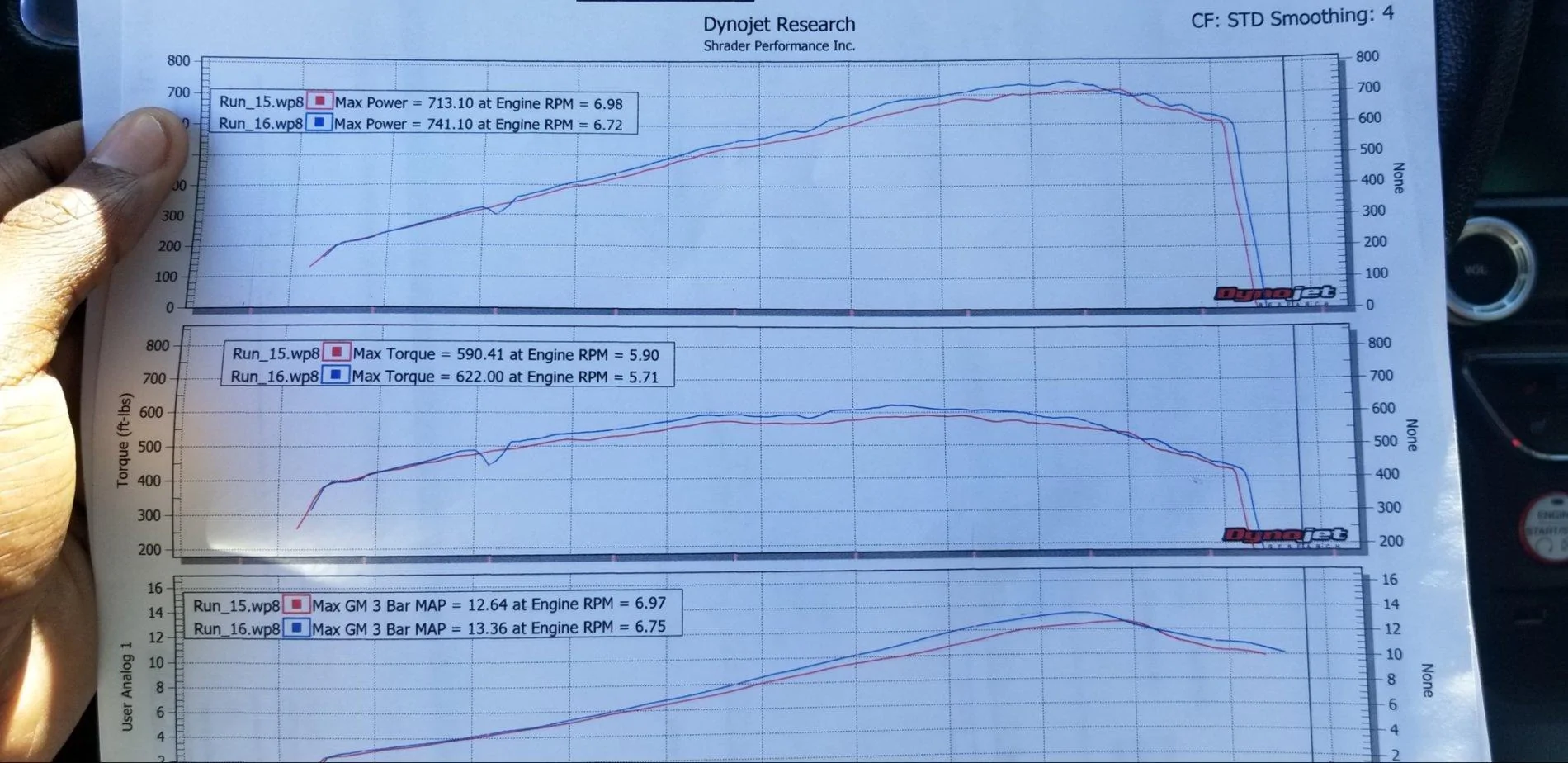

I have it a TQ booster and its pissing me off. I understand how it works and I think it definitely increase my TQ and maybe horsepower. My TQ and HP numbers are pretty good but once it gets to 6900 rpms, it wastegates all the damn boost out and it'll drop from 12lbs to 9 smdh. I have a 18 intake and oil pump gears. I should be able to pull this shit to 7500rpm and keep pulling but instead it drops boost at 6900. I also have a e-boost controller. A form memeber told me to get a different solenoid but I dont want to spend another dollar on this thing and be disappointed so I'm going to just turn off the e boost controller off, put a 12lbs spring in the wastegate a hope it holds the boost all the way to 7500rpm

Its doing what it's designed to do.

I had the torque booster installed on my previous Paxton car. With the standard pulley, It made 620/510. after the torque booster install it made 643/557...made a big difference ...

As others have noted, you will be limited at the top as boost bleeds off. I'm also wastegated at 12psi with an 18 manifold. I make good power until around 7200 then it drops. Works good for me as I shift at 7500 and not over spinning the blower. 747 hp/ 589 tq.
