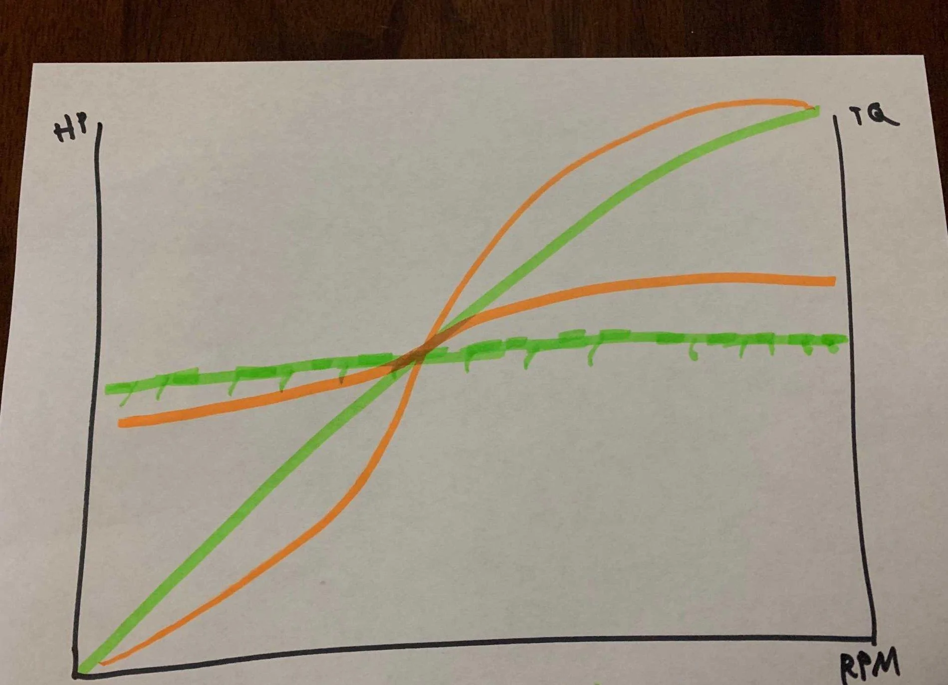

I'm going to reiterate what OP said but with pics.
ELI5:
First, you have to understand how TQ affects HP.
HP is just torque multiplied by rpm/5252. That means that HP is a direct result of how much torque your motor produces at a given rpm.
In other words, whenever your make a modification on your car to increase your HP, you are really just increasing your torque curve (or you were able to change your maximum rpm).
Take a look at the above pic, a typical example of a Twin screw vs a Turbo car. The middle lines are TQ curves and the other ones are obviously HP.
THE ABOVE CARS MAKE THE SAME PEAK HP. However, the peak TQ of the orange line is higher. So let's say the green car makes 750/500 and the orange car makes 750/600. How does that affect a race for example: if they start at 4500 rpm (i.e. a little bit after the intersection) and race to 7500 rpm, and ALL other factors are the same (weight, shifting, aero, start time, etc.), then the orange car will be faster.
In other words, with all other factors constant, to be faster than another car, you have to be making more torque at the same rpm.
Now it should make sense why a torque booster increases horsepower. A torque booster is called that because that's what it does: it increases the torque output of your motor. This directly affects HP since at the same rpm, you'll be making more torque, which means you'll be making more HP.

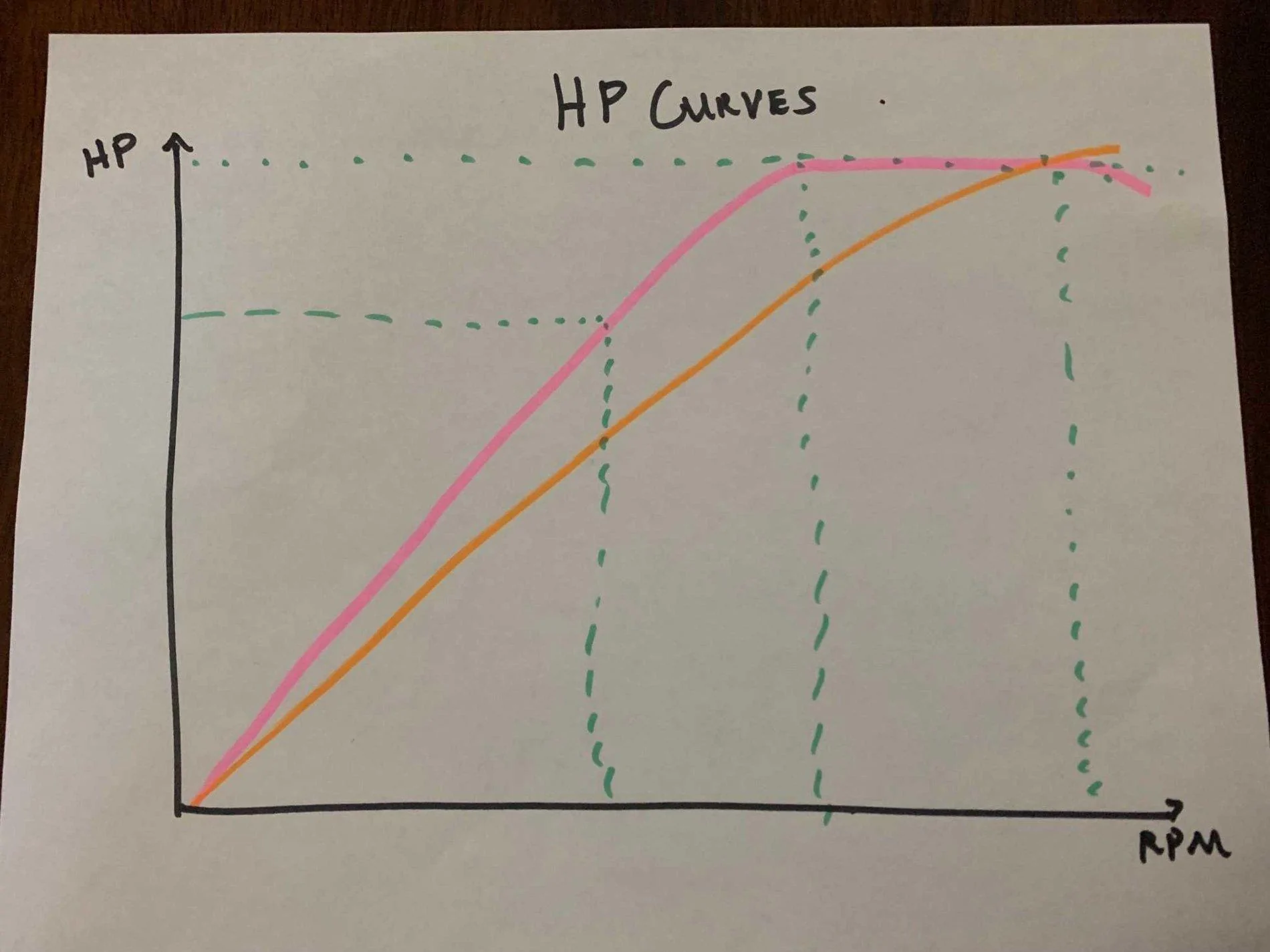

Now looking at this pic, this is what a dyno could look like before and after the wastegate.
In this scenario, before and after the wastegate, you're making the similar final HP. However, the increase in air from the smaller pulley means you're increasing torque output from the motor. All that the wastegate does is release the extra air when you've hit the spring threshold of boost pressure (which is why the HP curve becomes flat). In this scenario, the wastegated car will be much faster than the non wastegated car (with a larger pulley), because at every point in the rpm, you're making more HP except the end of the curve, where it's the same since you're cutting it off. Notice you'll reach max power much sooner though and hold for a duration of time.
Keep in mind, without the wastegate AND the small pulley, you'd make much more power than both of the examples. The point of the wastegate is to use a smaller pulley/increase boost but operate in safer conditions. The 3.33 pulley offered by Paxton is a small pulley that might start to stress the limits of the stock car (motor, blower, and trans) without a wastegate.
