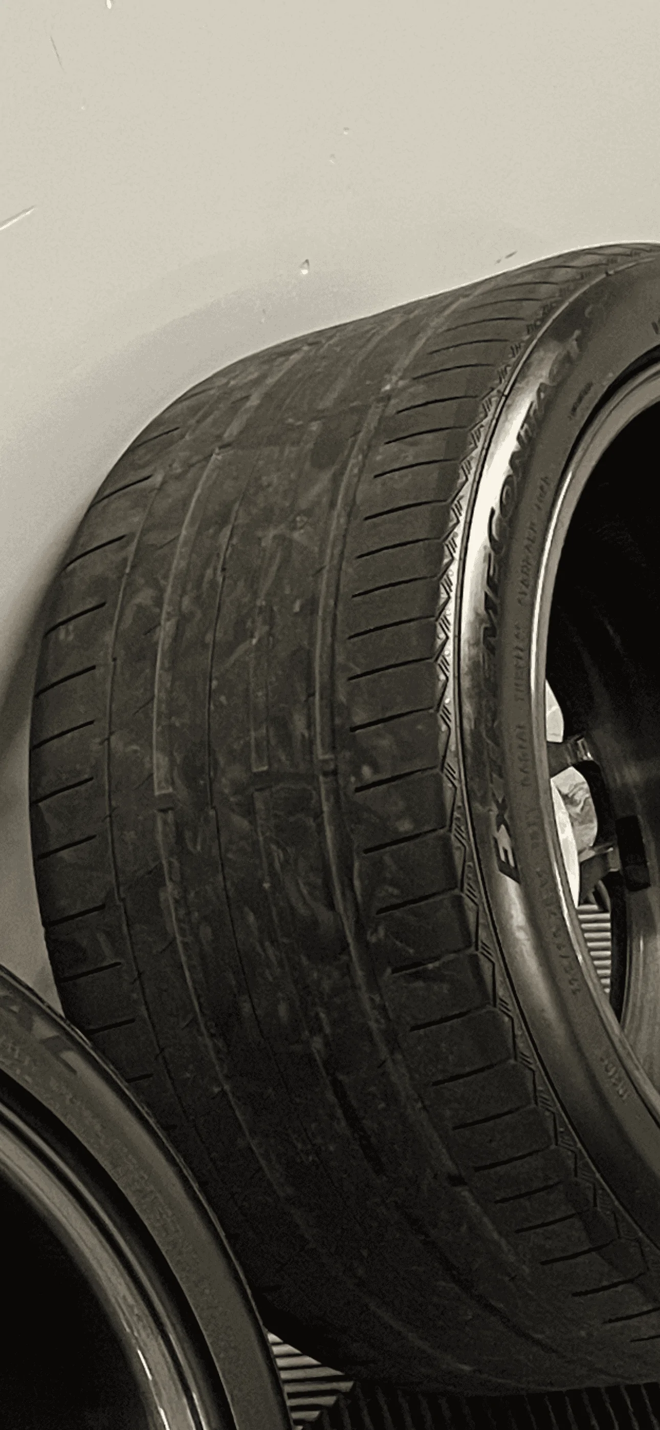

Eehhh, not entirely. It’s the toe. Camber is significantly more forgiving than toe. And for the rear, toe would need to be out pretty bad to wear the inside like a front might. Here’s a 325/30 rear with close to 20K miles on it. Zero inside wear. This is -1.5° camber and a little less than stock toe.
