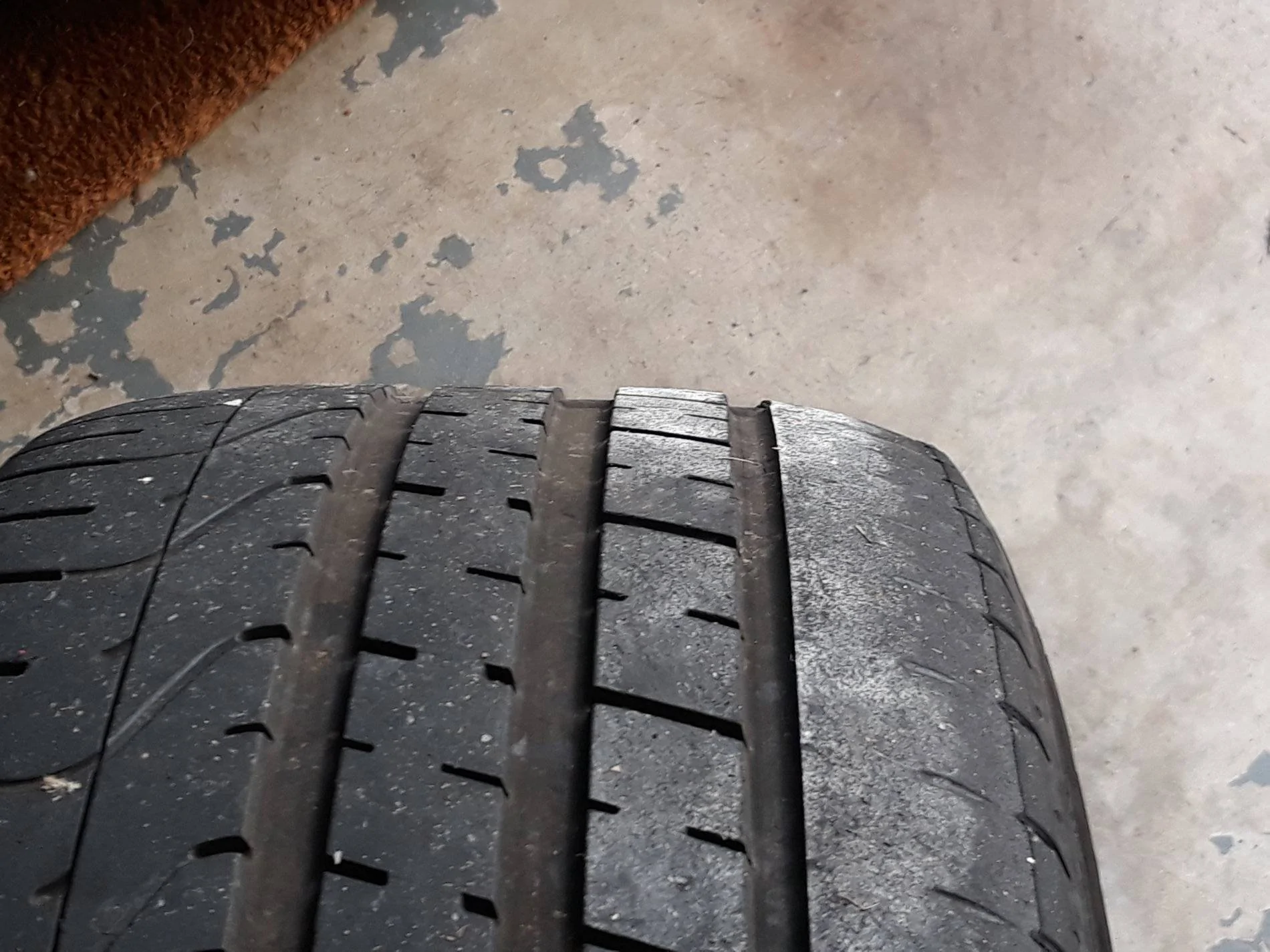

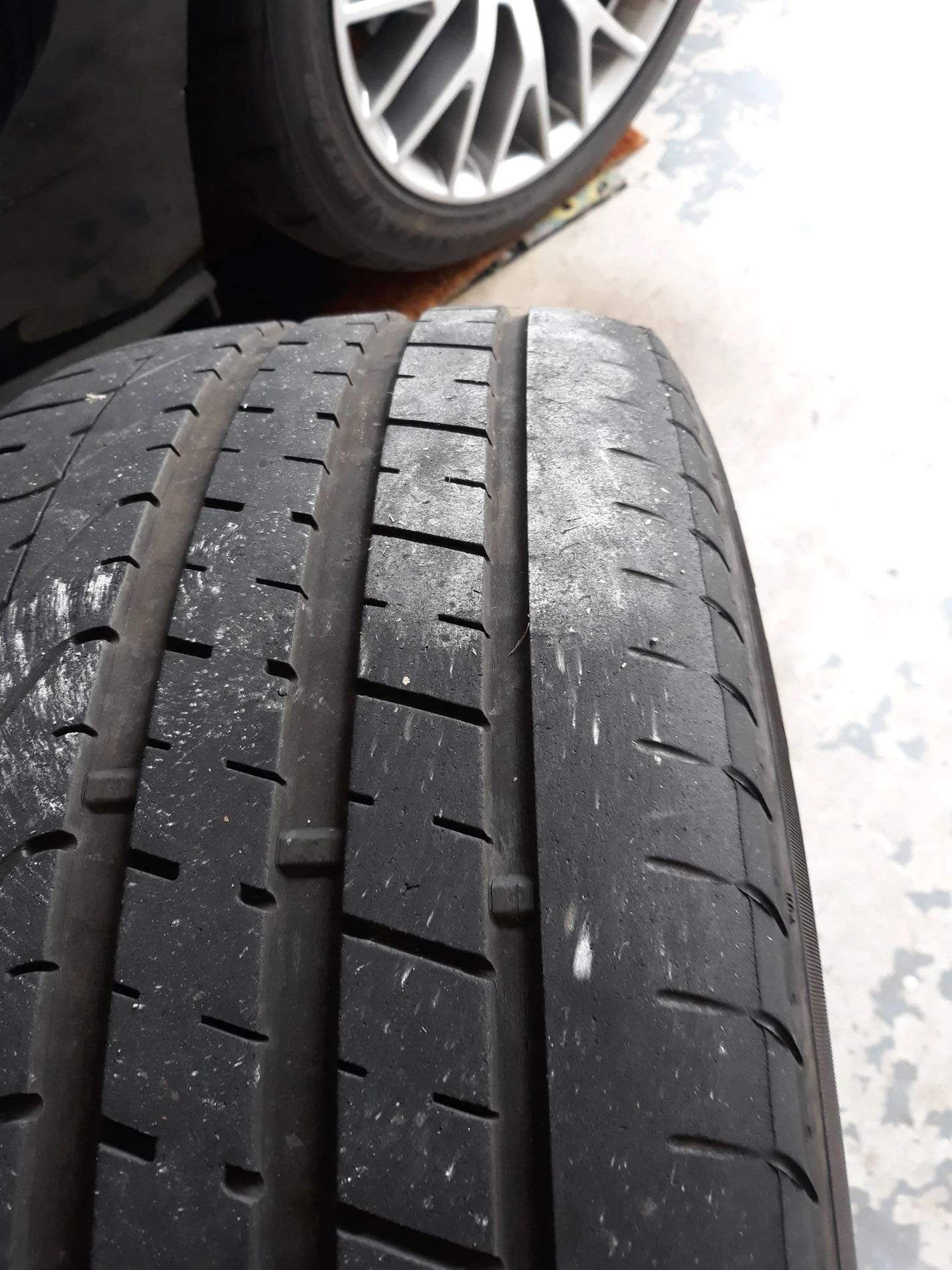

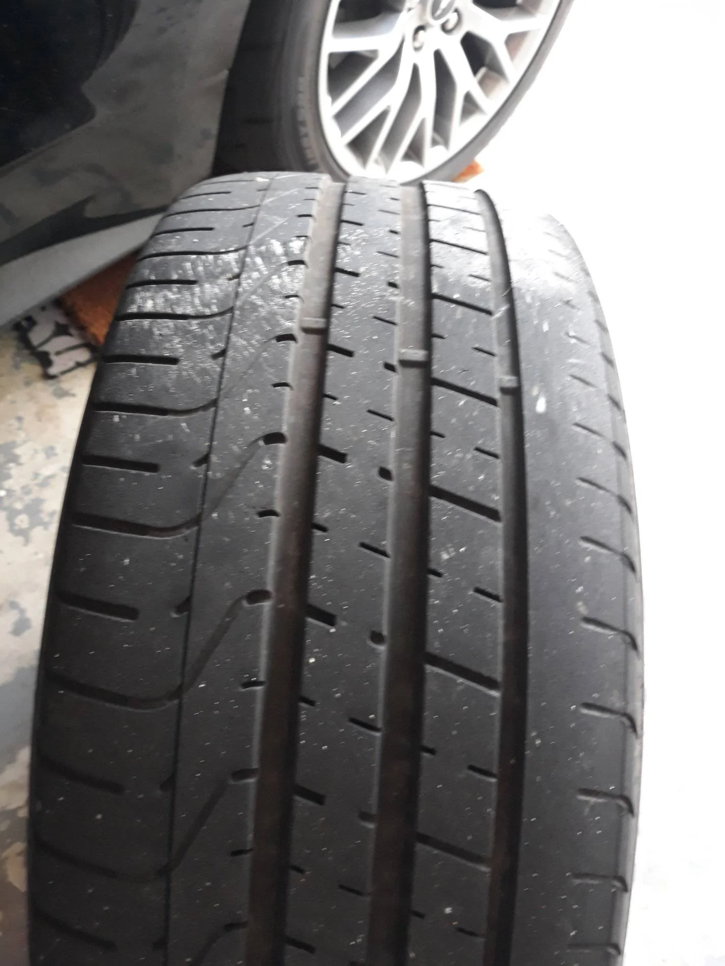

Hey guys just looking for your thoughts on this tire wear. Putting new tires on after the holidays but not sure if this is the continued wear I should expect from this car.
Stock pirellis, 2017 PP with 8k miles.
Left front pretty heavily worn on inner most tread block. Right side has similar but not near as much lost. Only left pictured.
Product of the stock built in camber or is toe to blame?

Those p zeros are the worst tires I have ever used, by a country mile. You may well have an alignment issue, but those tires are junk and they wear exceptionally poorly.

Thats typical for a lot of us. They say its toe that kills tires more than camber, but after personally having a couple of MPSS/MP4S dying early due to this wear pattern and being pretty religious about alignments, I think its camber + a very heavy car.
when you get new tires is always a good time to get your alignment refreshed. Thats my 2c.

I just pulled off my summer tires with about 7k miles on them. My alignment is good, but I have -1.75 camber in front with +.10 degree total toe. Exact same wear pattern. I've run more aggressive alignments on BMWs without this amount of inside wear. I think we just have to accept it until someone identifies the cause and a fix.

I see wear a lot worse than on my previous heavy car... I suspect the toe is dynamically changing A LOT on braking / acceleration and this is killing the inside of the tires.
Its quite possible, there's lots of rubber in there. My last tires died earlier than I anticipated and I did find a bad control arm which was shifting toe under load.

It does. Unfortunately the cure is not F street legal.
