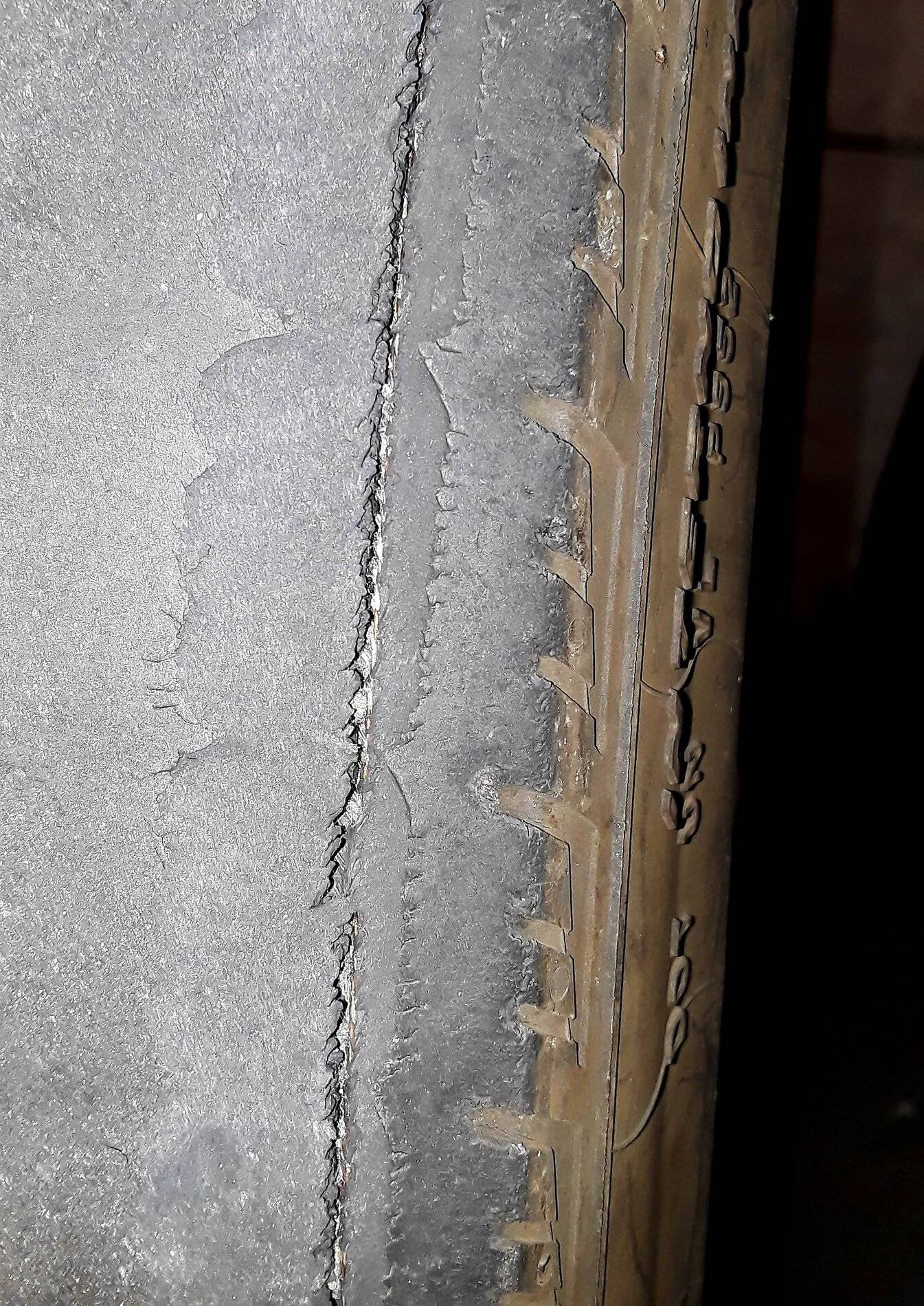

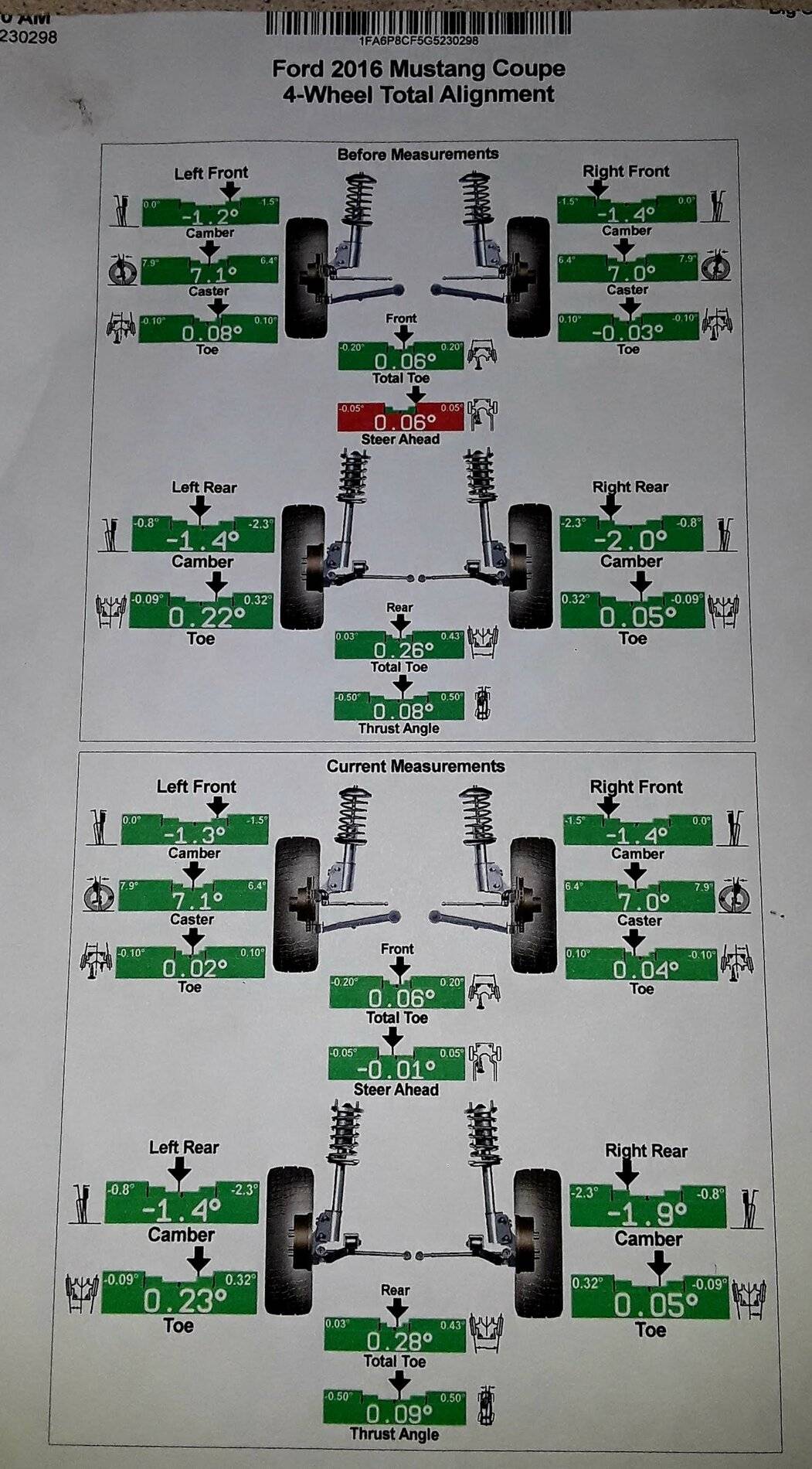

So I went to get aligned and the tech said it was in spec, so I didn't get charged for the service as inspections are 'free'. He apparently did not even look at the front tires which both look like this at 36k miles. Also here is the printout...which doesn't jive with the tech.
