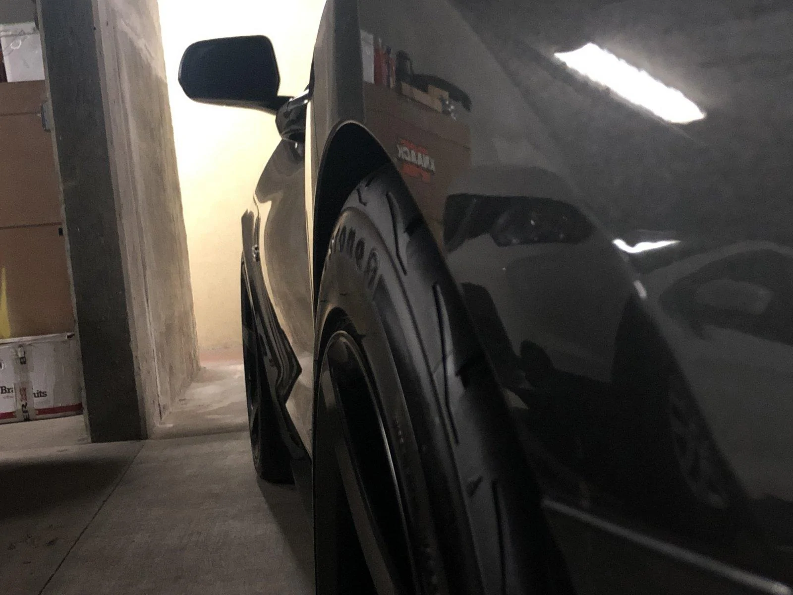

Here's 19x10 ET35 with a 285/35/19. 1" drop, -1.7º camber. Your wheel will stick out 11mm more.
It'll fit, just add camber

That’s going to poke a lot, damn. Well I will order the 285 and see what happens.

Yeah, its going to take right at, or a bit more than 2 degrees of rear camber. The fronts will be a really nice fit tho.
You start losing grip fast past 2 degrees in the rear tho, so dial as little as you can to get it to tuck.
