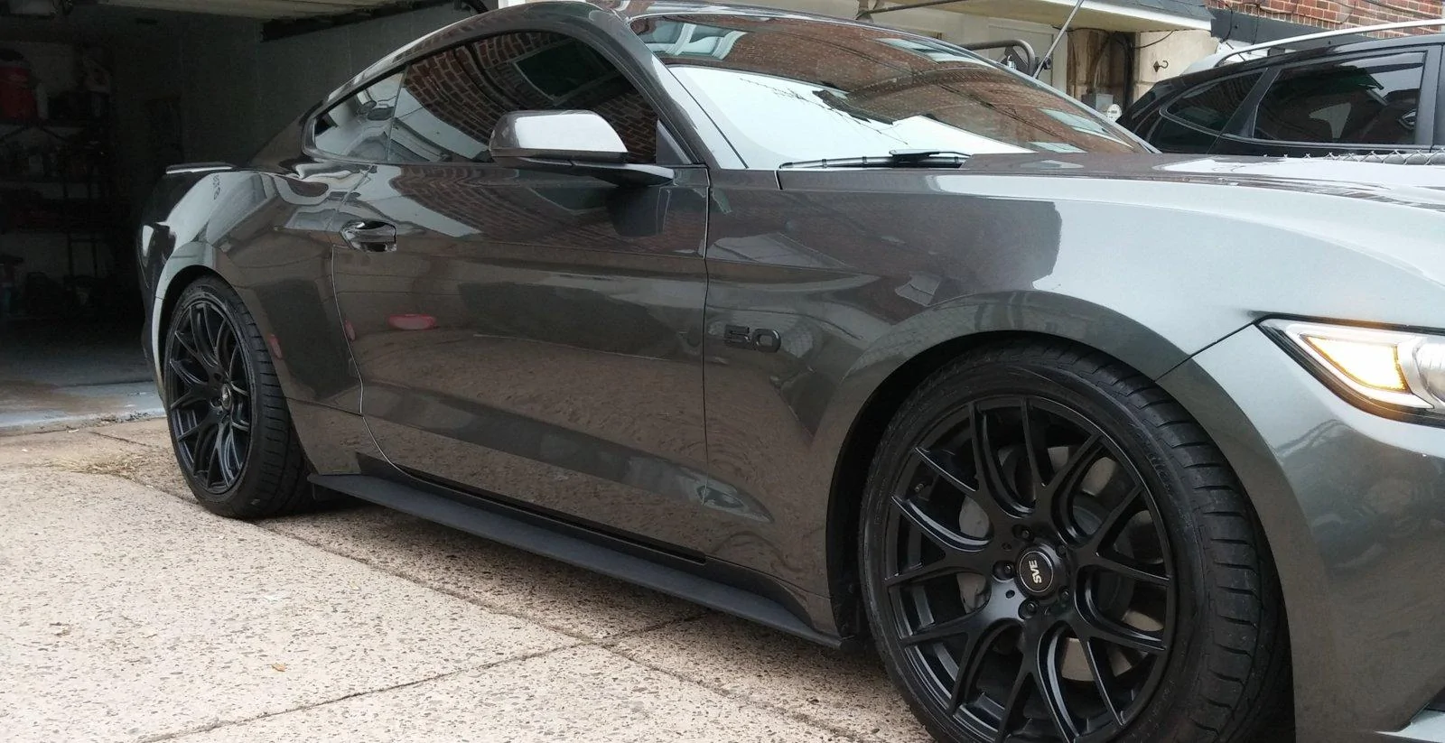

this is a 19x9.5 rim with 35 offset with cjpp springs over inch drop all around with a 275/35 tire all around on my old 16

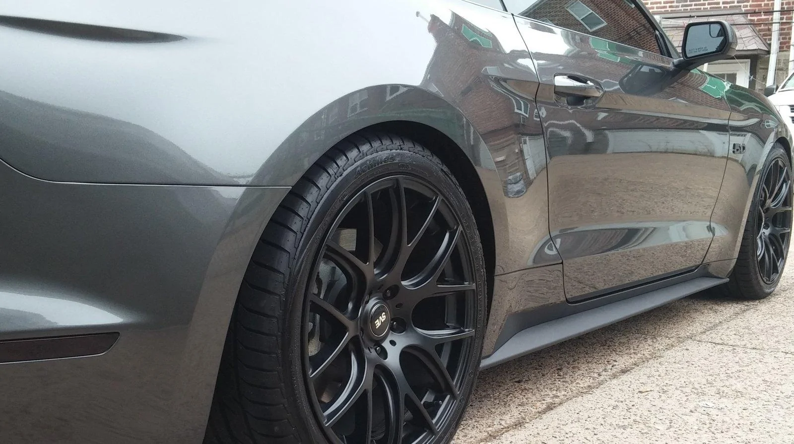

another ... there is plenty of room for a 275/40 tire.. and cj springs are 1.4 front and 1.2 rear drop i think

Thanks, man! The pics are very helpful!
