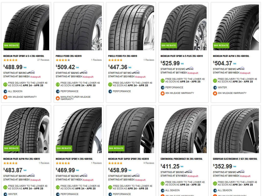

Popular/Recommended tires: Michelin, Lexani, Continental. 😎
You can also see our most popular tires for your Mustang! We also have rebates too! Any questions? Please ask!
Just input your vehicle's specifications on our website!
