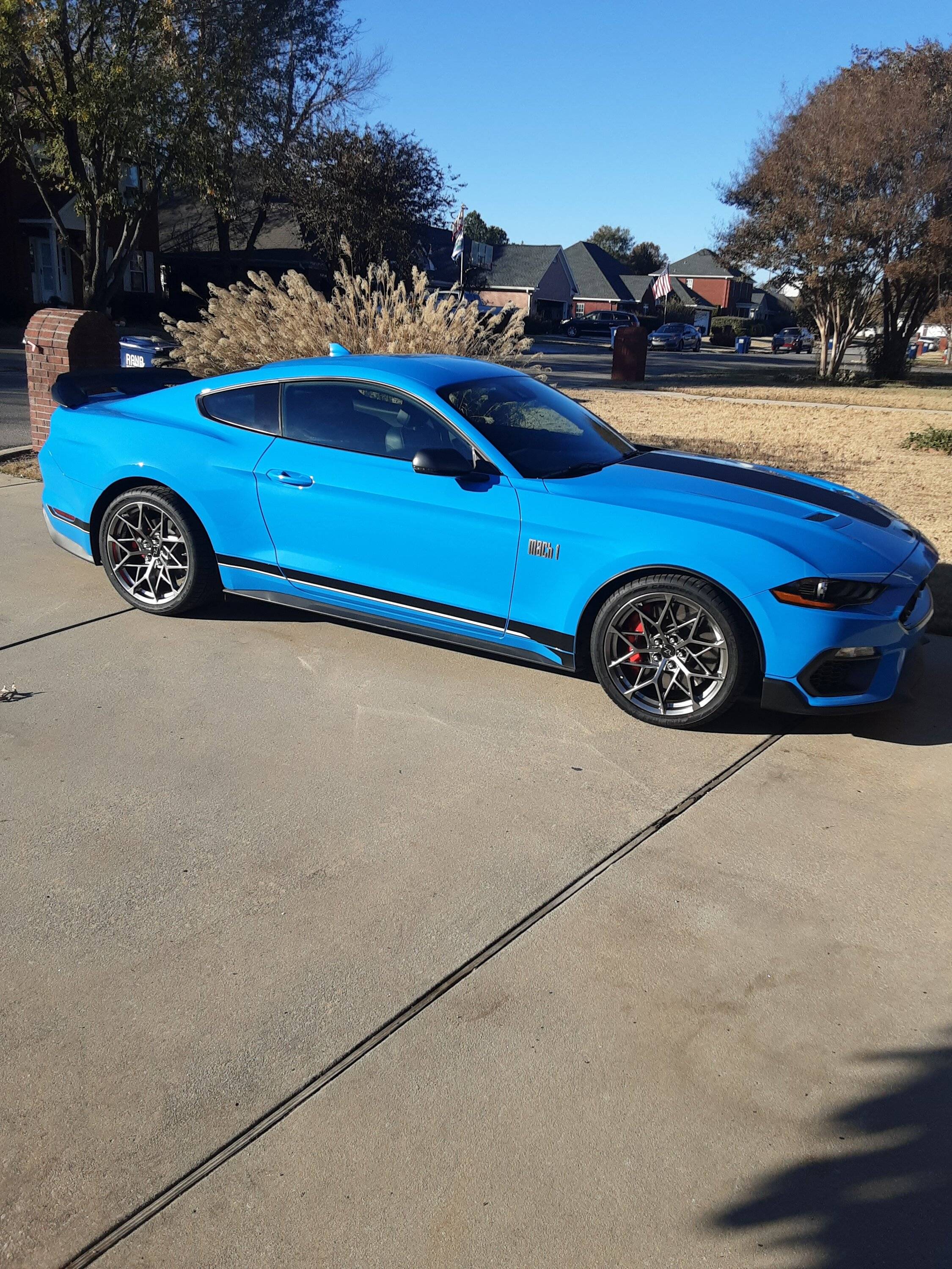

19X10's with 35mm offset squared. 305/30/19's so I can rotate. The OEM wheels are stored in the attic. I also hate staggered set-ups. Dealt with that on my past 2 AMG's.
Seeing these make me really excited to get my wheels back from California. I hope it looks in person how it looks in my head, because man I am gonna be pissed if it doesn't! If it sucks, I'll likely scrap the whole idea and just be simple and get a square setup and roll with it. Looks so good!
