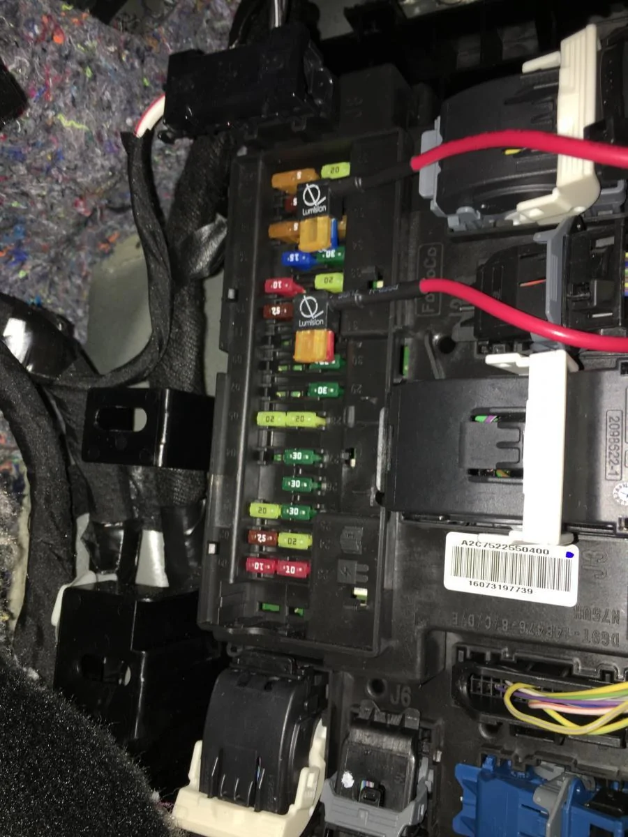

I'm fitting an add-a-fuse on fuse 23 without any issues getting fuse box cover back on. There's 2 nice grounding points to the right of the fuse box under the kick panel. I'm powering my dashcam using the add-a-fuse; not sure if you could or should power both radar and dashcam from the same add-a-fuse.
On my '15 a mirror-tap worked fine, but on my '17 the tolerances on the mirror harness seem to have changed, and the pins don't fit at all. You could use vampire taps on the correct wires, but I just went the add-a-fuse route instead.

I'm also using an add-a-fuse on fuse 23, but for my radar detector.
I was curious if anyone knows of another good fuse I could use for my dash camera. I've gotten out my fuse tester and messed around with which ones were on when the car was on, and also looked at the fuses section of the owner's manual to see what they were used for. Curious if anyone else is using a fuse other than 23 for a dash camera?

If I recall, I used fuse 36 for the dash cam.
I couldn't fit a fuse tap in there. Because the fusebox is kinda recessed, the fusetap's wire didn't clear. I never did try another fuse location or another fusetap, but I ended up just wrapping the wire from the dashcam around one of the legs of the fuse and reinserted. It works.
