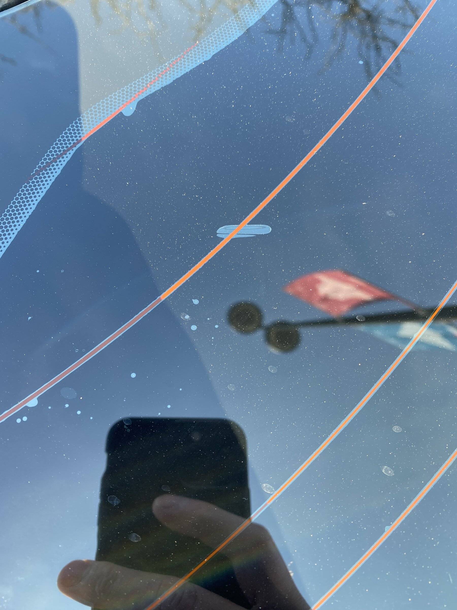

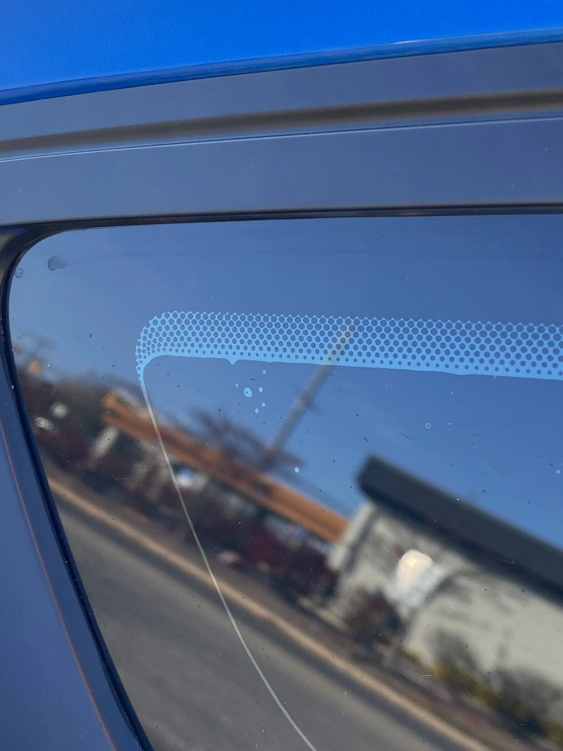

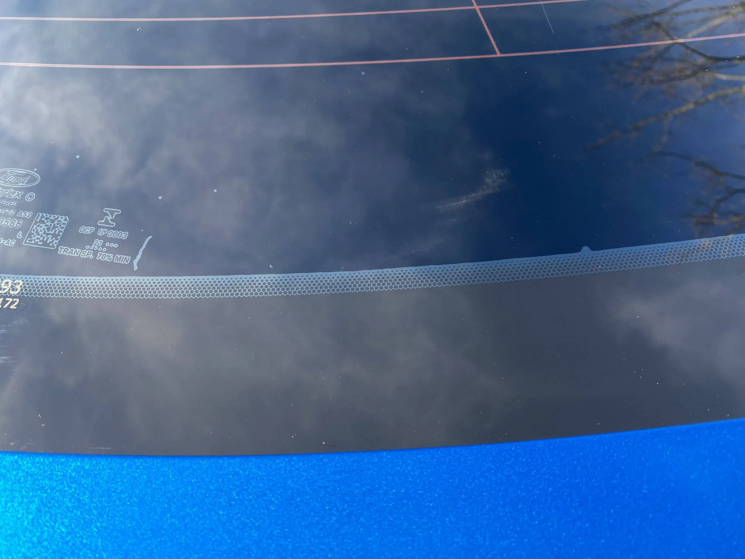

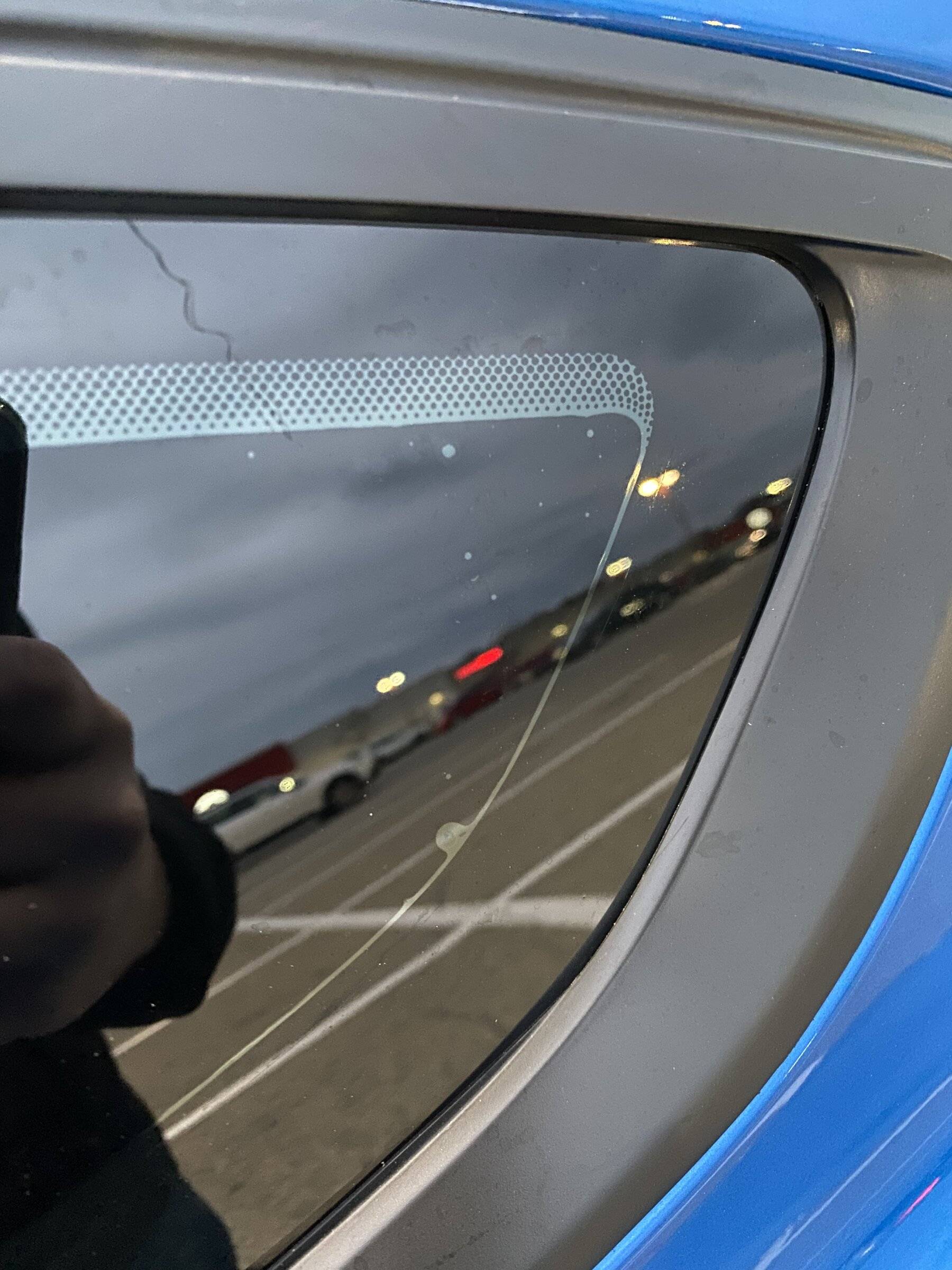

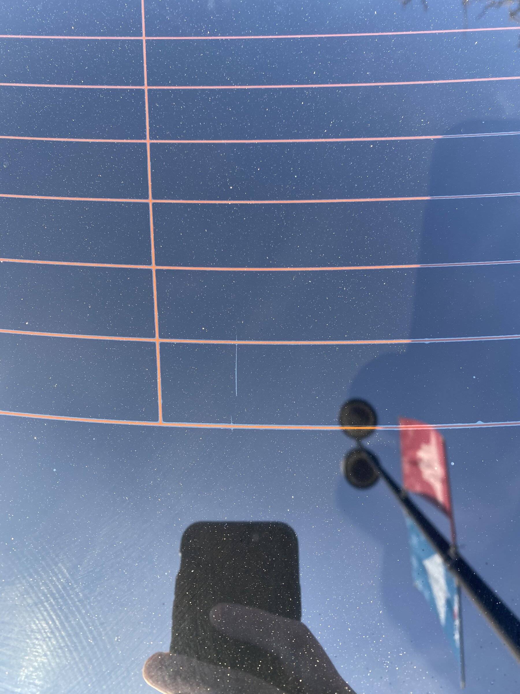

guys, need some help. so i just went to a place and got a tint. guy told me wait 5 days for it to fully cure before i wash windows or anything, so i said okay. it had a ton of bubbles, but they should go away within the 5 days too. seems there’s still a good amount left 3 days in though, and this is supposed to be a pretty good reputable shop. check out my pics and give me your guys thoughts. i already emailed the guy about it and am awaiting his reply. i really wonder if these remaining will go away, or if they’re just from a bad job. my last mustang was perfect. didn’t have a single bubble in the 7 years i had it, and cost significantly less, so i’m a tad annoyed.
Monster oops. Needs to be repaired or replaced.

yeah i’m not touching shit lol i’m going to call. i just called and was put on hold for 20 min so i hung up. google says this is their busiest time right now and they were busy when i was there. just a bit annoyed right now bc their tint reviews say the job was so good blah blah blah i’m just annoyed bc it’s an hour away
So disappointing. Sadly this is what makes us appreciate quality work when it is done right the first time.
