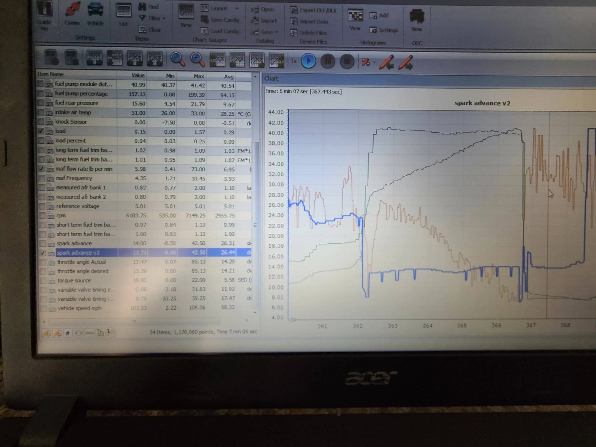

Ive got a 2019 6mt Edelbrock stage one on 91 and 6oz of boostane per tank. I Can anyone familiar with the Edelbrock tune tell me if this looks normal?Throughout the pull it's removing 2 degrees briefly then giving it back even though kr is at zero.

It’s hard to tell from the graph since there’s only one scale. All I can see is that timing peaked at 14 deg which is a little low, but without knowing the rest of the data, can’t say for sure.

Here is a link to the file. I'm not sure what all parameters need to be logged on an FI car either.
