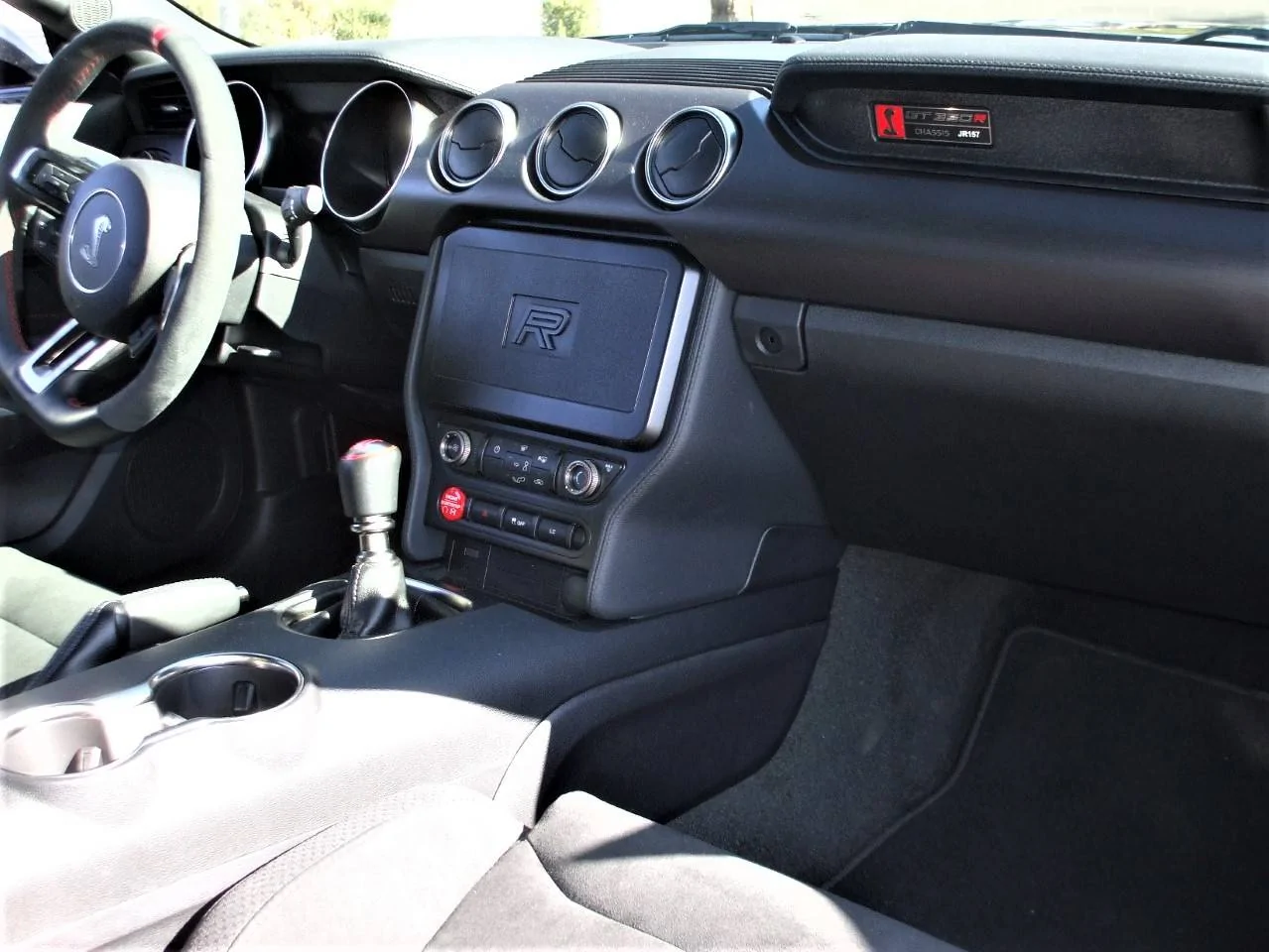

If someone needs to turn up their radio in one of our Voodoo equipped GT350/R's they obviously have a problem. :facepalm:
When you really think about it who actually needs a radio when we have one of the best sounding engines of all time which provides some of the best music to the ear ever!!:clap:
