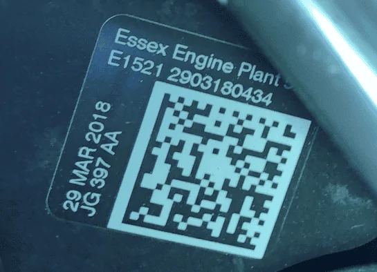

Quick update for those that asked, the build date for my car's engine was 29 March 2018:
