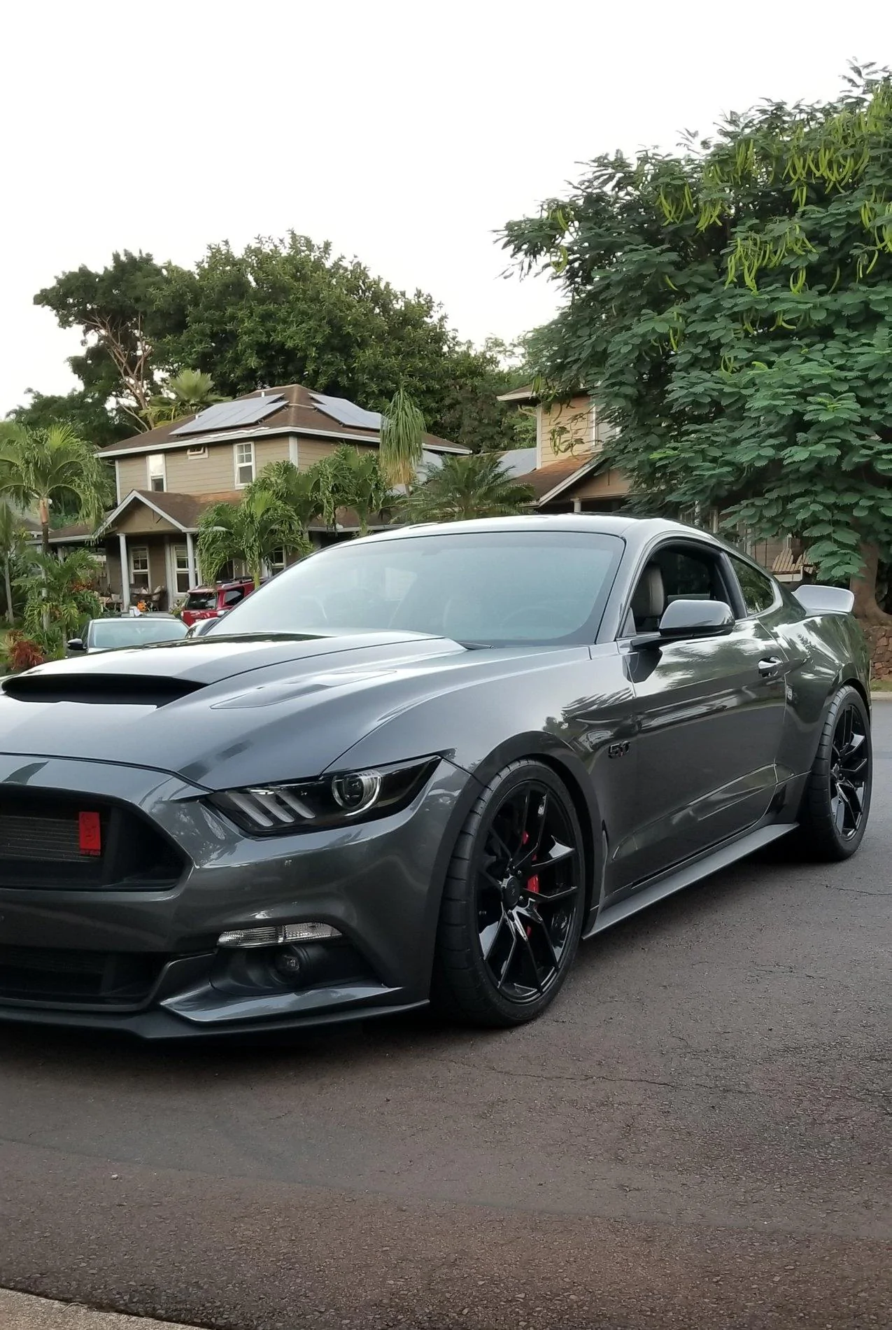

808muscle
Oct 10, 2016
298
120
Lahaina HI
2016 GT Premium Whipple, 2006 GT Blown and cammed
What hood scoop is that?
Just the American Muscle one. Paint is perfect. Only con is it makes the hood heavy otherwise its awesome.....very aggressive looking.
