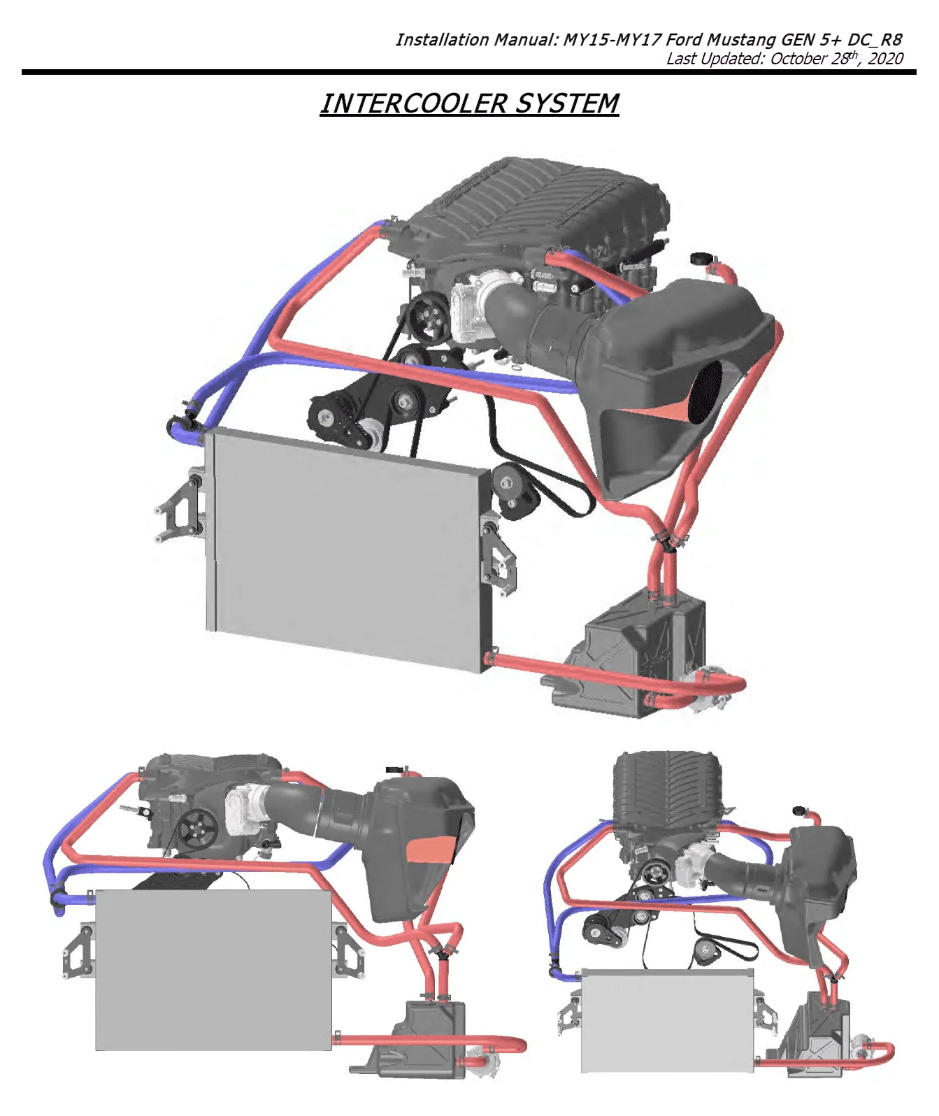

I do have one question to the people with the 2 port version. How do they handle the extra port. Does the hose now come with an additional Y to connect the 2 ports?
Here is the routing picture from my install manual.

Oh. So my speculation was wrong. They added an additional return, interesting.

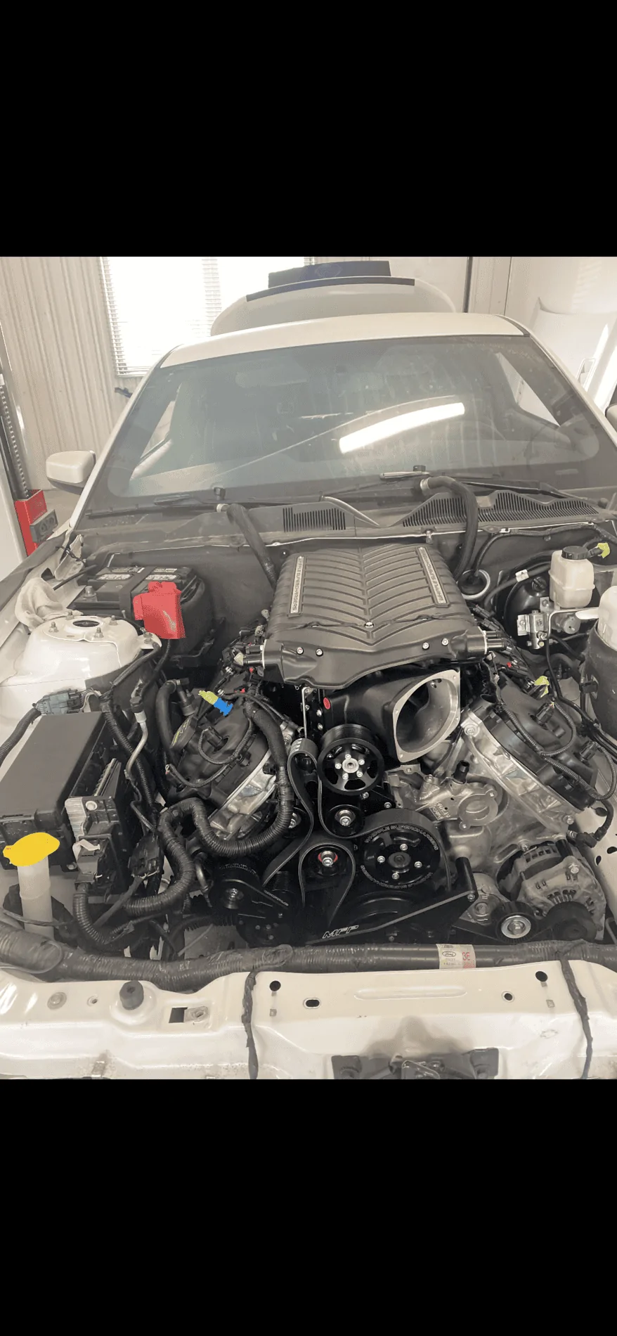

Heres the one I got
I wonder if there is actually no difference in performance, doesnt make sense to have 2 types though.

Is it just an excess port that gets fed back into the supply line? It's whatever red line comes out and goes to a t-connect on the supply line just before the fill reservoir. I'm not mechanically knowledgeable of any of this.
