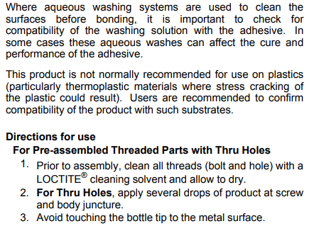

The second "mess" deals with a soft plug leak issue.
All I can say Tob is, UFB.
Yeah at least the first TSB is a fix, that second one seems like a band aid at best, and very reliant on the tech doing it 100% correctly / conscientiously AND the product being 100% reliable on a fix of that nature.
I'm not sure how all that can be guaranteed on a difficult to access area, on a car that's had some road time, on a core plug that's got coolant on the back of it (and potentially weeping - based on the nature of the TSB ?) ...
Based on the user instructions for 290, there are some definite challenges with a repair of this nature :
