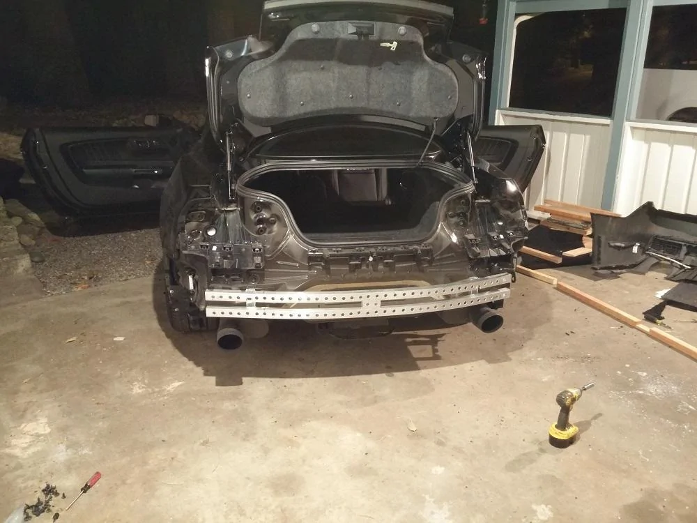

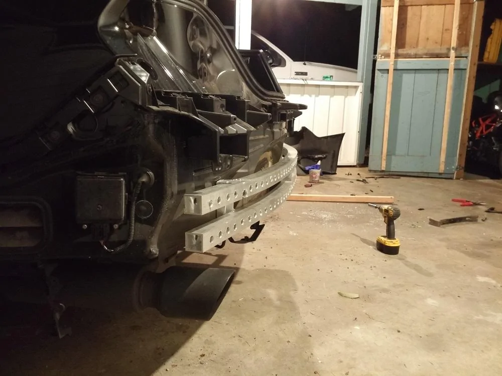

Wow sorry guys, not sure if anyone was waiting but I've been slacking I did do the rear crash bar but totally spaced to post about it. The rear OEM steel crash bar is 16.2lbs. Aluminum one is 8.4lbs. I got lazy and didn't drill out the holes to 1". That and my 1" bit got burnt up from that many holes:( so it COULD be lighter but oh well. 7lbs is still 7 lbs. Plus off the rear isn't that big of deal... If I get productive another day I "might" pull the bumper back off and drill some more

Trent, thanks for sharing! :thumbsup:

What's the black box inside the bumper?
I honestly don't know, I didn't see it until you brought it up! Now I want to go take my bumper back off haha. If i had to guess it might be a PCB for the tail lights? transmitter for our key fobs? Was more interested in the flaps right in front of it. I didn't know they had baffles into the trunk like that.

Do you have rear sensors? Maybe it's a control module for the camera and the second hole is for rear sensors?
