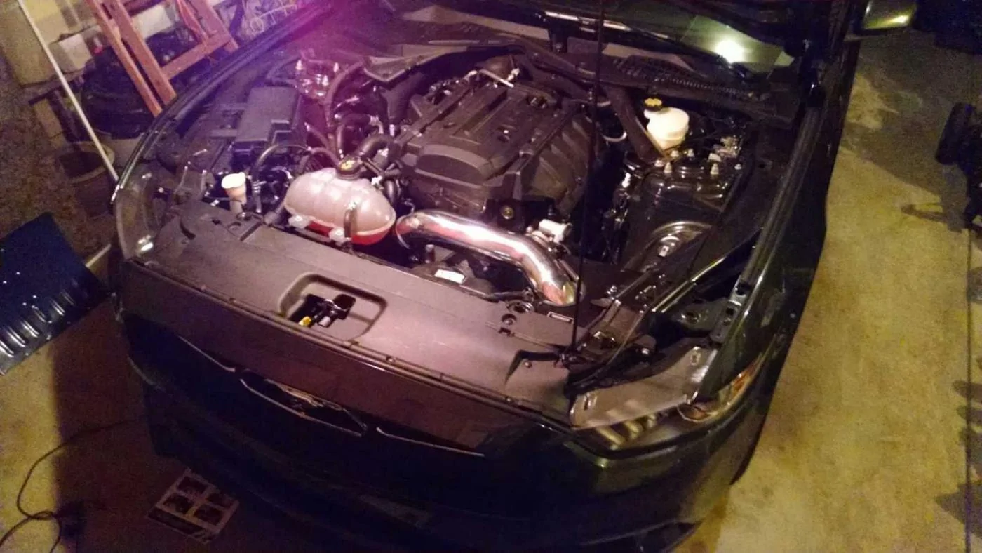

Got my map intake installed yesterday, only got to rev it up at the house yesterday, got to actually drive with it today.
Ambient temp was 70F the entire drive.
While driving between 55 - 65 mph the iat were bouncing between 70 and 71.
At idle temp would rise to about 78 to 80 but quickly drop back to 70 after taking off again.
Car feels more lively now over the stock one. Not saying I immediately felt huge gains or anything, it just felt more responsive.
Finally we get to the sound... It's freakin loud lol. I have it recirculating instead of vent to atmosphere and it's plenty loud for me. Also put my magnaflow Competition catbacks on at the same time so the entire sound of the car changed all at once so that might attribute to the perceived loudness a bit.
Will post a video when I get a chance, only took a quick 10 minute drive this morning.
