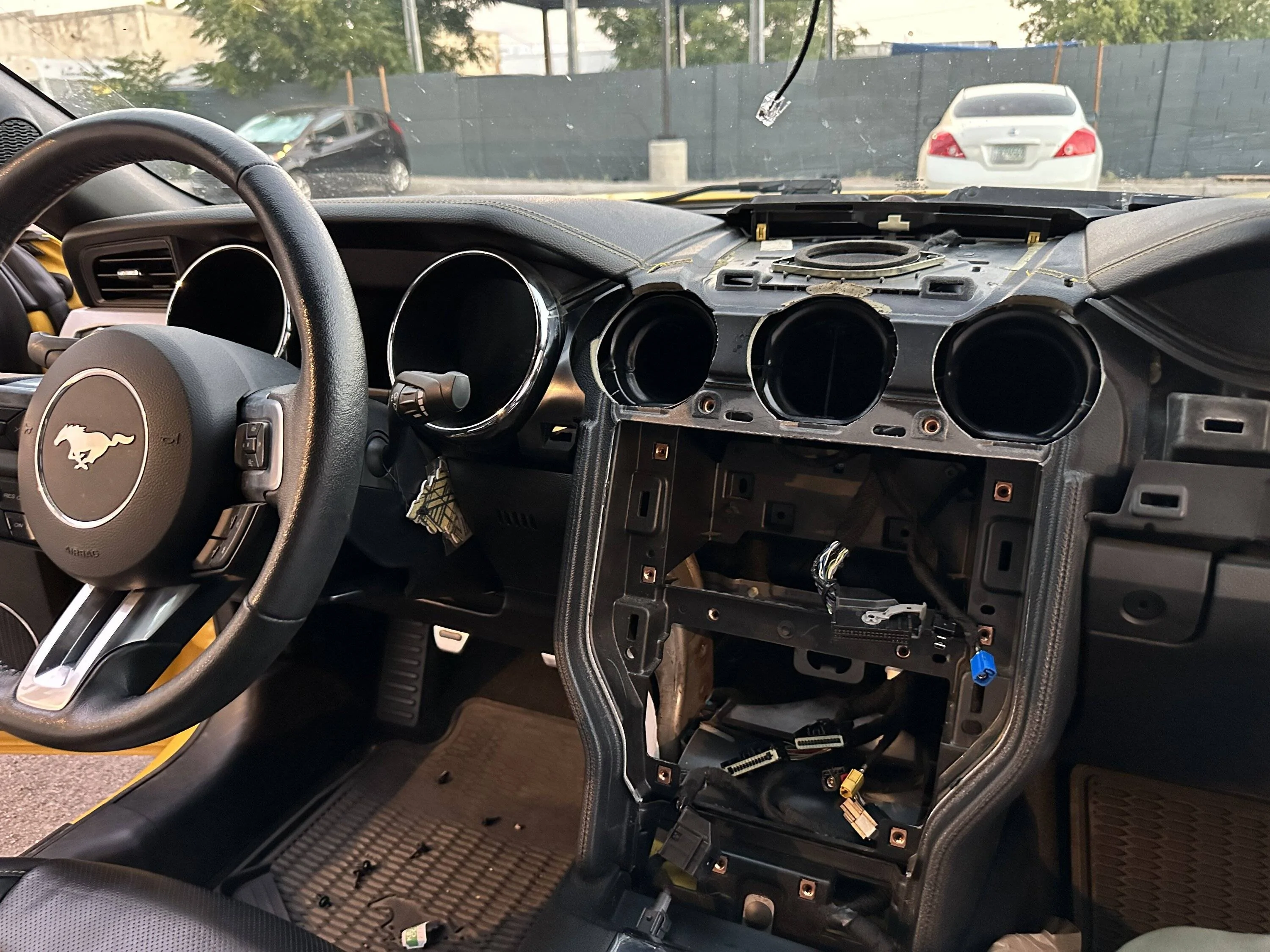

Decided to remove the screen and radio and spray disinfectant through the vents and cabin filter cavity.
So far no smell, but I’ll know tomorrow or during the weekend. /knocks on wood
worst case scenario I’ll buy a new evaporator and take a day off to change it.
thanks guys.
