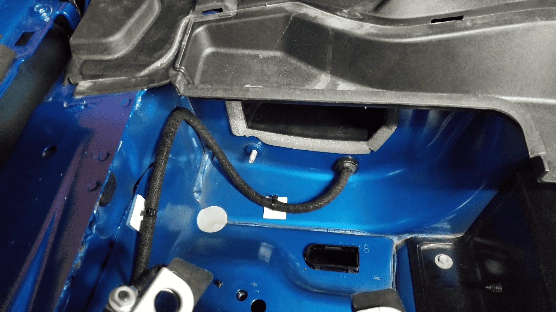

Am I wrong by thinking the outside air inlet is behind the battery box?
I think that is correct. I just apply through the screens that are on top of the battery cover so I would assume the inlet would be behind there somewhere.

If you really want to get directly into the system, the air intake is behind the battery box. But I think you might have trouble running the fan in this state. Better off working around it. With the fan on max, you should be able to get a good dose of aerosol spray into the air intake. Spray into the cavity just to the right of the battery box. There's a fairly large opening there.
